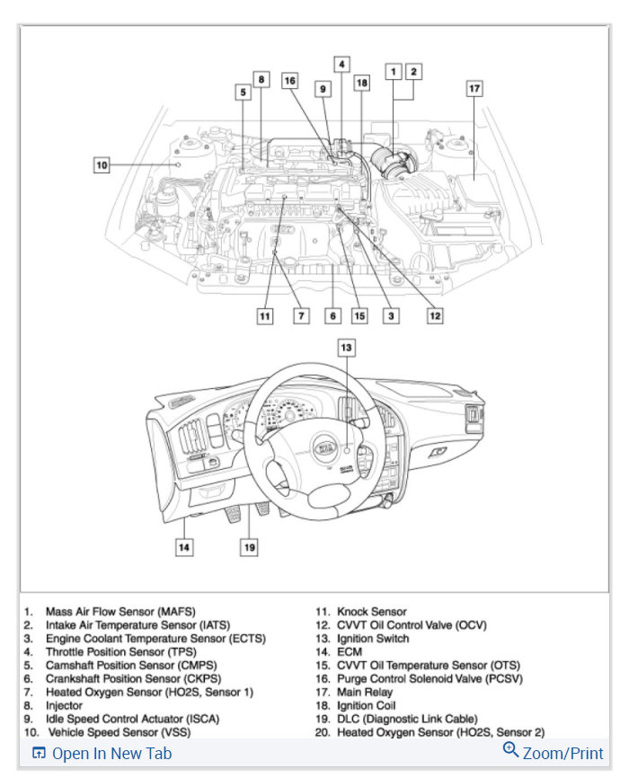

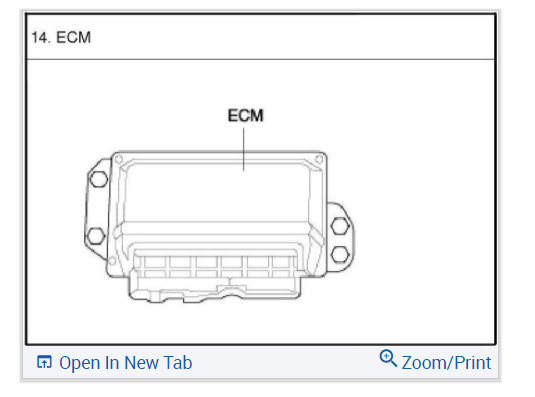

It sounds like you have a shorted injector or oxygen sensor. Please disconnect the injectors and oxygen sensors and replace the fuse to see if it blows if it still blows the ECU could be bad here is the location and how to replace it.
ECM PROBLEM INSPECTION PROCEDURE
1. TEST ECM GROUND CIRCUIT: Measure resistance between ECM and chassis ground using the backside of ECM harness connector as ECM side check point. If the problem is found, repair it.
Specification (Resistance): 1Ohms or less
2. TEST ECM CONNECTOR: Disconnect the ECM connector and visually check the ground terminals on ECM side and harness side for bent pins or poor contact contact pressure. If the problem is found, repair it.
3. If problem is not found in Step 1 and 2, the ECM could be faulty. If so, replace the ECM with a new one, and then check the vehicle again. If the vehicle operates normally then the problem was likely with the ECM.
4. RE-TEST THE ORIGINAL ECM : Install the original ECM (may be broken) into a known-good vehicle and check the vehicle. If the problem occurs again, replace the original ECM with a new one. If problem does not occur, this is intermittent problem .
Check out the diagrams (Below). Please let us know what you find.

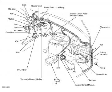

Does this car have a separate transmission computer control unit or is it incorporated in with the main computer for the engine ? Also where is it ?
Oct 3, 2020 at 1:20 PM (Merged)
BMRFIXIT
  • 19,053 POSTS
TWO UNITS
tranny control module is located on the left by the fuse box
engine control module is located behind lower center of dash mounted on the floor

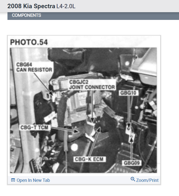

I need to replace the computer, the main 1, the ECU. Where is it located ? Other than disconnecting the battery, is there any special protocol that needs to be followed?
DAVE H
  • 13,384 POSTS
Engine Control Module....Behind lower center of dash, mounted to floor. See Fig. 2 .
https://images.2carpros.com/forum/automotive_pictures/266999_ecm_2.jpg
Removal & Installation Disconnect negative battery cable. On all models, disconnect all ECM harness connectors. Locate ECM in vehicle.. Remove bolts/nuts holding ECM brackets and remove ECM from vehicle. To install, reverse removal procedure.
