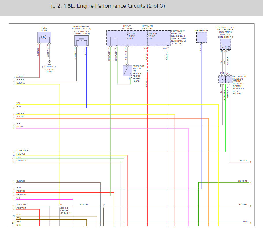

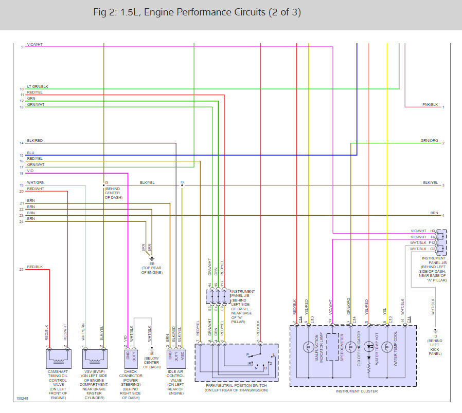

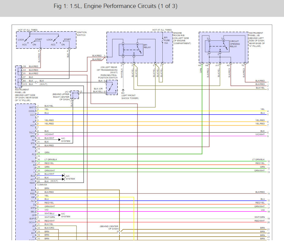

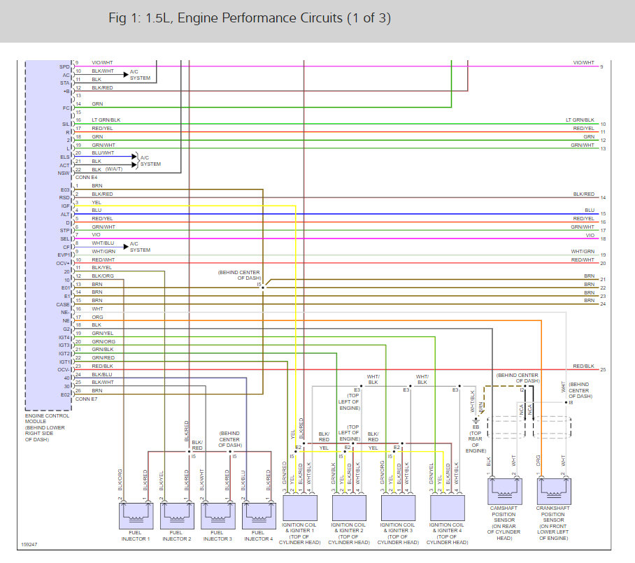

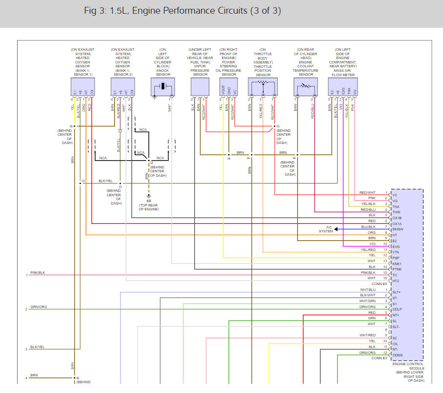

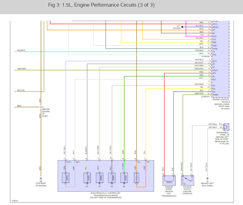

I need a wiring diagram for the ECU please.
Dec 20, 2018 at 9:46 PM
Experienced Mechanic
55,732 POSTS
Here are the engine and ECU wiring diagrams so you can see how the system works with a guide to help to test the wiring. These will be similar to your car.
