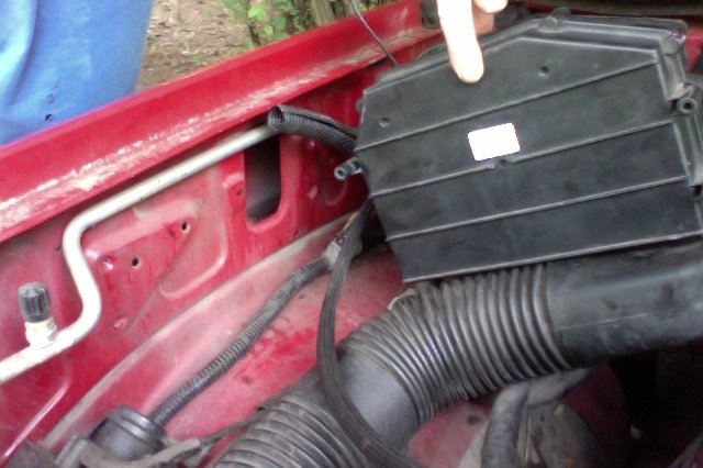

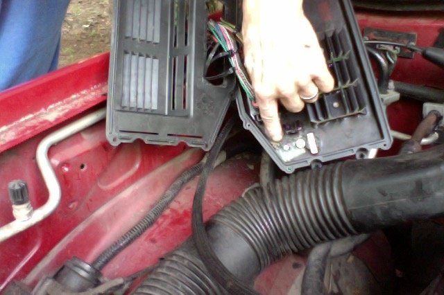

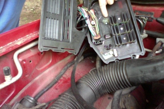

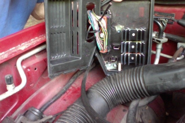

Roy, I appreciate your reply. This site is way better than any I have posted my issue with this truck and get any kind of reply, short of smart aleck replies. I make one comment on my experience with this truck about what transmission came factory in it/the re-manufactured I installed 46re and works. I do not want to argue on line. pfft! that is stupid. They are not here to see with their own eyes, so pretty much accept that what I say is my experience and it works. Neither here nor there. Pictures are below. Two shows the non factory silicone pointed out and better angle of same. The fourth is where I would need to cut a hole with a hole saw to get at whatever that bolt for the connector screws into. Your advice is greatly appreciated and I thank you in advance. If anyone else has advice/opinion as to how the heck I can get this bolt out of the connector so I do not have to snip/splice all those sixty plus wires, feel free to add your two cents worth. Heck add your $20.00 worth. LOL

The bolt is turning but not unscrewing correct? There are a couple options. The first is to lock onto it with a pair of vice grips and pull up hard while you try to unscrew it. The threads go into a simple flat nut and it sounds like the threads may be damaged on the bolt. Pulling it "out" while turning may let it back out. A variation on that would be to use something like a trim tool or screwdriver under the bolt head while rotating it with a socket in the attempt to do the same thing.
If touching the connector seems to complete the circuit the issue may be just a couple of pins in the connector. Many times those can be removed out of the connector shell and either reformed or replaced.
There is also the "nuclear option" If you cannot get the bolt out you could get a used PCM and cut through the housing to get to the "back" of the bolt to get it out. It will damage the unit you have but it sounds like the one you have already has issues.

Steve, it does have issues. Like someone did a shade tree ECM re-manufacture on it and did not want to waste precious time getting the correct gel to bandaid it where they cut into it to solder the bad soldering Chrysler did when ECM was made. Seems poor soldering on about every driver or chip is now the bane of our existence if we own one. Probably have line on one. Last time stranded me had to walk past body shop. Saw one that been sawed in half. It was Sunday and no one around to ask.
