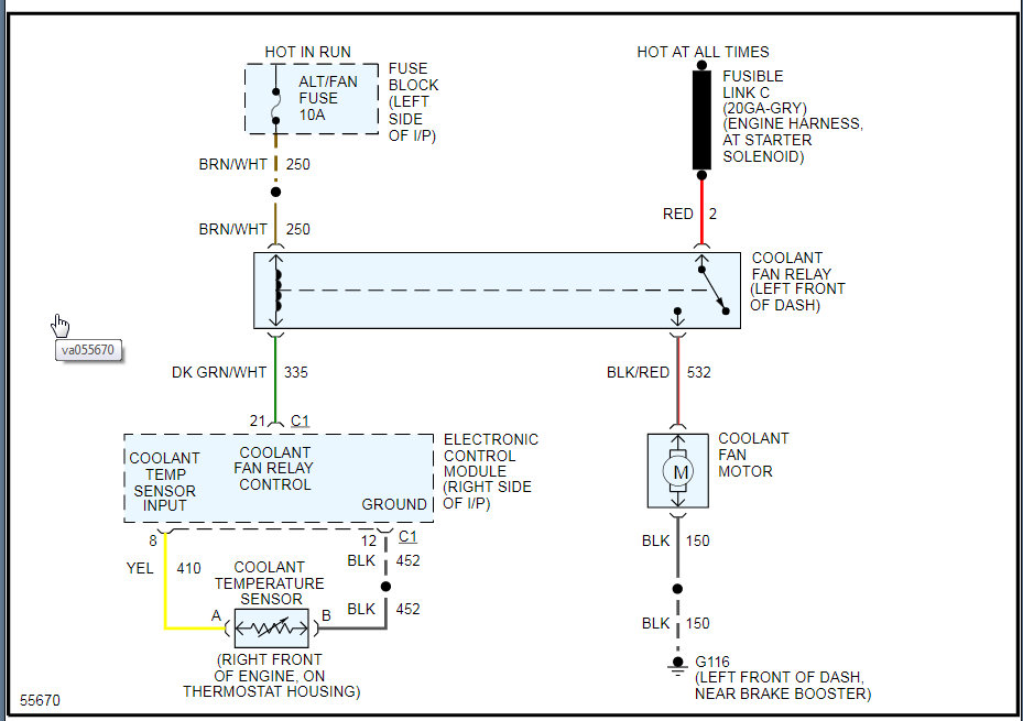

The car listed above is a GT, with a 5-speed manual. On startup, coolant temperature reading on OBD1 scan tool starts near ambient temperature, rises normally until it reaches 122 or 123 degrees F, then immediately spikes to 258 degrees. The sensor was tested and resistance readings are nearly identical to factory service manual chart at various temperatures - steady temperature increase mirrored by steadily declining resistance. Once the temperature spikes, the cooling fan comes on (ECM response to high reading) and the temperature continues to rise (according to the scan tool) at a normal rate, topping out at 304 degrees F after about 20 minutes of run time. Since the ECM does not display readings between 123 and 258, is this indicative of a failing ECM?

I think you hit it on the head. If the sensor is ok then that ECM most likely has a circuit board issue that fails when it reaches this temperature. Most likely there is a solder issue that is causing the circuit to open or have high resistance at this temperature.
This is a very simple circuit that basically the ECM sends voltage through the sensor and as the temperature increases, it changes the resistance in the circuit and the ECM watches this voltage change which it interprets to a temperature.

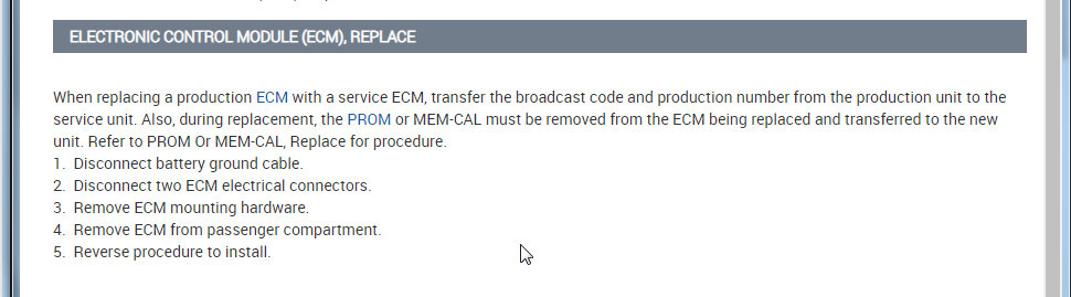

I attached the wiring diagram below but based on this info, I would replace the ECM if I were you. I attached the process for the manual as well.

Hi KASEKENNY1. Thanks so much for your advice. Before I bite the bullet for a replacement ECM, I decided to do some more diagnostic work today. I used a potentiometer in place of the CTS, so I could "manually" send resistance readings to the ECM. If I was real careful (the potentiometer is very sensitive), I could actually dial in resistance readings that translated to temperatures the ECM wasn't normally reading. I found that a resistance that translates to about 229 degrees turned on the cooling fan, and if I dialed it back to 220 degrees, the fan turned off. I also checked signal voltage to the CTS and got a reading of 4.85v, which seems to me to be about where it should be. My next step is to carefully inspect connections/condition of the ECM itself for any obvious compromises. I'll keep you posted...
