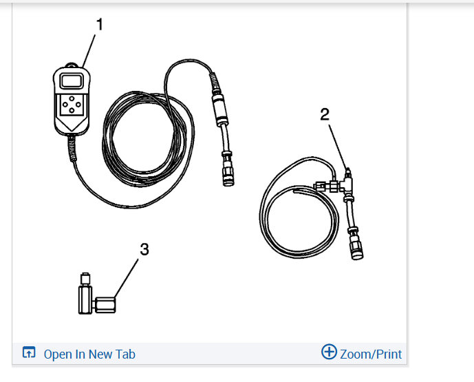

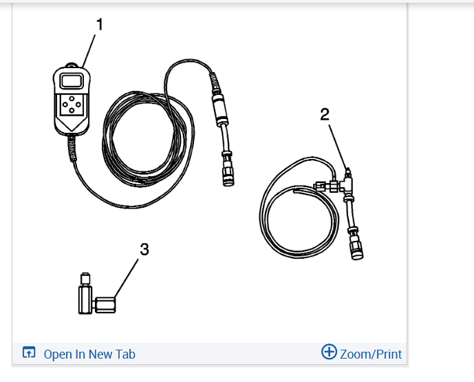

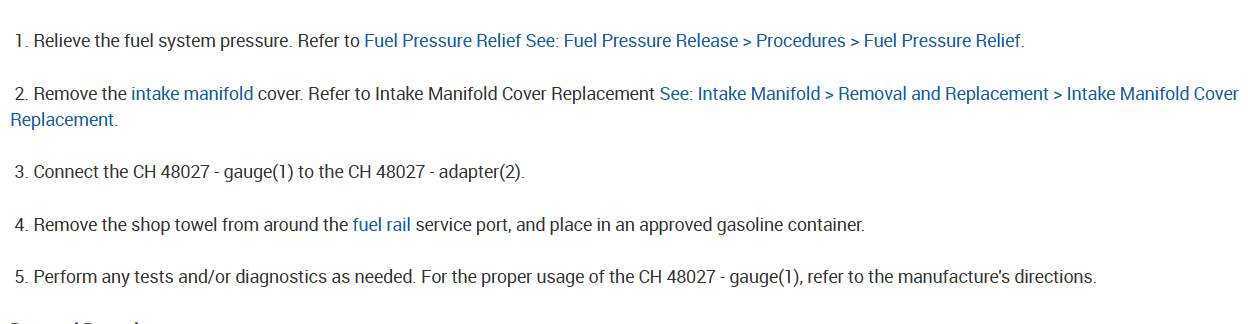

So this can be caused by a weak primary fuel pump which makes sense since the car is hard starting at times.
P0178 - Fuel Composition Sensor Circuit Low Input

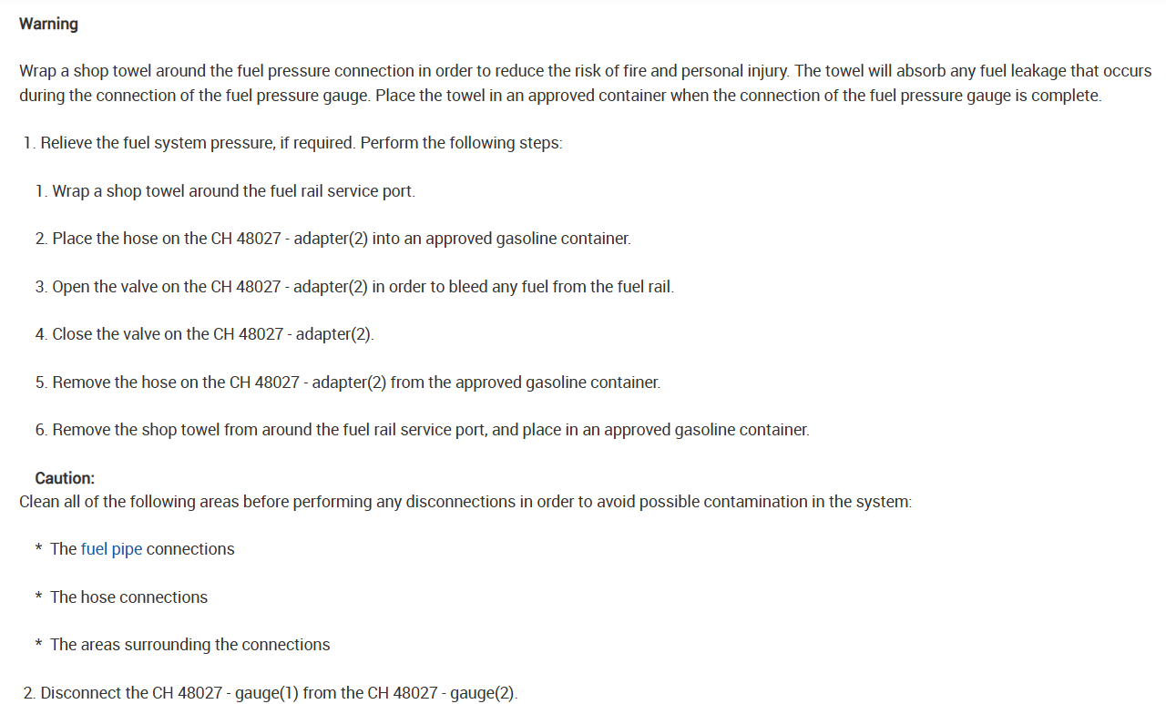

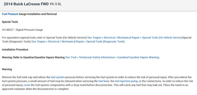

The circuit is low due to the low pressure. Here is how to check the primary fuel pressure to help confirm the issue. Verify the fuel pressure is between 345-690 kPa (50-100 psi) with the fuel pump running.

Update: We checked the primary fuel pressure from the fuel pump to confirm the issue, and this confirmed what were you were saying. The pressure readings were low with the fuel pump running. I ordered the new fuel pump and having it replaced this week. Can you provide any information on the best steps for replacing the pump?

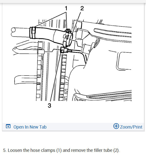

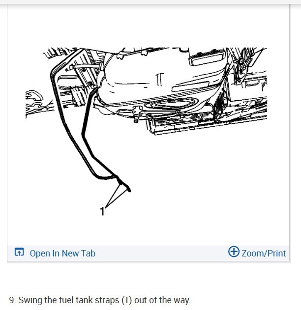

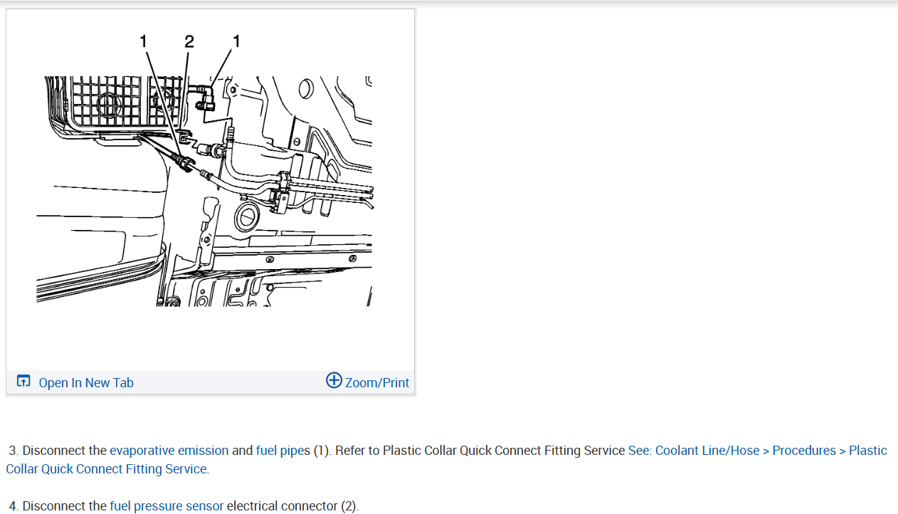

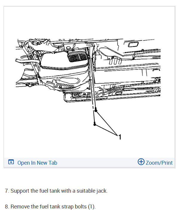

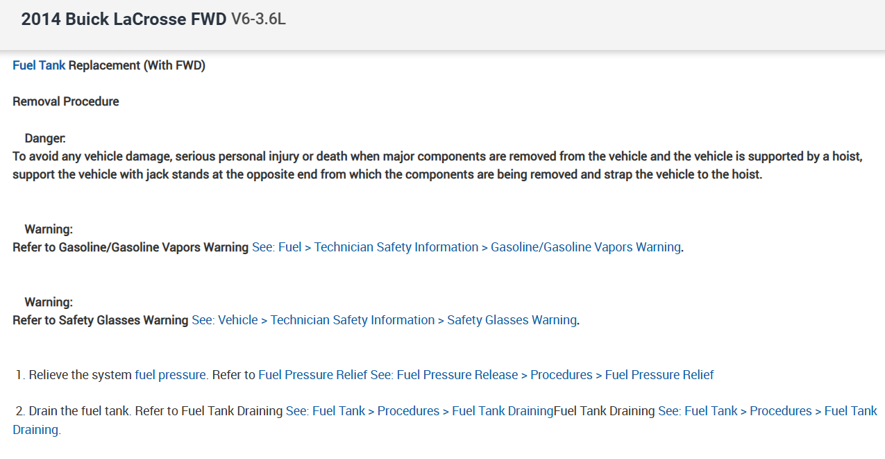

  • 55,214 POSTS

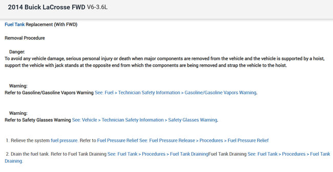

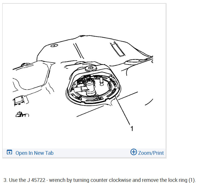

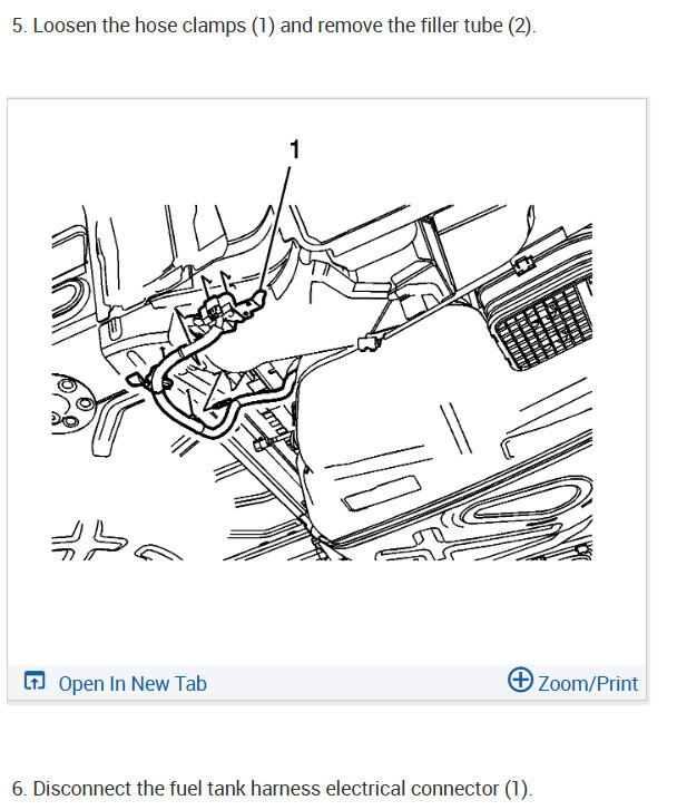

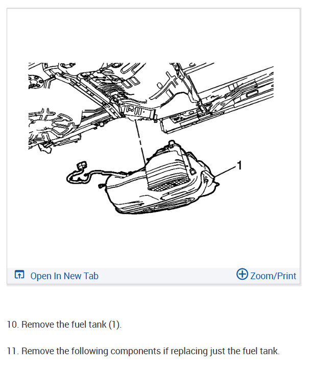

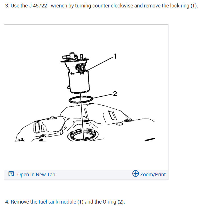

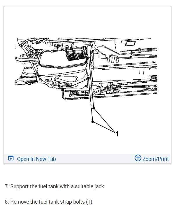

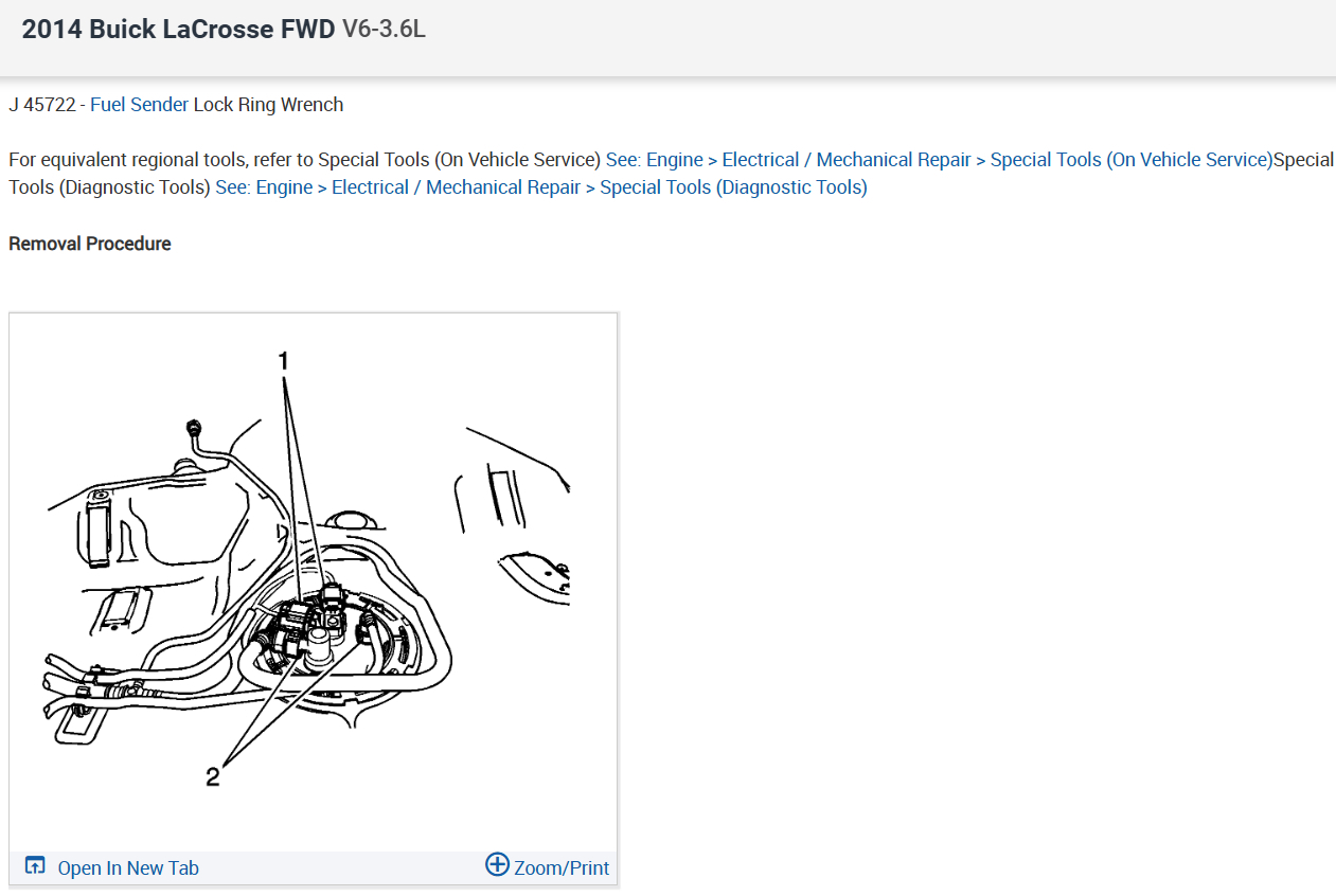

Nice work! here is the instructions for dropping the fuel tank and replacing the primary fuel pump. You will need to drain the fuel which this video will help you with, do not drop the tank with fuel in it because it can be very heavy. Be sure to clear the codes once completed. Check out the images (below). Please let us know what happens.
Dec 27, 2024 at 3:12 AM

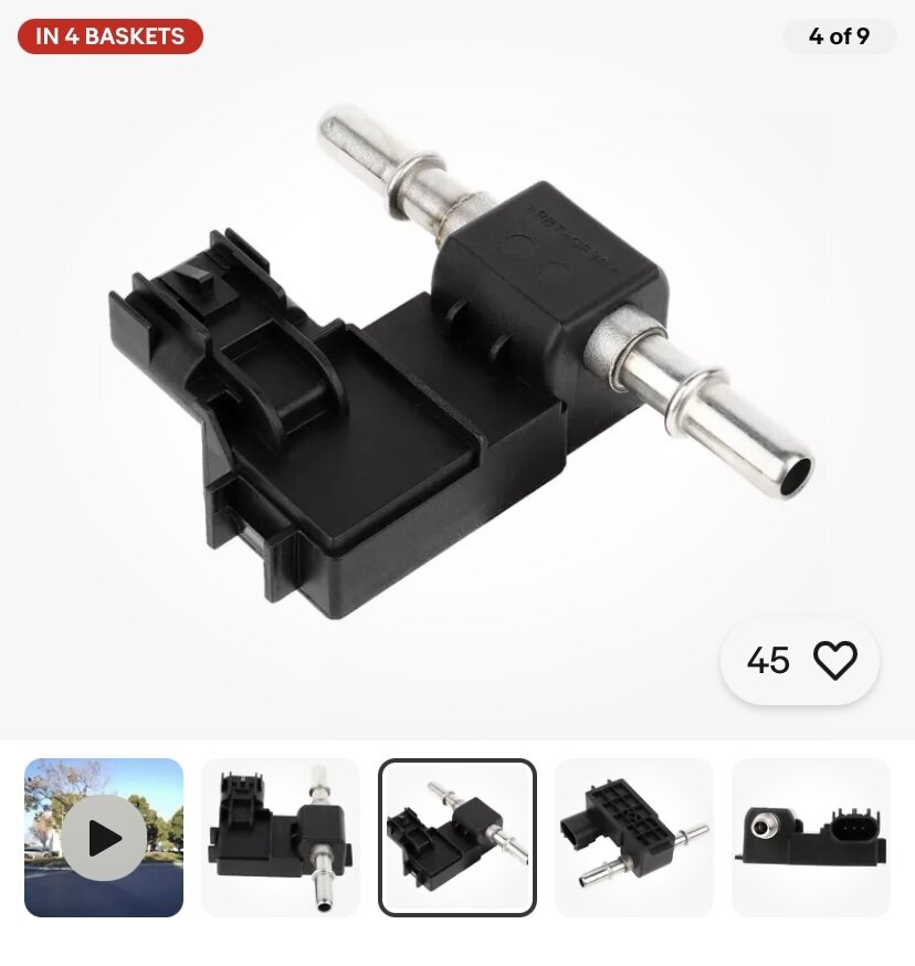

TDCHRYSLER
  • 30 POSTS
The fuel pump was replaced and codes were cleared once completed, but code P0178 still came back. Looks like I'm going to have to replace the fuel composition sensor. Also, the purge valve had to be replaced. This was causing the drag/rough start.
Jan 8, 2025 at 3:17 AM
  • 55,214 POSTS

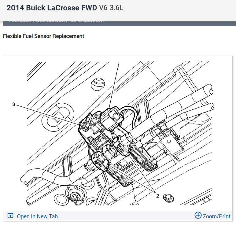

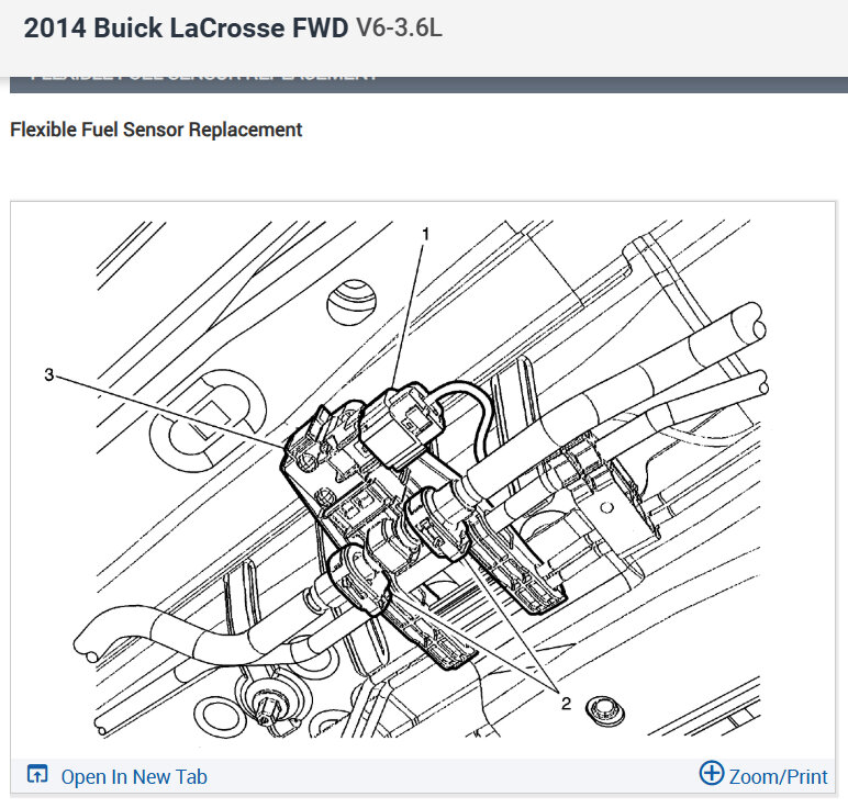

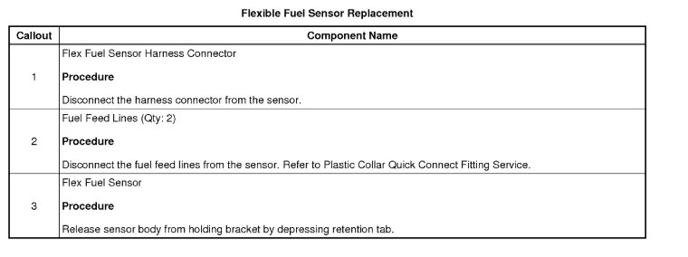

Good job, here is the location and how to change out the fuel flex sensor which is the same thing. Check out the images (below). Please let us know what happens.
Jan 9, 2025 at 2:36 AM
TDCHRYSLER
  • 30 POSTS

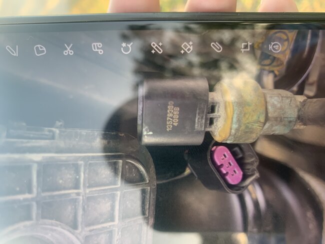

When changing the fuel flex sensor, I’m not seeing where the sensor is, I’m seeing something different. The images show the one I bought (1st image) and what I’m seeing (2nd image). Is it in a different location on my model? Because what I’m seeing is the Fuel Pressure Sensor.
Feb 12, 2025 at 7:17 AM
  • 55,214 POSTS
Are the color of the wires: wht, vio/dr blu and blk? If so this is the fuel flex sensor. It might be a first gen sensor set up which might need to be adapted, I would call the dealer and explain what's going on to see if they have the correct part.
