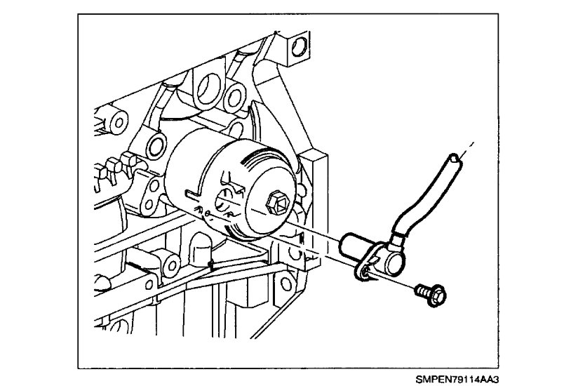

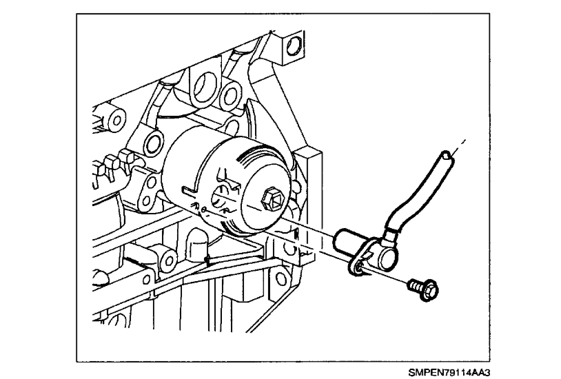

No, but I actually had one of my customers bring his scanner today and we got come clarity. They read P0335 crankshaft position sensor and P0136 sensor bank #2.
Sunday, November 17th, 2019 AT 5:16 PM
  • 52,797 POSTS
Below is the procedure and location of the sensor. Make sure the connector is clean, tight and no damaged terminals.
REMOVAL
1. Remove crankshaft position (CKP) sensor bolt.
2. Disconnect CKP sensor electrical connector.
3. Remove O-ring from CKP sensor.
INSTALLATION
1. Grease O-ring with mineral oil based grease.
2. Install new O-ring.
3. Connect CKP sensor electrical connector.
4. Gently press CKP sensor into place.
5. Install CKP sensor bolt.
Torque Crankshaft Position Sensor Bolt: 8 N.m (71 in-lbs)
