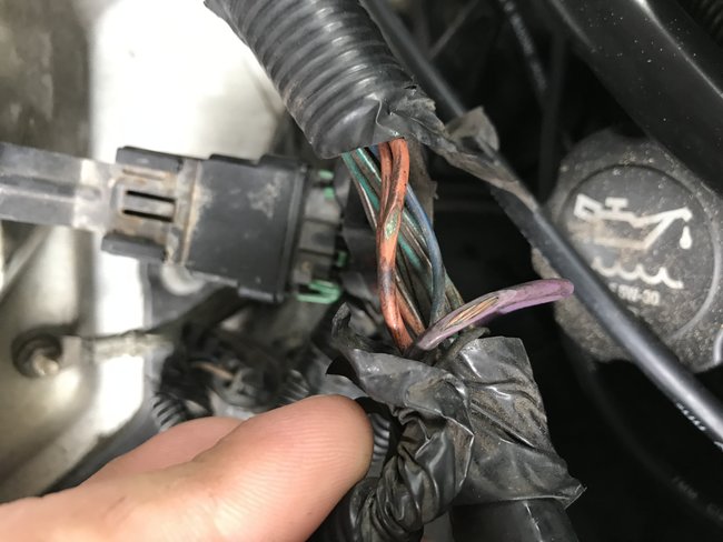

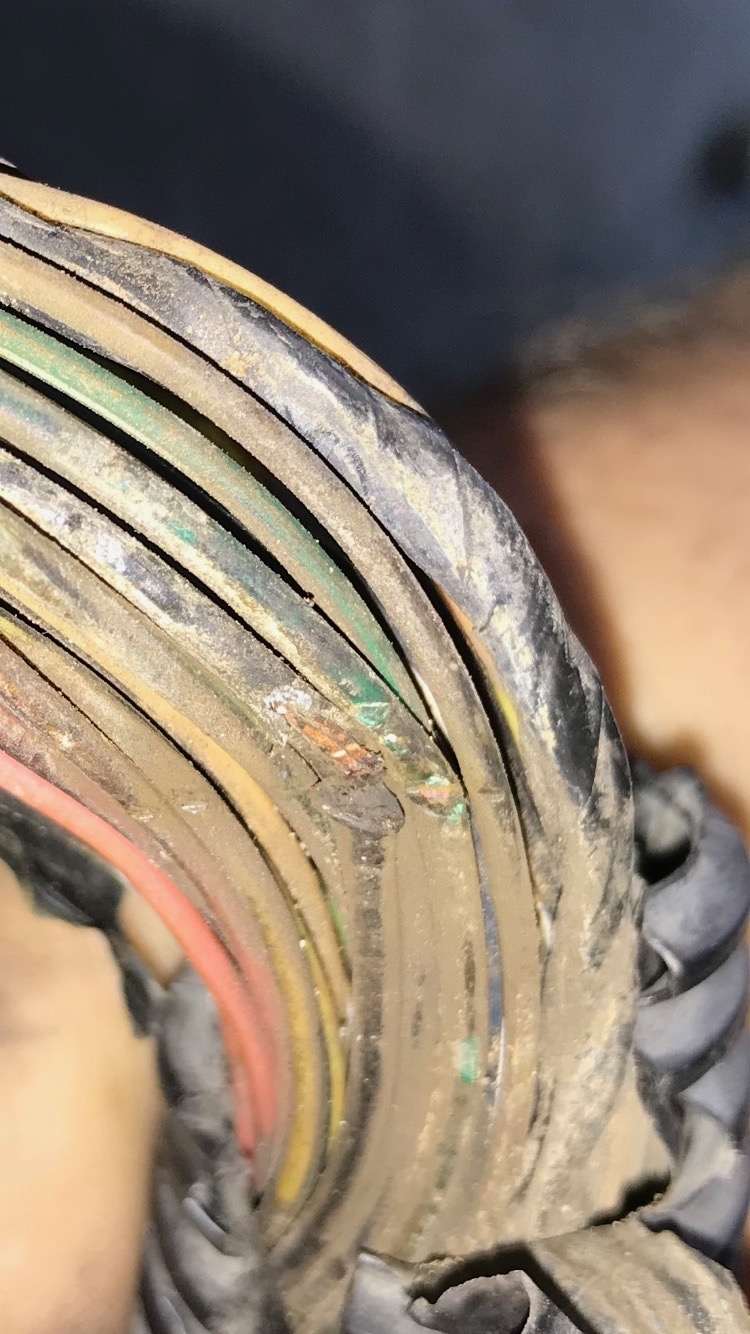

Chased the wires from the ECM 1 circuit found some damaged and completely exposed down at the exhaust.

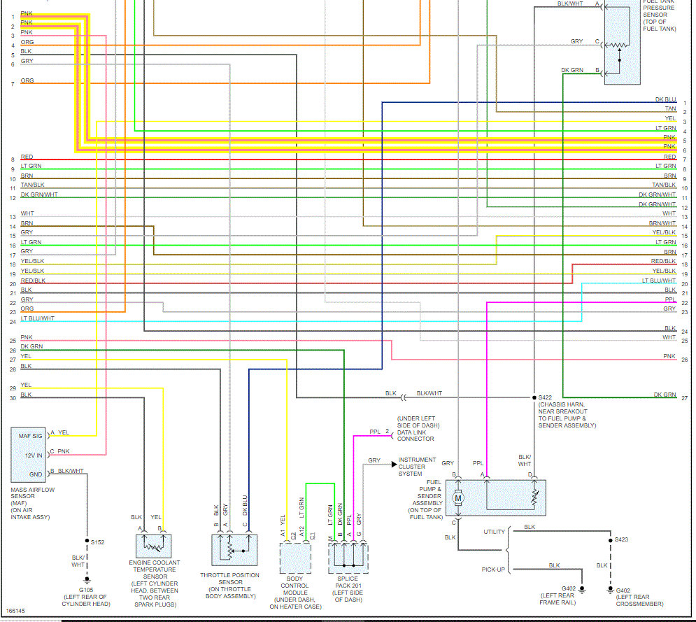

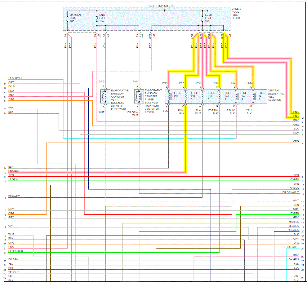

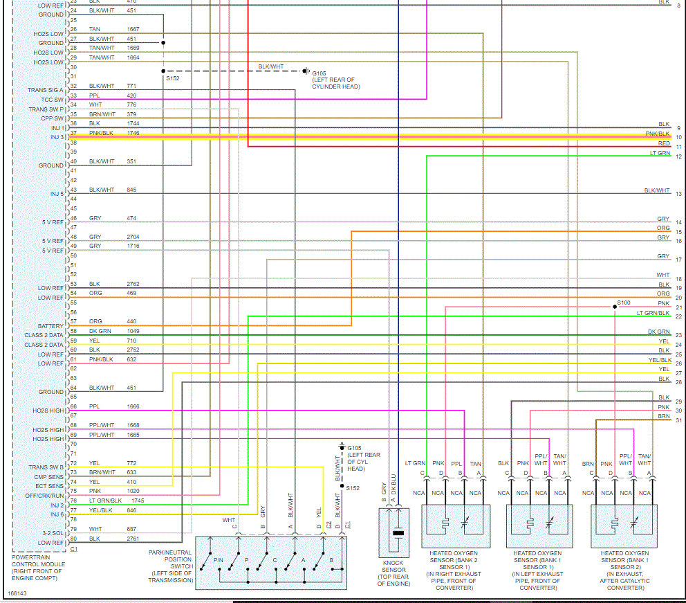

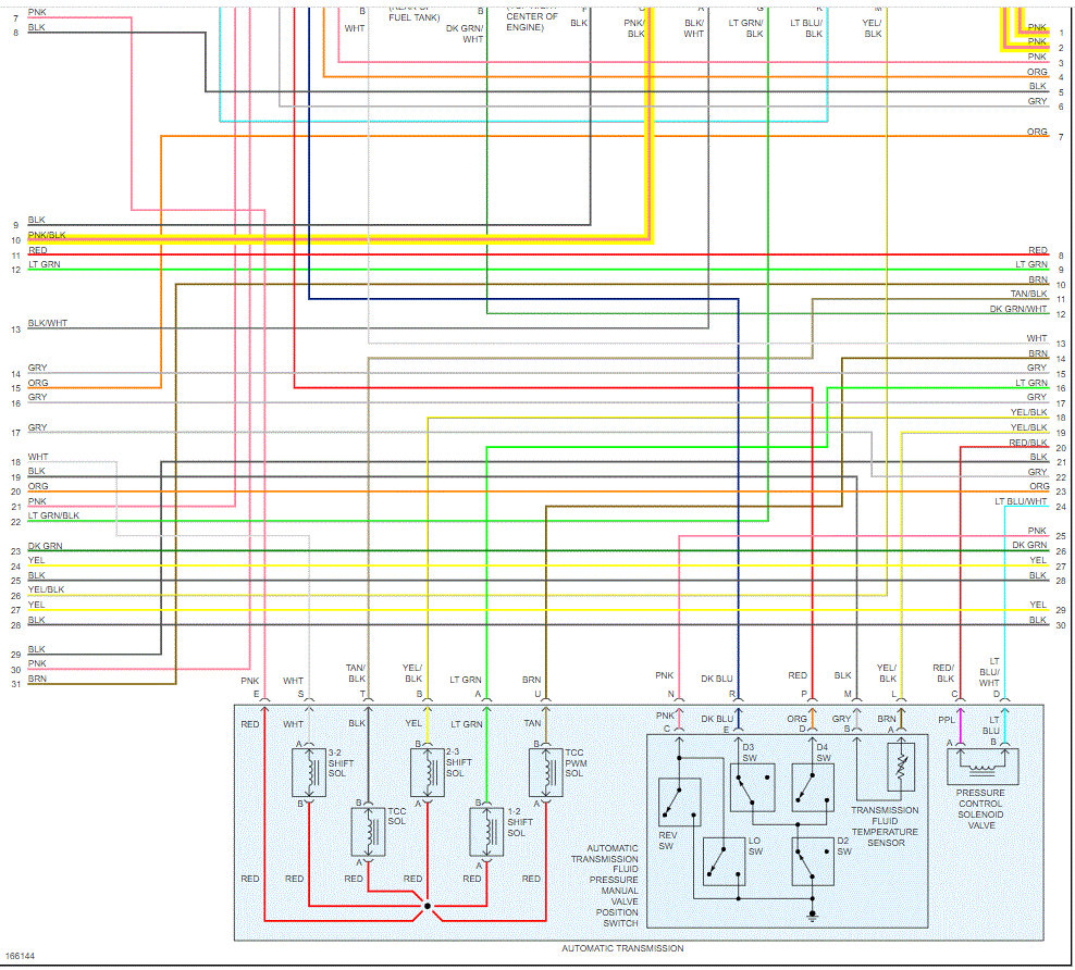

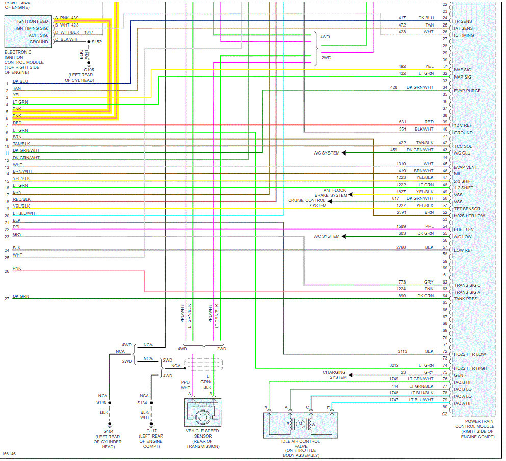

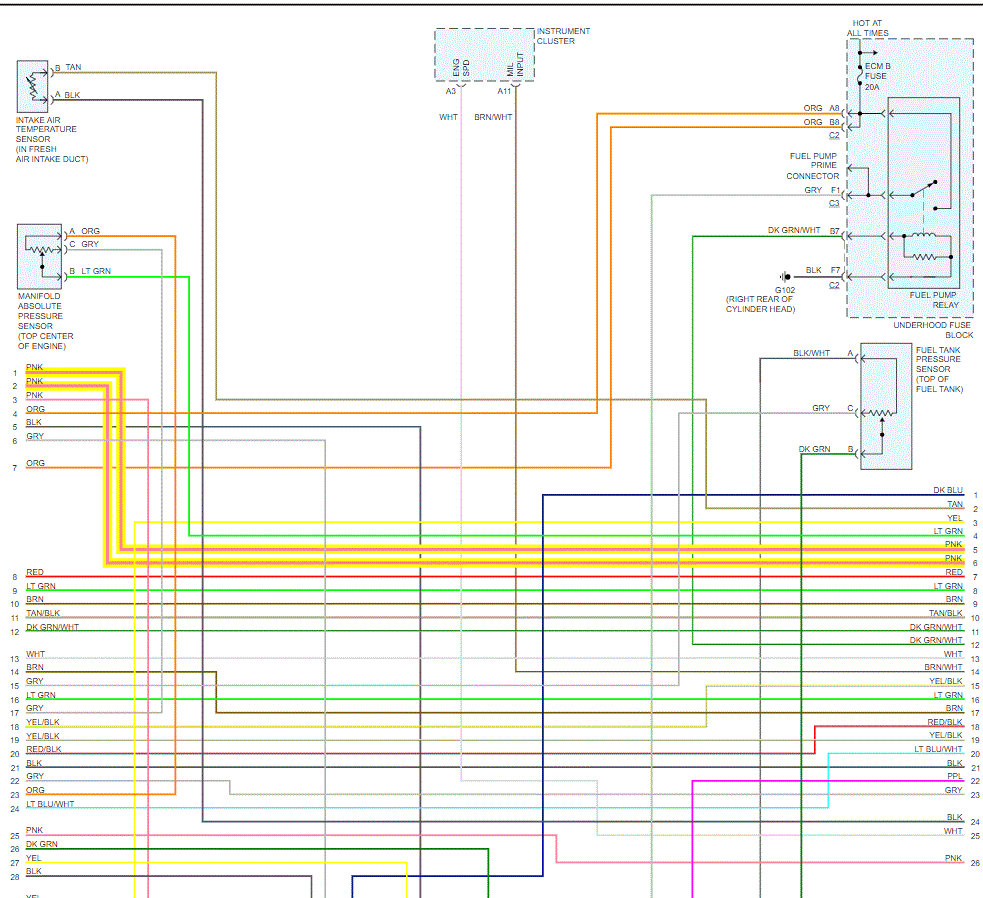

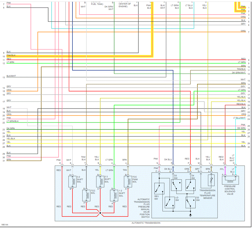

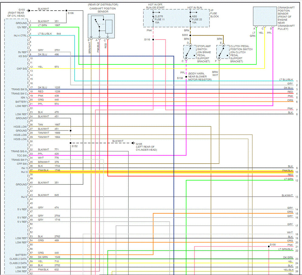

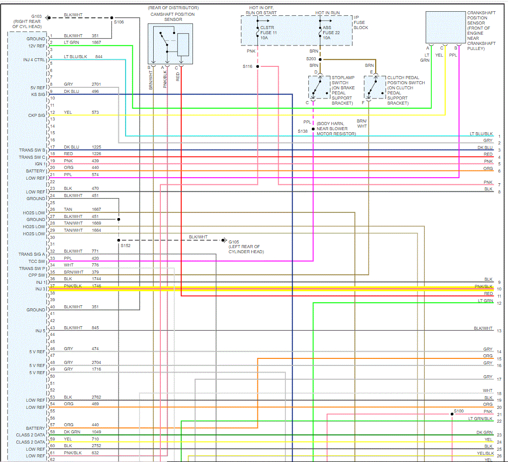

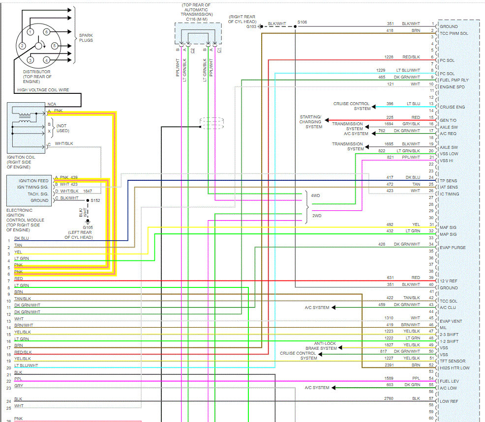

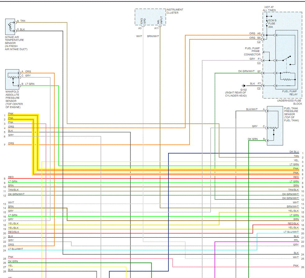

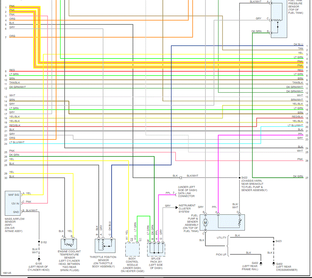

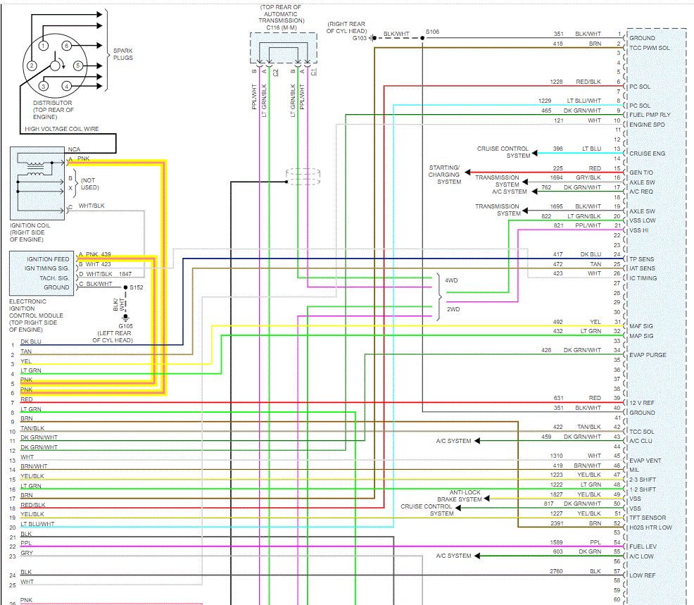

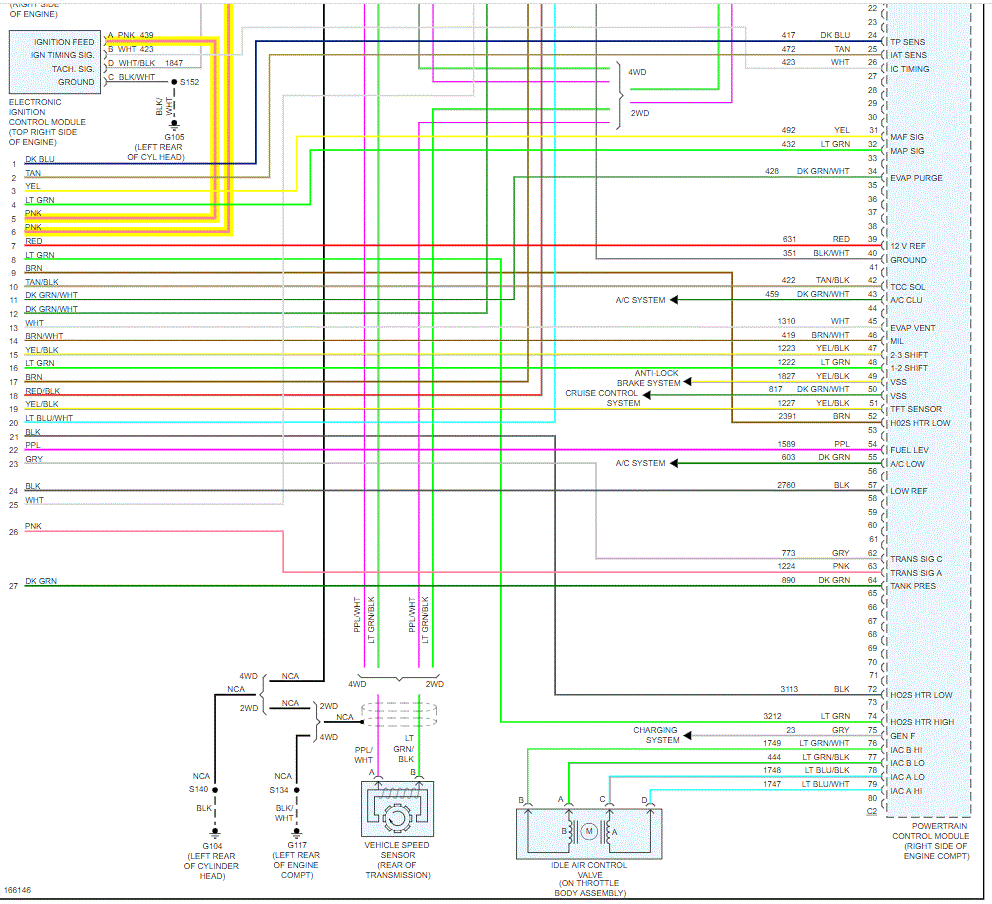

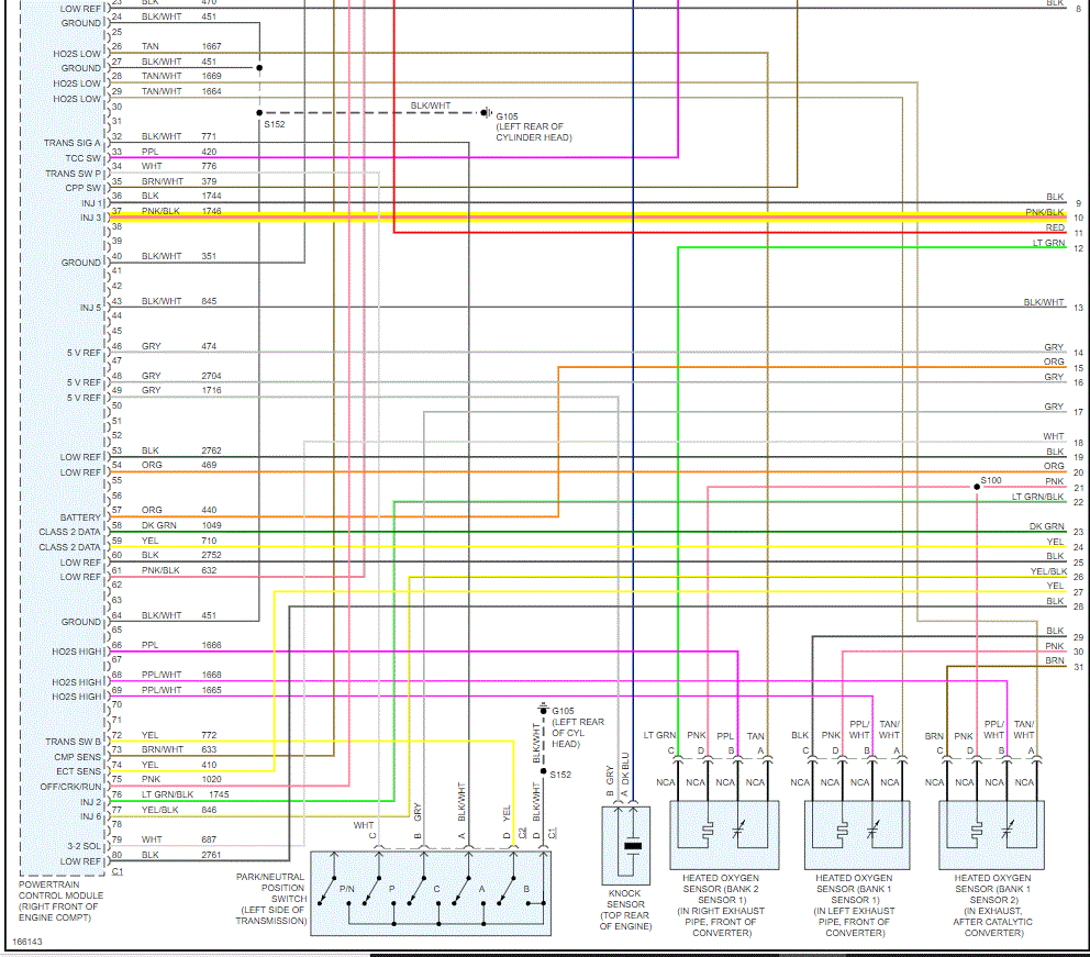

If you have exposed wires, it sounds like you found the issue. If you look at the pics below, I included the entire wiring schematic for the powertrain management. I highlighted the ECM 1 fuse and the wiring to the injectors and from there to the ignition control module and the distributor. The injectors have wires going from them to the PCM. I didn't highlight them.
The wires you found, what color are they? Are they pink by chance? If not, let me know what they are.
Based on the P0200, I would first suspect there is a short at one of the injectors. Disconnect cylinder 3 and cylinder 6 (one at a time) and see if the fuse still blows.
Here is a link you may find helpful when testing wiring:
Let me know if the fuse still blows and the wire colors that are damaged.
See pics below. Note: I had to cut each of the schematic pages in half to make them readable for you. I did overlap each page so you can follow from one to the next. Use this to trace the wires you found which are damaged.

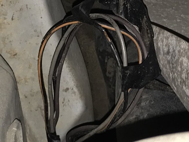

Hi Joe! Thank you for the Info and schematics. The wires I found were green and a black one with a white stripe. Fixed those but still won’t crank. I also found a damaged black one around the fuel pump connector area and a purple one on the set of wires that goes to a relay near the A/C components (the harness running at the top of the firewall). Haven’t repaired them cause had to work yesterday. My maintenance man who’s a part time mechanic briefly looked over it and said what’s weird is the female ports on the harness injector connector shows 12v on the grounds of all 6 sets as well as at the ECM 1 fuse and a few other fuses just can’t remember which ones and when that’s disconnected and the I crank the engine it doesn’t blow a fuse so I’m wondering if it’s not the damage wires but something with the fuel injectors themselves. But would a new refurbished one do that as well or is there something shorting out the spider injectors possibly? I am financially already pinching pennies can’t afford mechanics labor too. I’m missing work trying to figure it out and when you remodel homes a vehicle is absolutely a necessity. so, I’m at my wits end on what to do. People say get what I can for it and get into a newer vehicle with a payment but from what I hear these Blazers have sound engines that will last to 300,000 and its fully owned so don’t want to sell it and regret it down the road if it’s something minor.

First are the damaged ones I repaired.
Second are damaged wires going to the fuel pump connector.
Third are damaged ones near the firewall.

First, make sure all damaged wires are repaired and insulated. Next, all pink wires going to the injectors should have 12v at all times. A ground path is provided via the PCM.

Yeah, the pink wires going into the connector piece at the harness that plugs into the actual spider unit are all reading 12v and the ground ports on that connector are also reading 12 V and to my understanding from what that guy was saying the grounds are supposed to show zero not positive. It's damaged on one of the middle ports where it looks like the pin hit the edge and cracked it a bit. It’s also showing 12 V on the ECM fuse but also 12v where it is supposed to be zero for a ground. I was looking at the schematics trying to see where all the grounds go thinking one of those grounds coming off the PCM are touching a positive somewhere along the lines. I know when doing electrical houses, it’ll read a hot neutral when it’s making a connection with a positive somewhere down the line. Being the second spider injector unit and it being an open circuit is there a need to open that all back up? How likely is it the issue stems from there? Thank you so much for helping. I’m really up a creek if I can’t figure this out so all your insight is greatly appreciated.

If you are getting 12v to ground at all of the injectors, there is a chance the PCM has failed. Do me a favor. Disconnect the PCM and see if the power from the grounds goes away. If it doesn't, there has to be a short to power at some point between the PCM and injectors. However, for all of the injector grounds to have power, there has to be a common fault because each injector has its own ground path. Make sure the connector at the PCM is good, not damaged (pins), and has no corrosion.

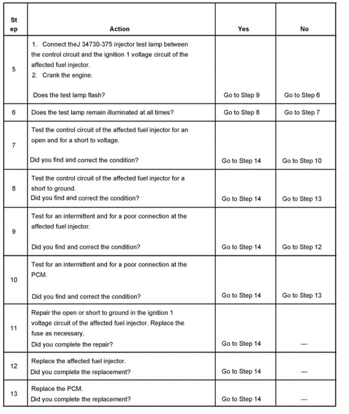

As far as the codes, you likely already know it's cylinder 5. Here is how it works: The control module enables the appropriate fuel injector pulse for each cylinder. Ignition voltage is supplied to the fuel injectors. The control module controls each fuel injector by grounding the control circuit via a solid-state device called a driver. The control module monitors the status of each driver. If the control module detects an incorrect voltage for the commanded state of the driver, a fuel injector control DTC sets. That is the P0200.
Let's try one more test.
Disconnect injector 5 and see if the fuse blows. If it doesn't there is a chance the ignition 1 voltage is shorted at the injector. If it does blow, then the short is before the injector and after the ignition 1 fuse.
If it doesn't blow, probe the ignition 1 power supply to the cylinder 5 injector. With the key on and the engine off, you should have power.
If you do, connect the tester to the control wire (PCM) and the ignition 1 voltage wire. Crank the engine. Does the test light flash?

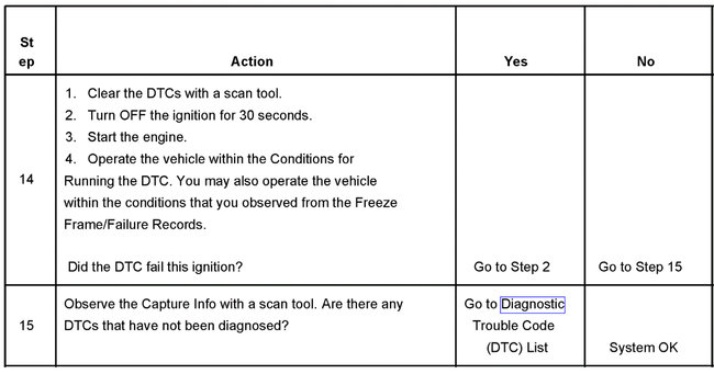

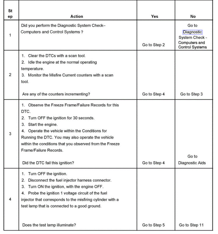

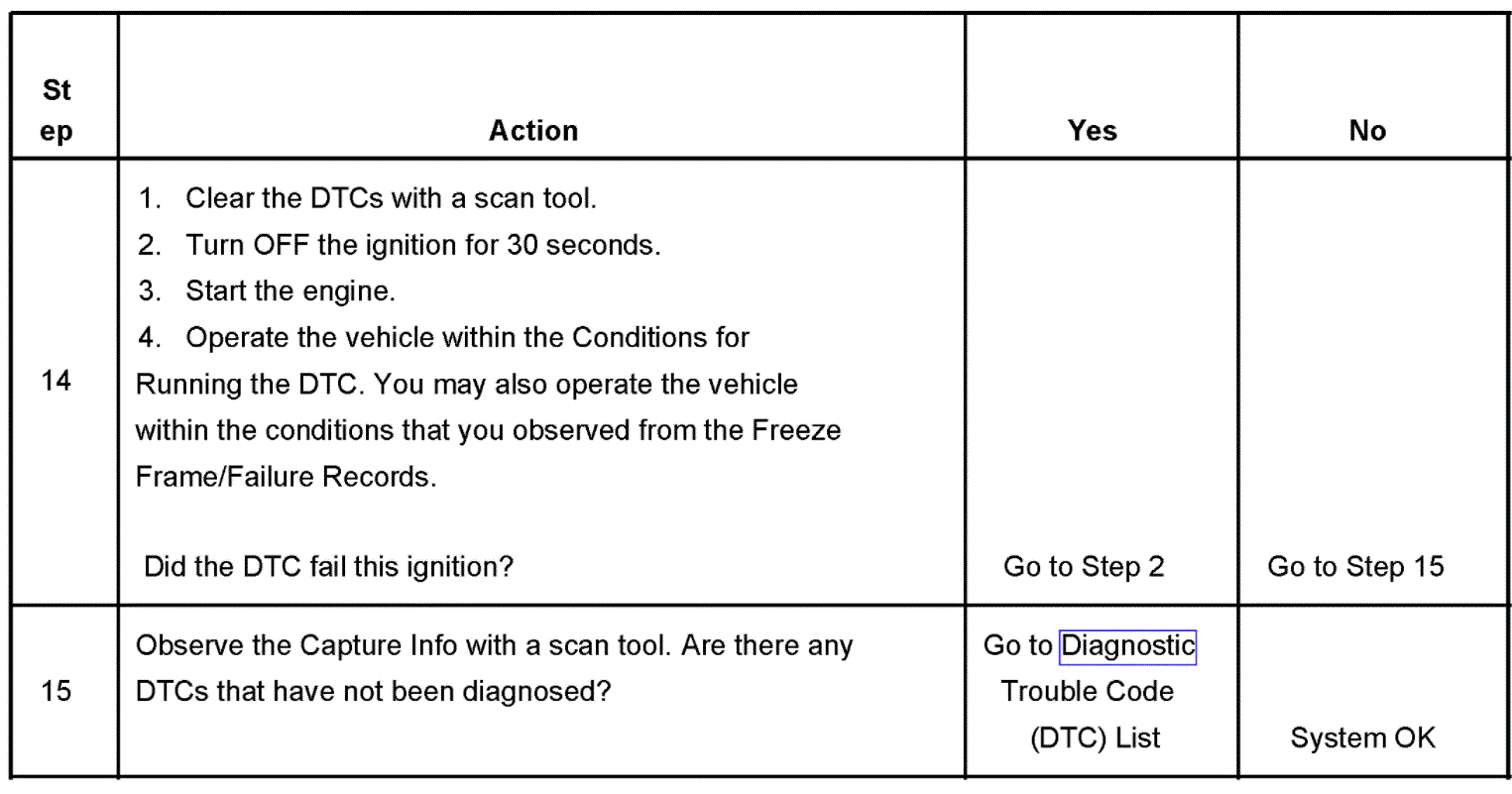

The P200 is related to a variation in voltage to the driver (injector). Something is causing an electrical issue. It could be a wire, corrosion, a faulty injector, a bad PCM, and so on. We are missing something simple.
Take a look through the diagnostics below. I've walked you through some of them already. However, follow them step by step. Also, let me know if the cylinder misfire code came back as well (cylinder 5).
