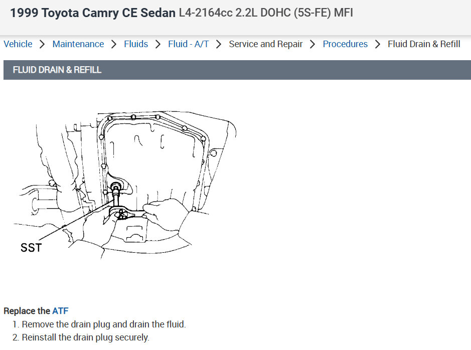

Hey all,
My car makes a clunk when going into overdrive and does it really well going 60 MPH, letting off the gas and engaging again.
Other symptoms (maybe unrelated) are a grinding noise at 1800-200 rpm under load, slight vibration at idle, and occasionally the engine RPMs will drop almost to a stall (very rarely stalling). Transmission fluid level is good, no burnt smell, but very dark.
I’ve had the car 2 years and haven’t done anything with the transmission. There are no other symptoms (no CEL), and the car shifts great going into the gears, forward and reverse no problem.
Any thoughts fellas?

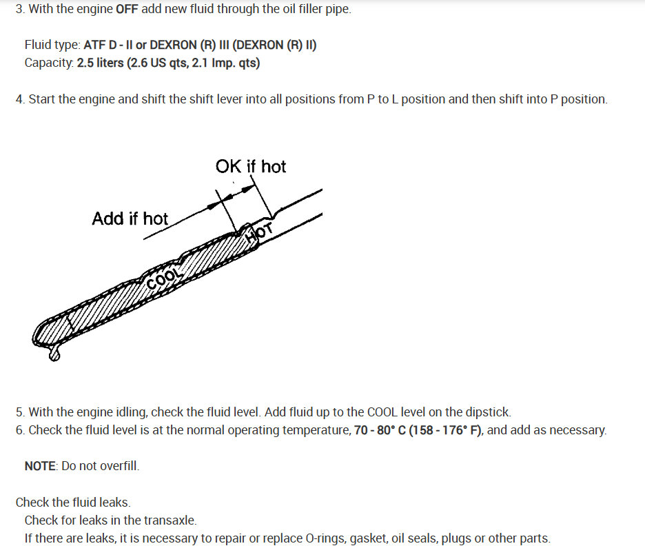

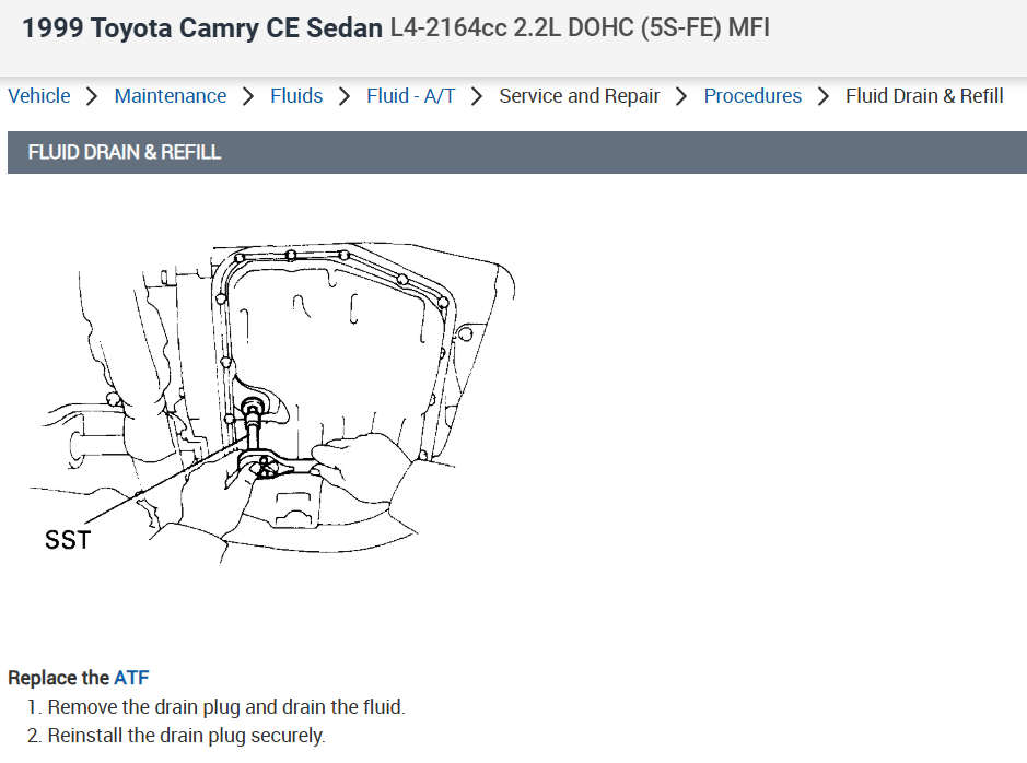

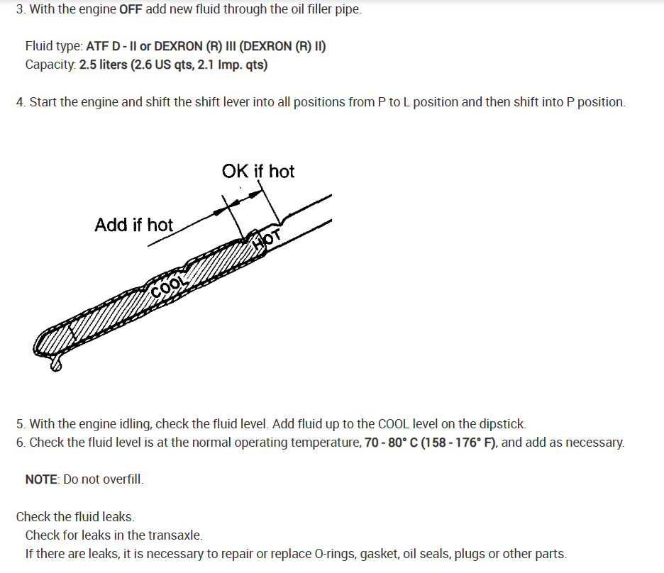

Yep, I would change out the transmission fluid because even though it does not smell burnt the fluid breaks down and stops working, the way it should. Here is a guide to help you with instructions in the images below on how to do the job for your car and what type of fluid to use.
Fluid Types
A/T Fluid
Type .................... D-II, DEXRON II or DEXRON III
Capacities
Automatic Transaxle Fluid
Drain and Refill .................... up to 2.5 liters (2.6 US qts)
Fluid Type .................... ATF D-II or Dexron-III - Dexron II (r)
Differential Fluid
Capacity .................... 1.6 liters (1.7 US qts.)
Total dry fill combined .................... 7.2L (7.6 qts.)
