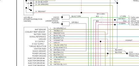

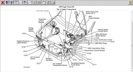

Hi im mark and im in college for industrial electronics my car just recently died when i was driving down the road. I took it to a shop and they said the cpu dosent have any power. They charge 60$ hr for labor so im thinking about taking to my college and try to troubleshoot what is wrong. I know that one of the engine mounts was broke so the engine jerked when i went in reverse It was fixed tho but could of damaged the wires by the radiator and fan. I have no clue where the cpu is located and dont know where to start a schematic would be nice to. If anyone could help me out it would be really appreciated... this is my only transportation from college to home. [img:4533e5e9d6]http://www.2carpros.com/forum/automotive_pictures/490742_100_2722_1.jpg[/img:4533e5e9d6]

CPU is the PCM Powertrain Control Module its located in right front corner of engine compartment.

Check and test the fuse B 20amp in the power distribution center it powers the auto shutdown relay and the computer Its a red and white that goes to the ASD relay fom the fuse B 20amp to computer pin out 3 A14

If it isent the fuse. what aproach should i take next? and i was wondering if you could email me the full schematic because it looked like it is choped off at the side and top. my email is bear42095@yahoo.com I am going to go check the fuses today. Thank you

Just sent the diagram if its not the fuse test the red and white wire from the fuse to the computer-
