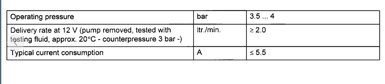

Hi. I am recently getting p0300 , p0301, p0302, p0303, p0304 using an OBD tool. I have replaced coil pack, sparks plugs, camshaft position sensor, valve cover o-rings, fuel filter. The strange thing is a i getting only p030x codes and nothing else. I have been thinking about fuel issues like low fuel pressure and I wanted to measure the pressure but isn't a fuel issue supposed to bring up another obd code? My compression seems fine and plug wires are the only things left regarding the ignition. I have poured one liter of 10w oil in the gas tank while being full of gas in order to clean up my fuel pump in case of malfunction.
What do you think? Any ideas?

I would check the fuel pressure. Low fuel pressure would cause these codes as there is not enough fuel at the fuel rail.

ASEMASTER6371. Thanks for the reply! I have updated my original question as well. Shouldn't the low fuel pressure bring up another obd code as well?
Mar 21, 2020 at 11:42 PM
The car is too old. 1999 did not have a smart ECM like the ones today.
