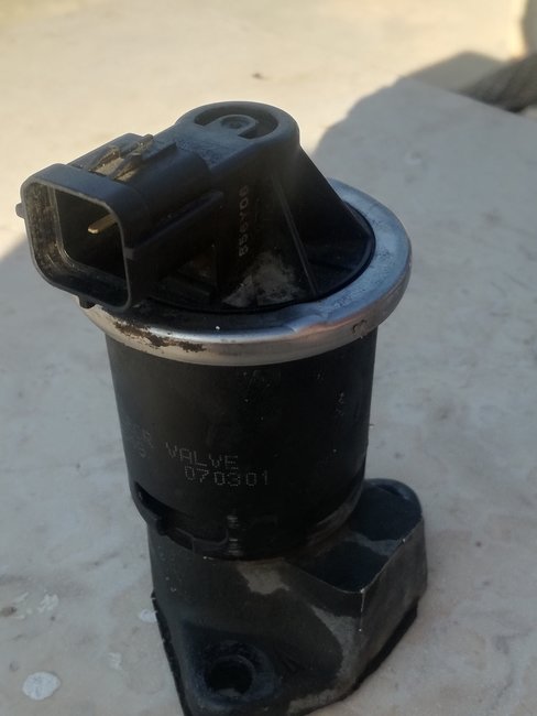

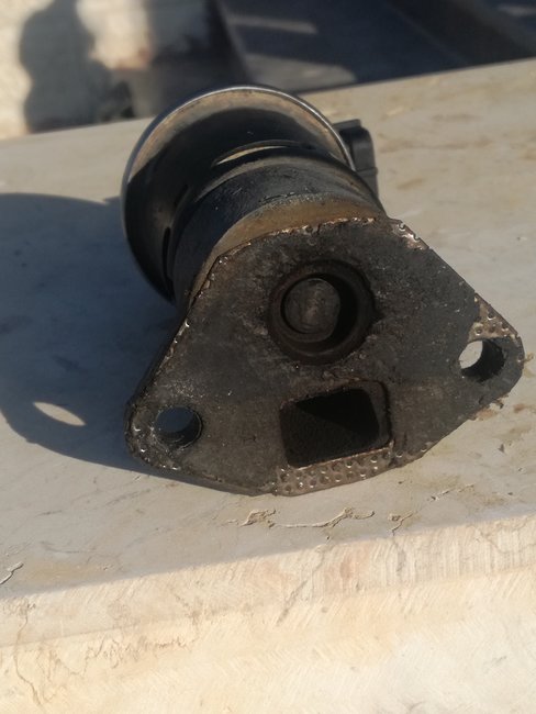

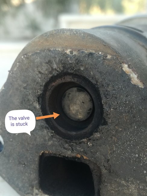

Car has an automatic transmission. it takes high gasoline consumption trouble. EGR valve has been cleaned but it has problem, its valve stuck at extended position as shown by attached image.
Jul 7, 2019 at 11:37 PM
Hi Omar,
Yes, that valve as seen its better days. This will cause fuel consumption and some performance issue even a check engine light.
Most EGR valves can be cleaned but when they are in this condition, I would replace it and then retest the vehicle. Just replacing the valve could fix all your issues so I would not do anything else until this is repaired.

4. E.G.R valve has been cleaned but it has problem, it's valve stuck at extended position as shown by attached image.

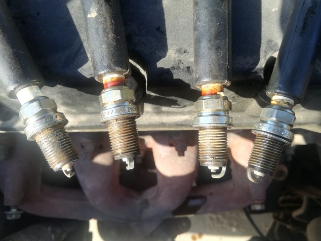

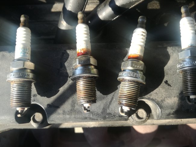

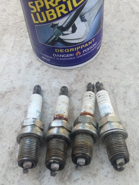

5. Spark plugs has been replaced before 4 months ago shown by attached image, they are arranged in order but I cleaned them.( 3000km until now)
Gasoline consumption still too high. Please solve this problem, it takes too money daily.
Best regards
Jul 8, 2019 at 1:08 PM
You named a couple problems that will effect fuel mileage that you have not correct. You need to replace the EGR and I would put new plugs in it again. These plugs are worn due to high fuel saturation. Once you do these two things, I would retest your fuel consumption.
