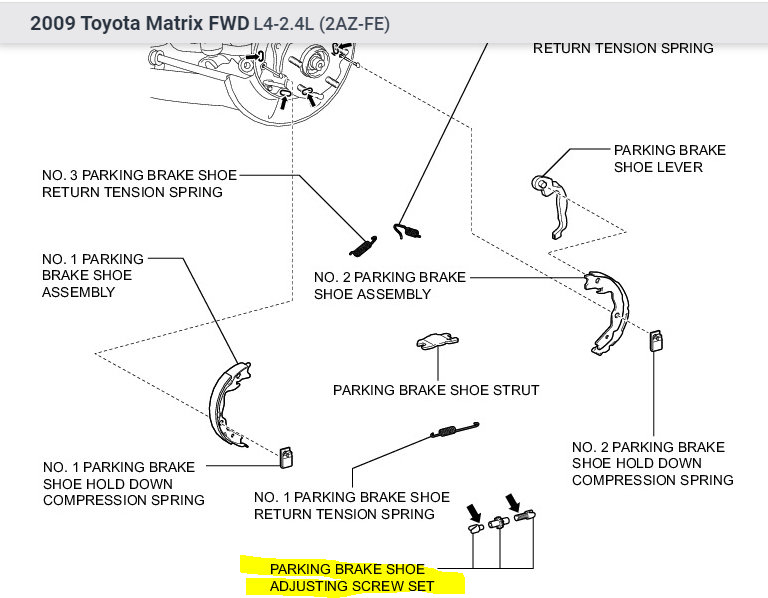

Hi Experts, I'm writing for advice on adjusting a loose e-brake. I've adjusted it in the cabin below the lever and it's still loose. From what I see online my next step is to remove the rear tires and adjust it there (Providing my cable isn't snapped, which I have yet to verify).
My question is, I see two different types of adjustment online. One is to rotate a little star wheel that is located behind the disk and the other is to adjust behind the caliper. Can anyone tell me what the method is for my specific car listed above? My rear brakes use calipers, not sure if this is relevant but I'm trying to provide as much info as possible. Thanks in advance!

On this model vehicle, you will need to remove the brake caliper and disc rotor to access the adjuster. It is a star-shaped adjuster.
I attached an exploded view of the component below.
If you are not getting any braking and you have the inside adjuster fully set, you may have a broken cable. So, check that.
Also, if the cable is good, turn back the interior adjuster so you can fine-tune it once the adjustment is made at the wheel.
When you remove the brake disc rotor, make sure to clean the components inside with brake cleaner, and inspect the brake shoes to make sure they are good.
Let me know what you find or if I can help.
See pic below.

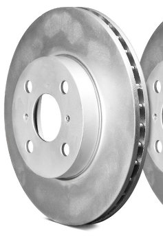

Also, based on my manual, this model only came with rear disc brakes. When you look through the rear wheel, you should see the disc rotor. It will look much like the front brakes. I attached a pic of a brake rotor below. Let me know if that is what you see.
Also, the link I attached explains how to remove the brake caliper, pads, and all that is needed.

Ah, yeah, that's exactly what I see.
