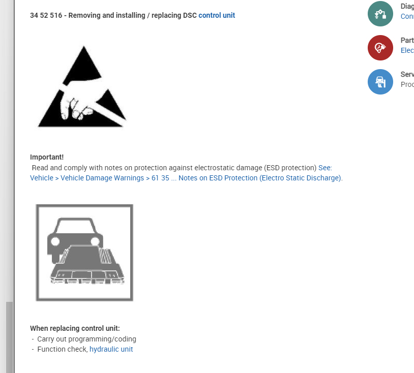

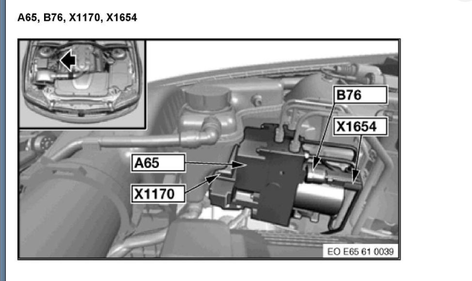

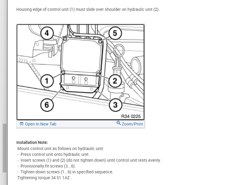

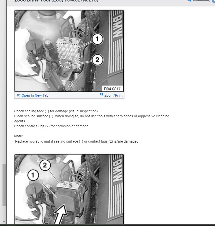

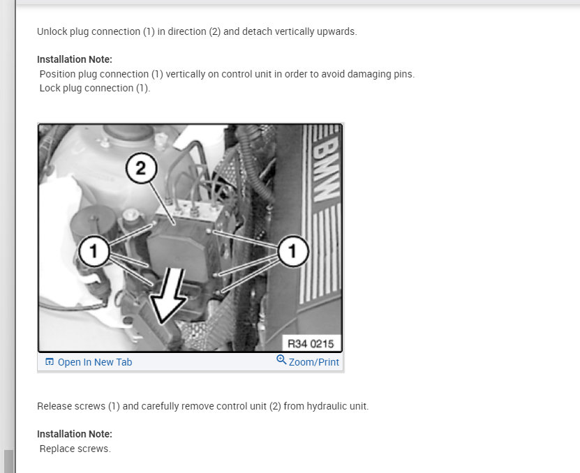

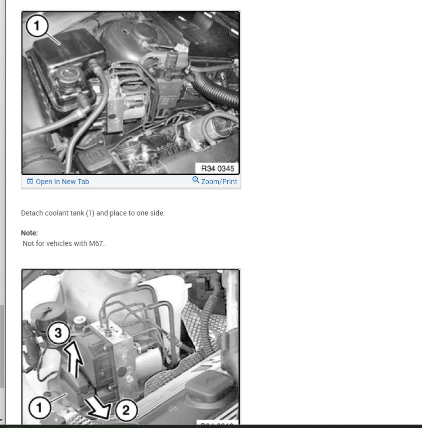

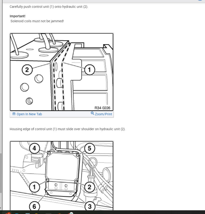

I am attaching the info below on how to replace this which is what it appears it needs. Clearly, I would want to get more detail on this but the manual does not have any testing for this code. Unfortunately, it is pretty clear.
If it were me, and the vehicle is driving properly then I would attempt to put some more miles on it before I replace it. This way we can see if the code will clear or not.
