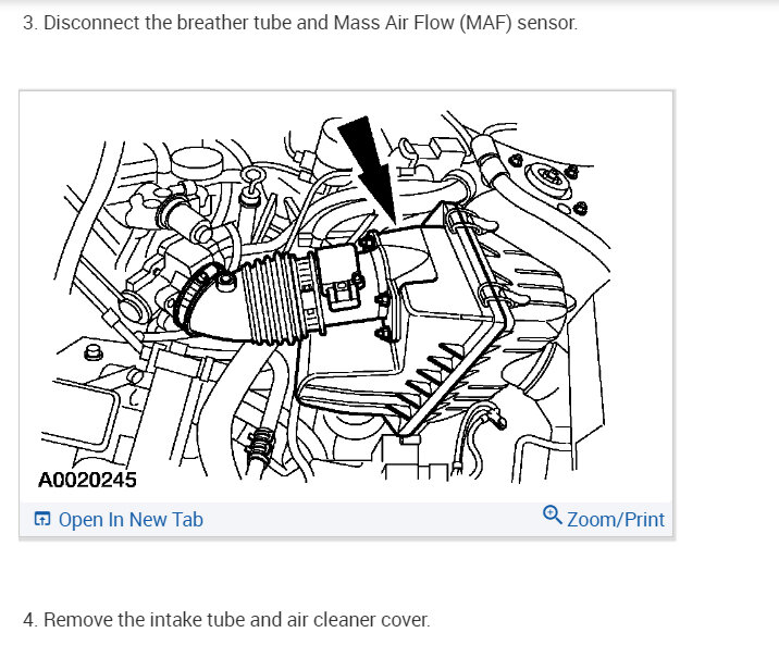

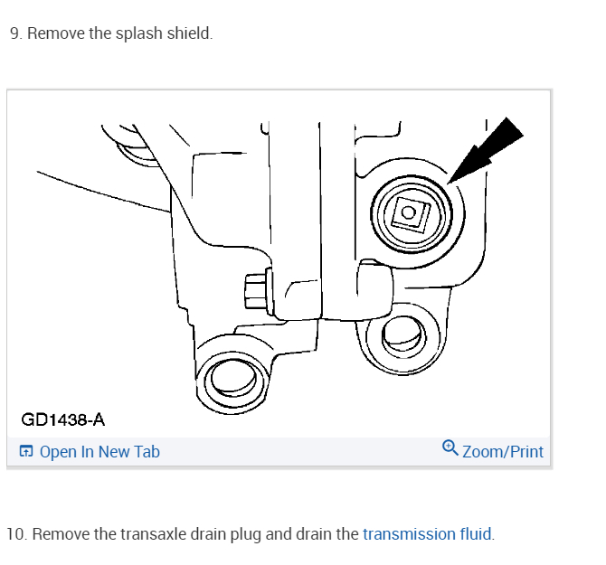

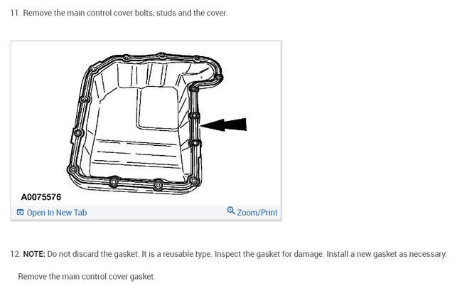

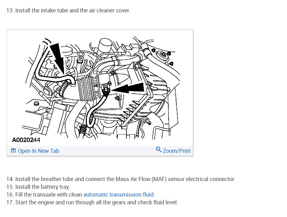

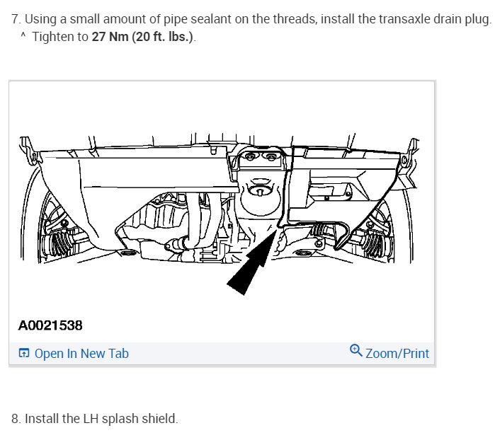

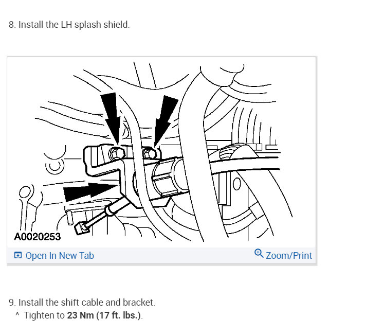

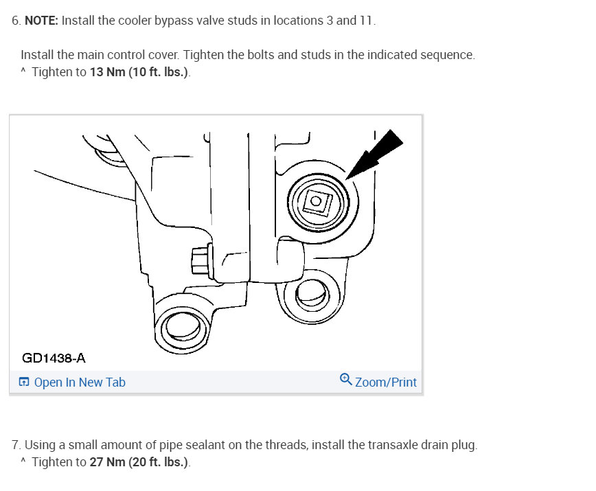

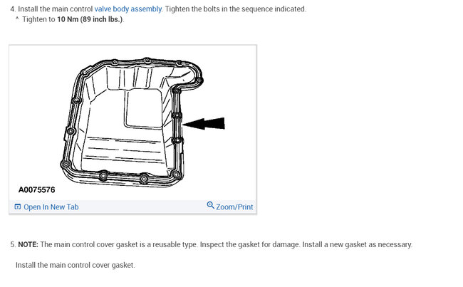

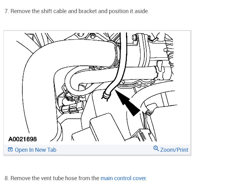

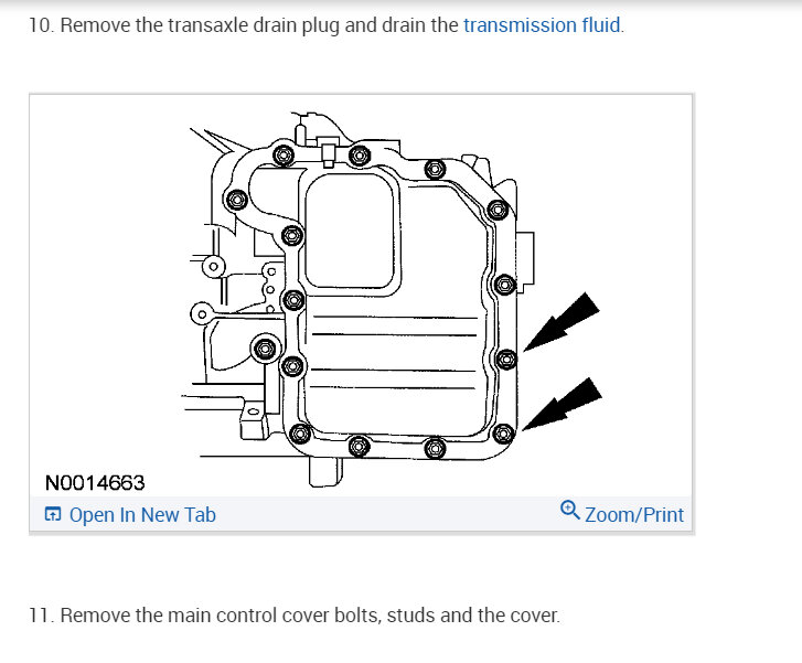

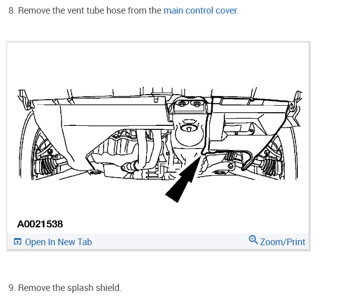

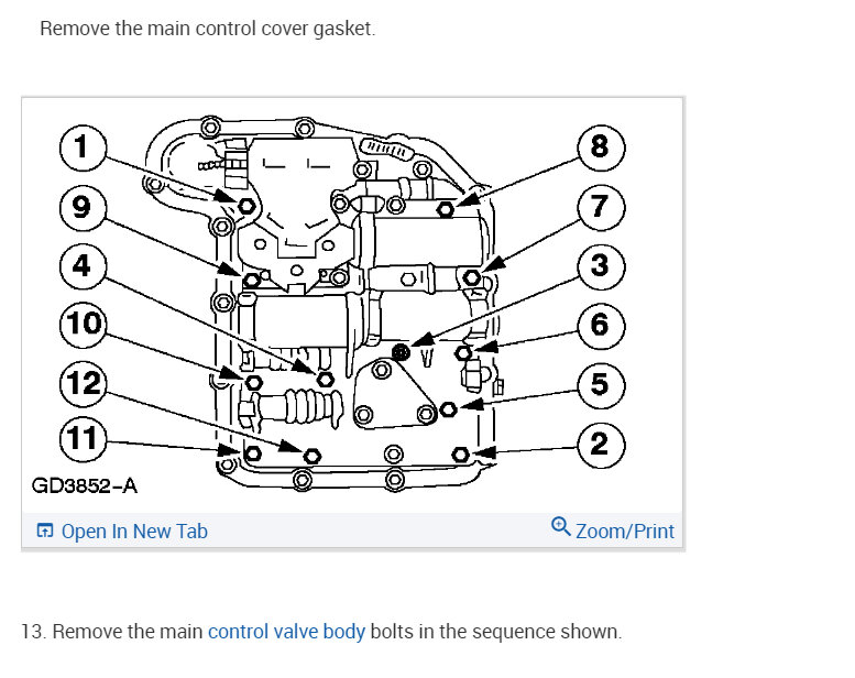

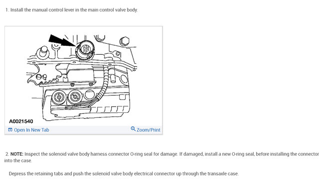

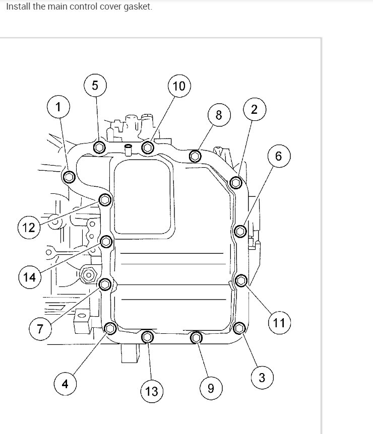

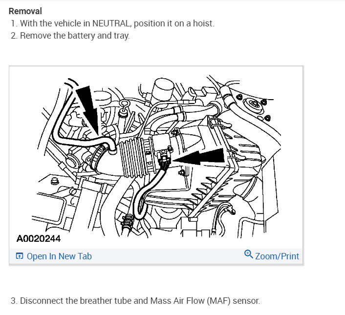

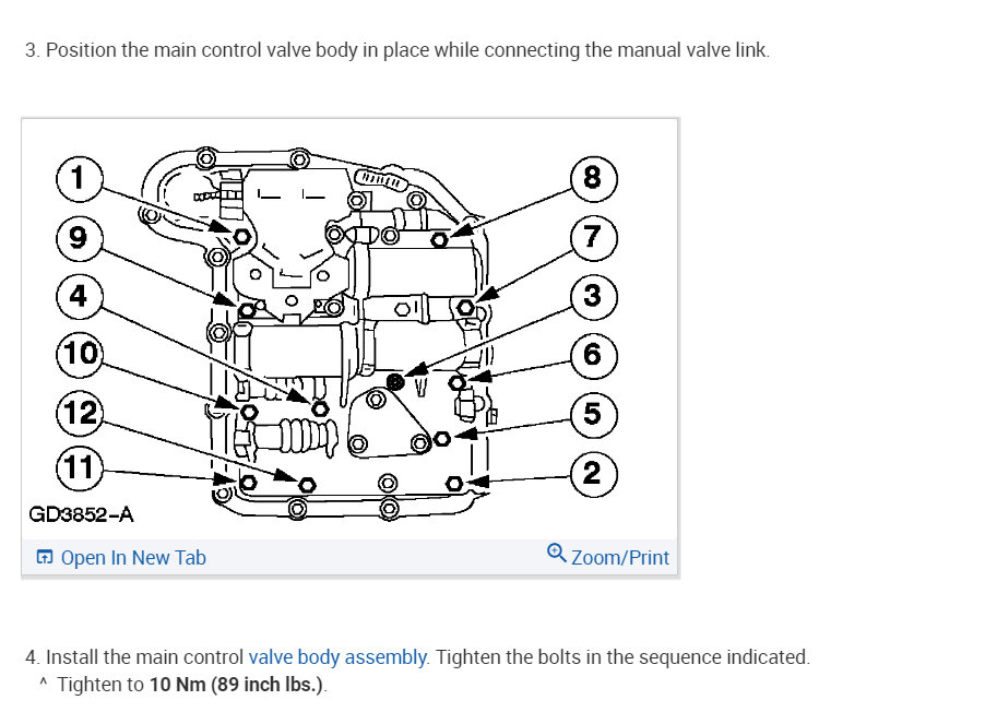

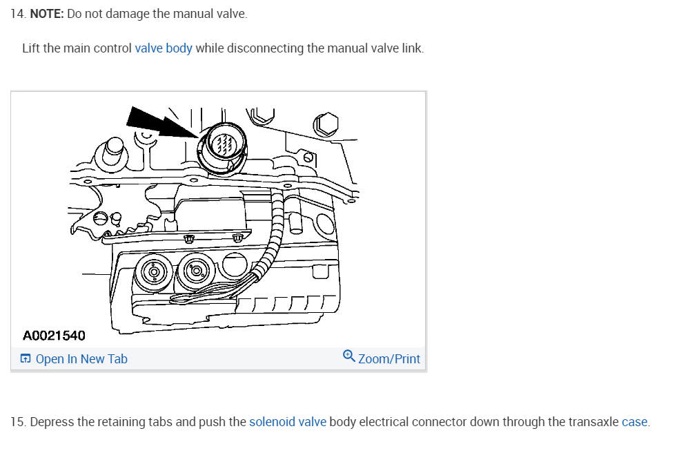

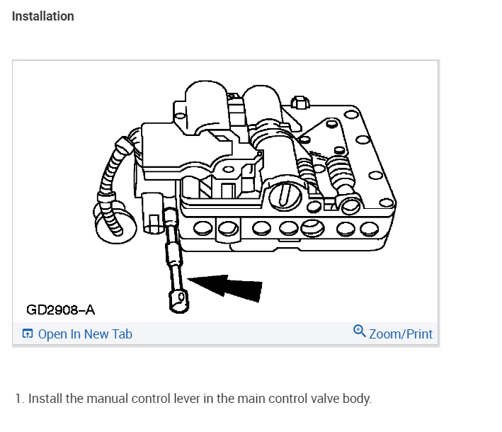

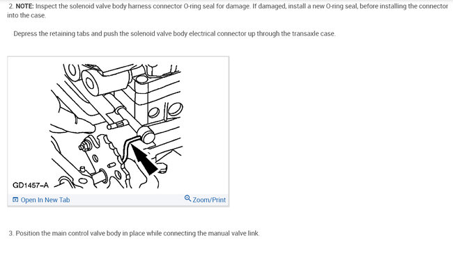

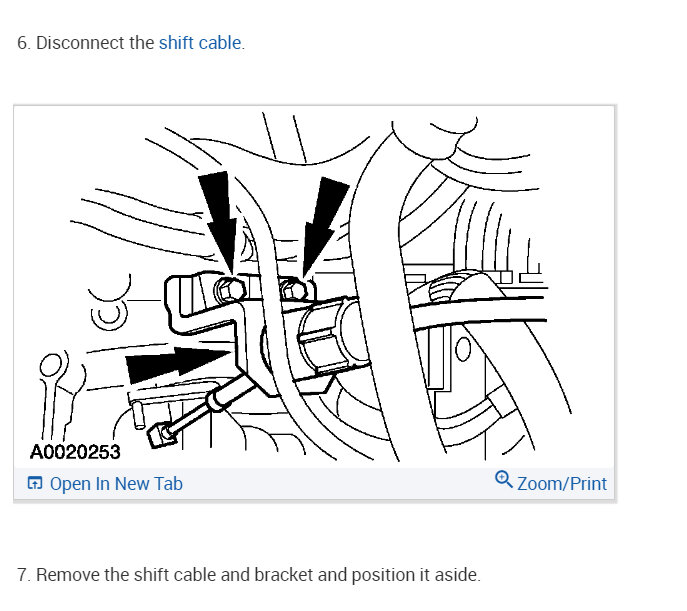

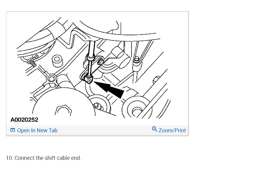

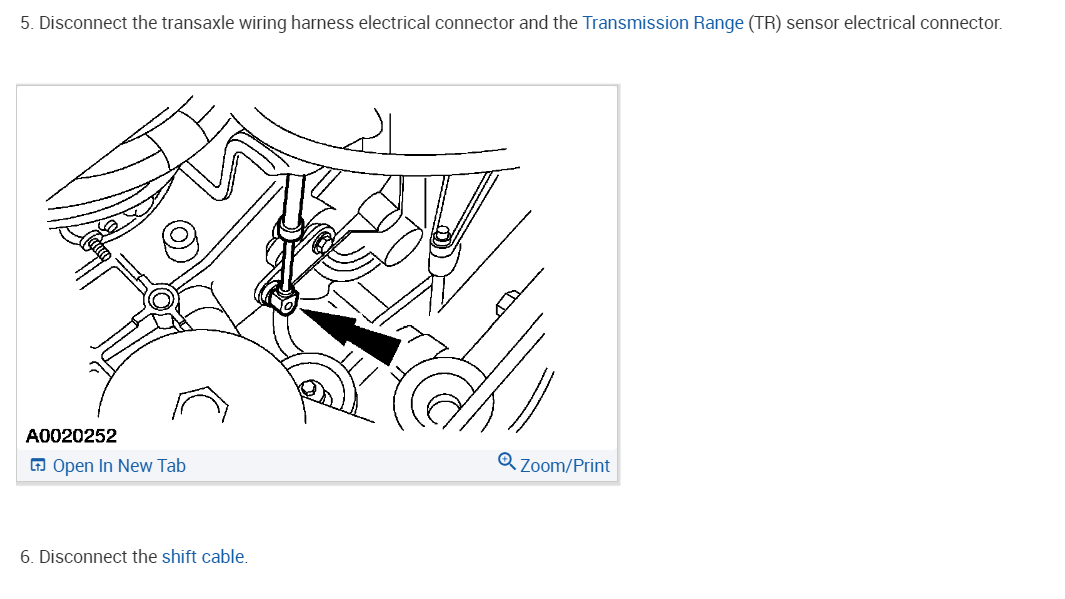

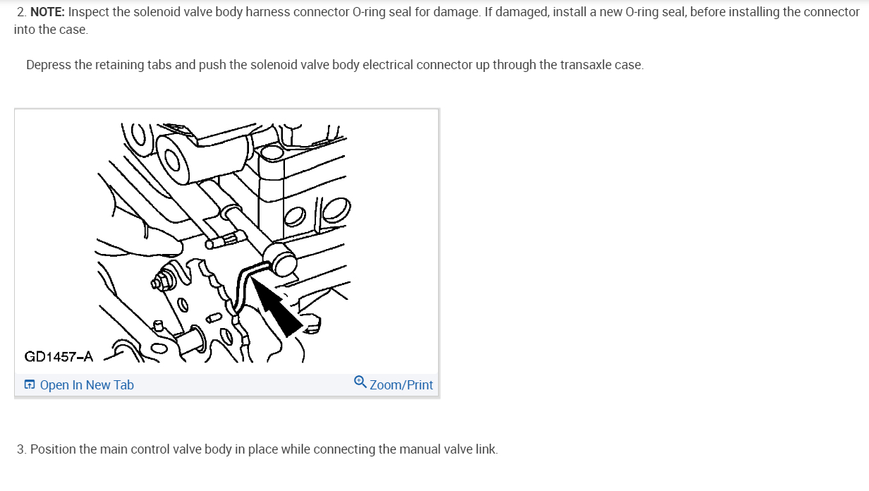

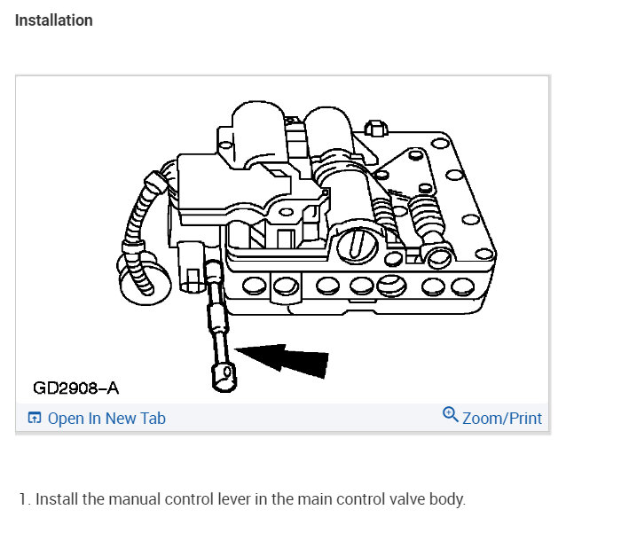

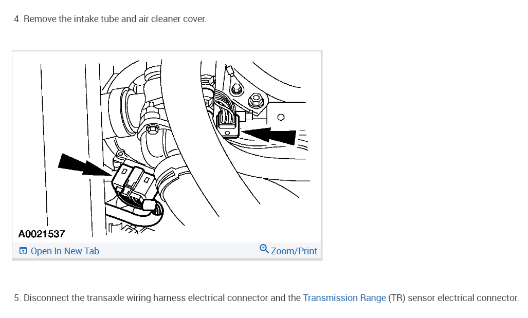

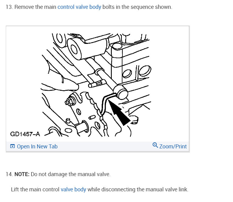

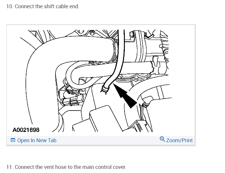

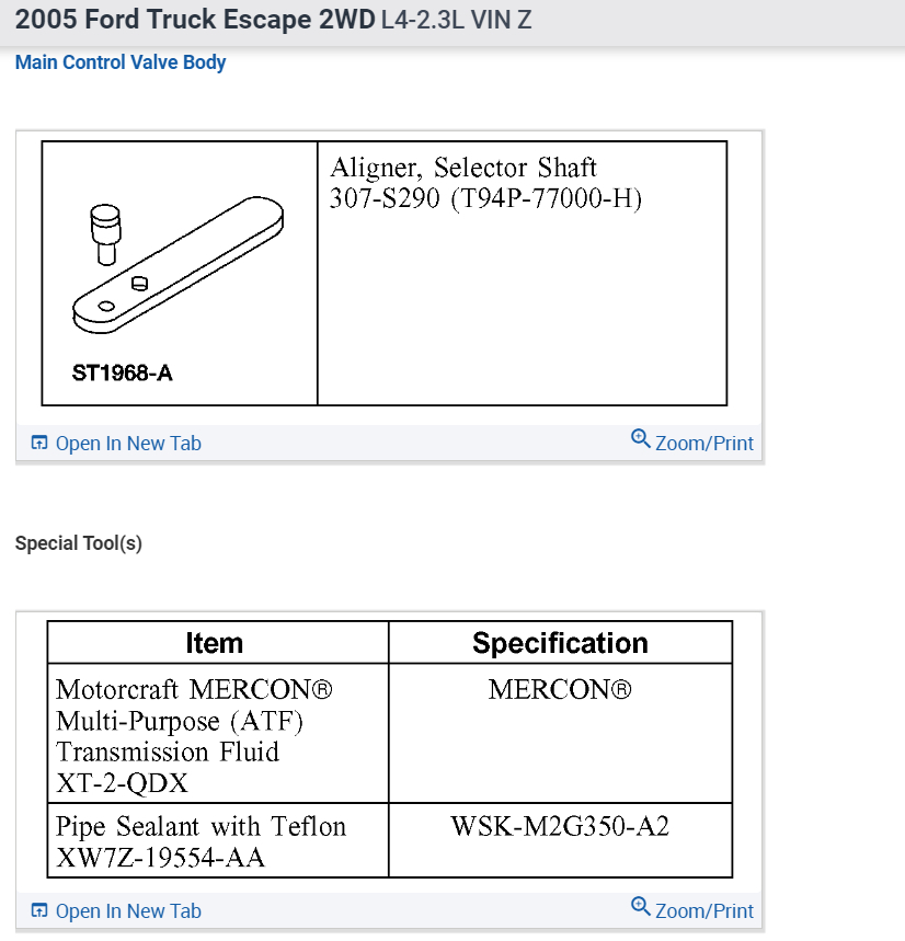

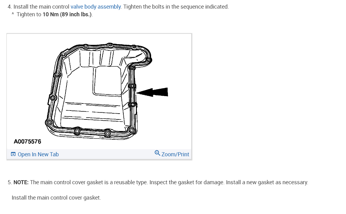

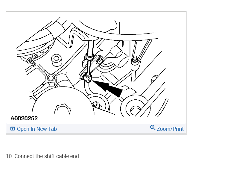

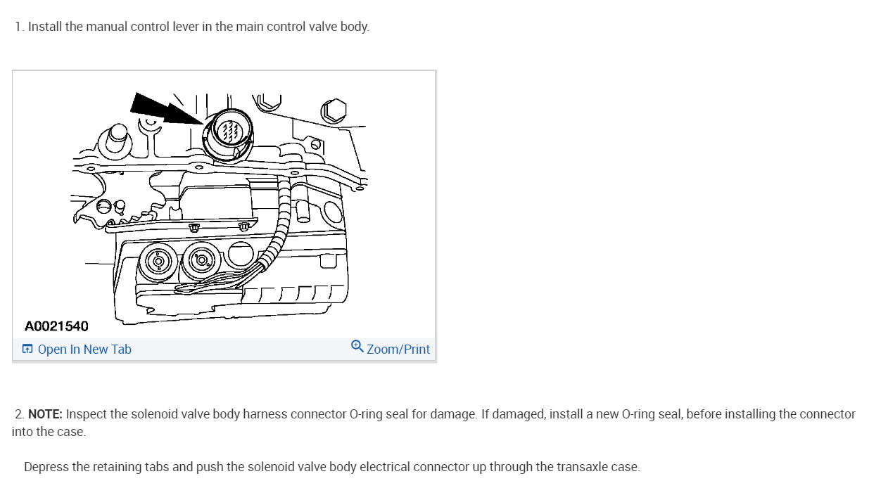

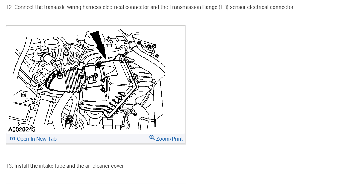

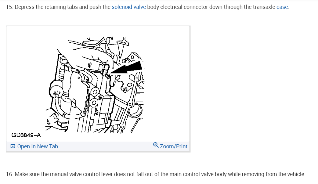

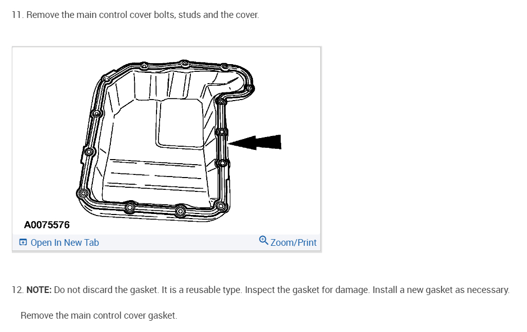

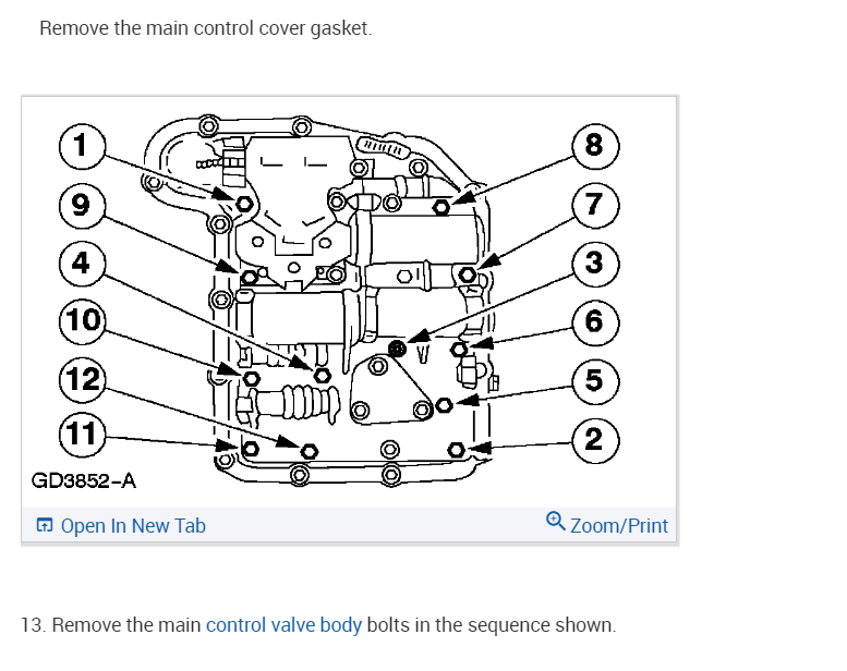

So, this can be one of two problems, either the torque converter has fallen apart internally or the TCC solenoid needs to be replaced. We should run the codes to see what comes up.
To replace the torque converter the transmission will need to be removed. Here is how to change out the TCC solenoid. Check out the images (below). Please let us know what happens. If there are no codes, chances are the transmission will need to be removed and rebuilt.
Jul 31, 2023 at 5:29 AM

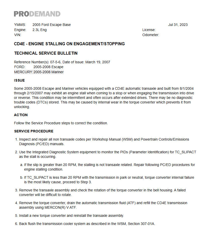

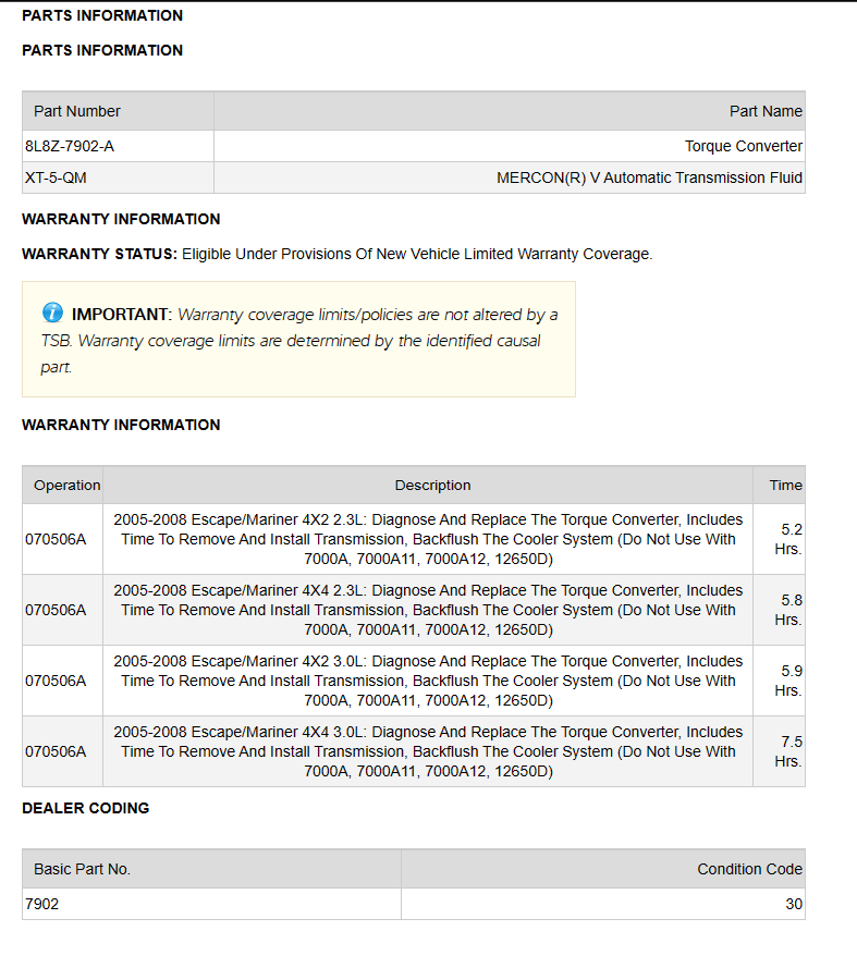

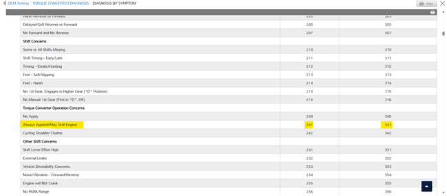

Hello DANIELLE2018,

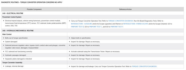

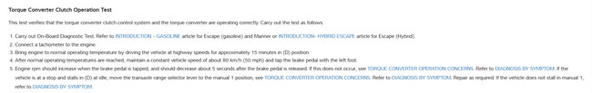

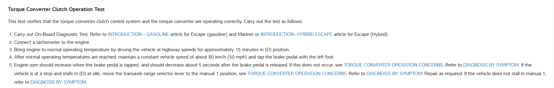

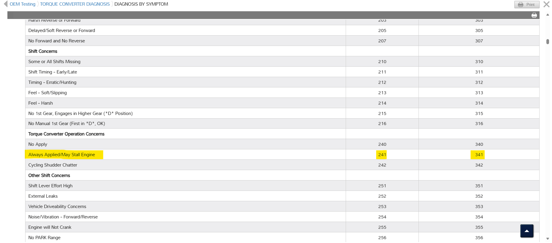

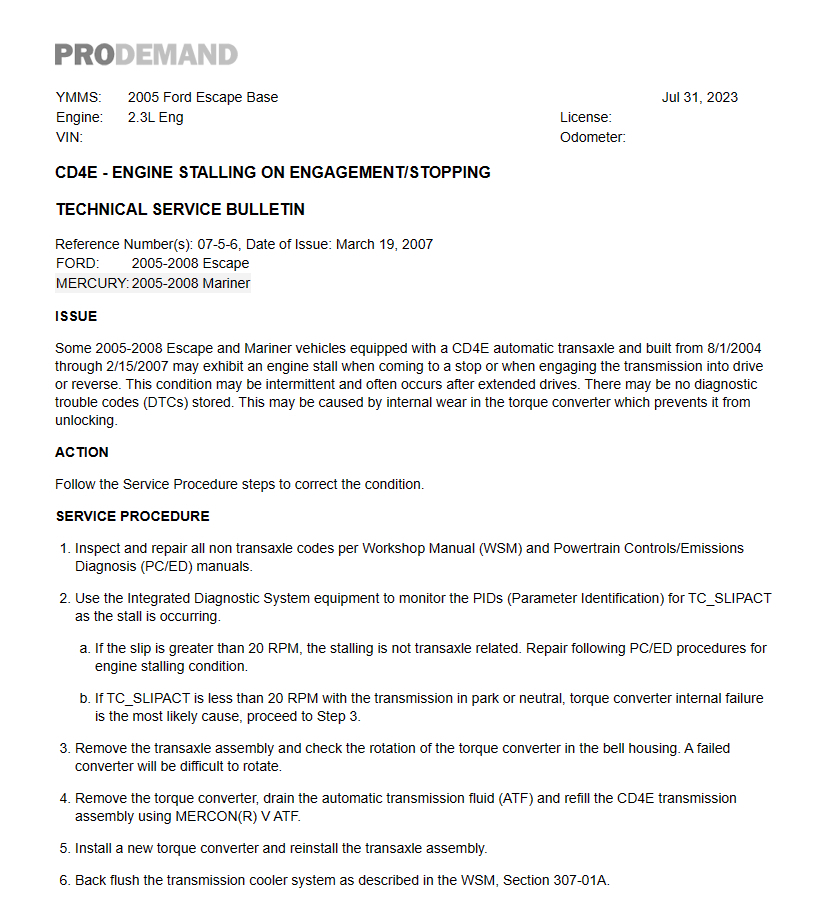

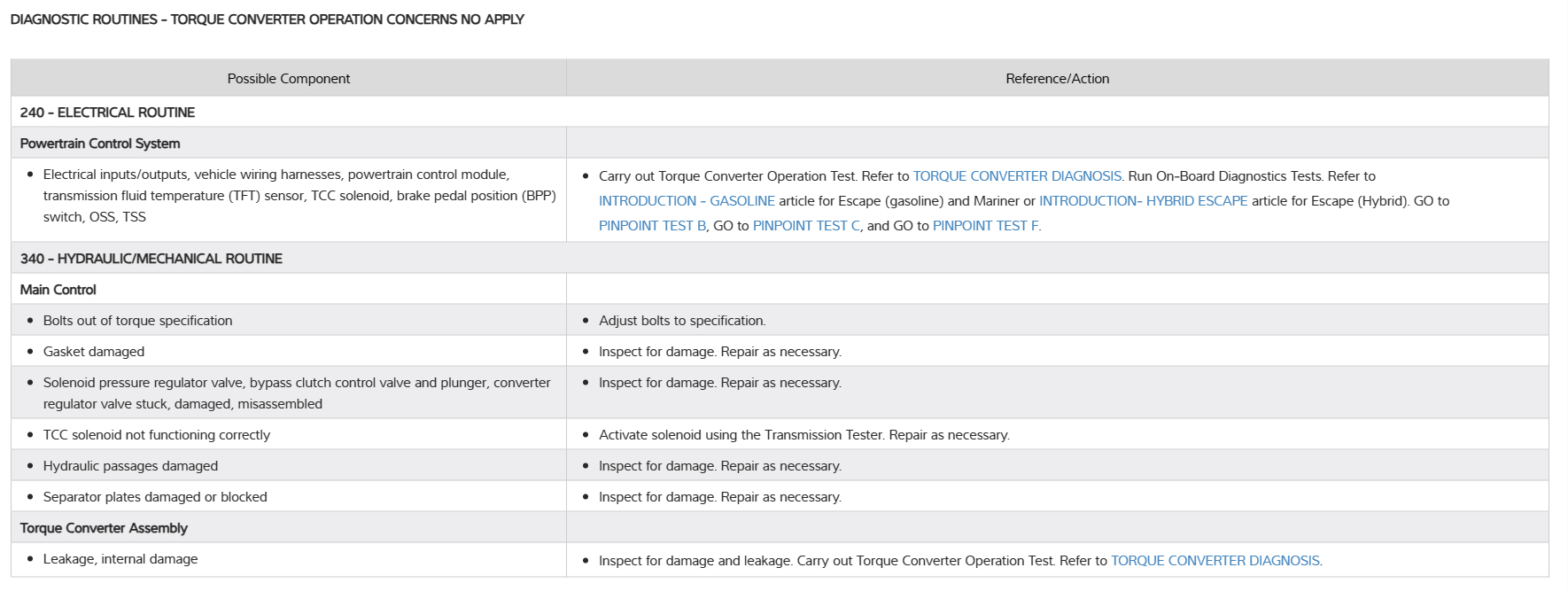

Sounds like it might be the torque converter locked up.
I actually found a Technical Service Bulletin or TSB on this exact issue from Ford. I have added screenshots of it for you.
You will need a scan tool capable of monitoring the speed of the input shaft on the transmission according to Ford.
I have added a lot of extra information for you as well.
Also here is a link with some other helpful information:
Thank you,
Brendon

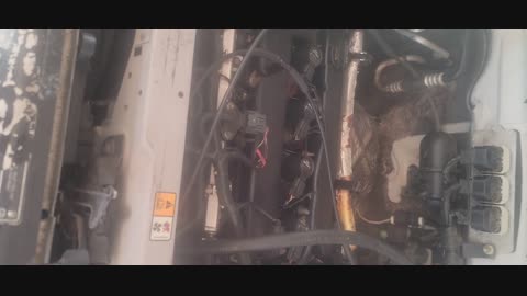

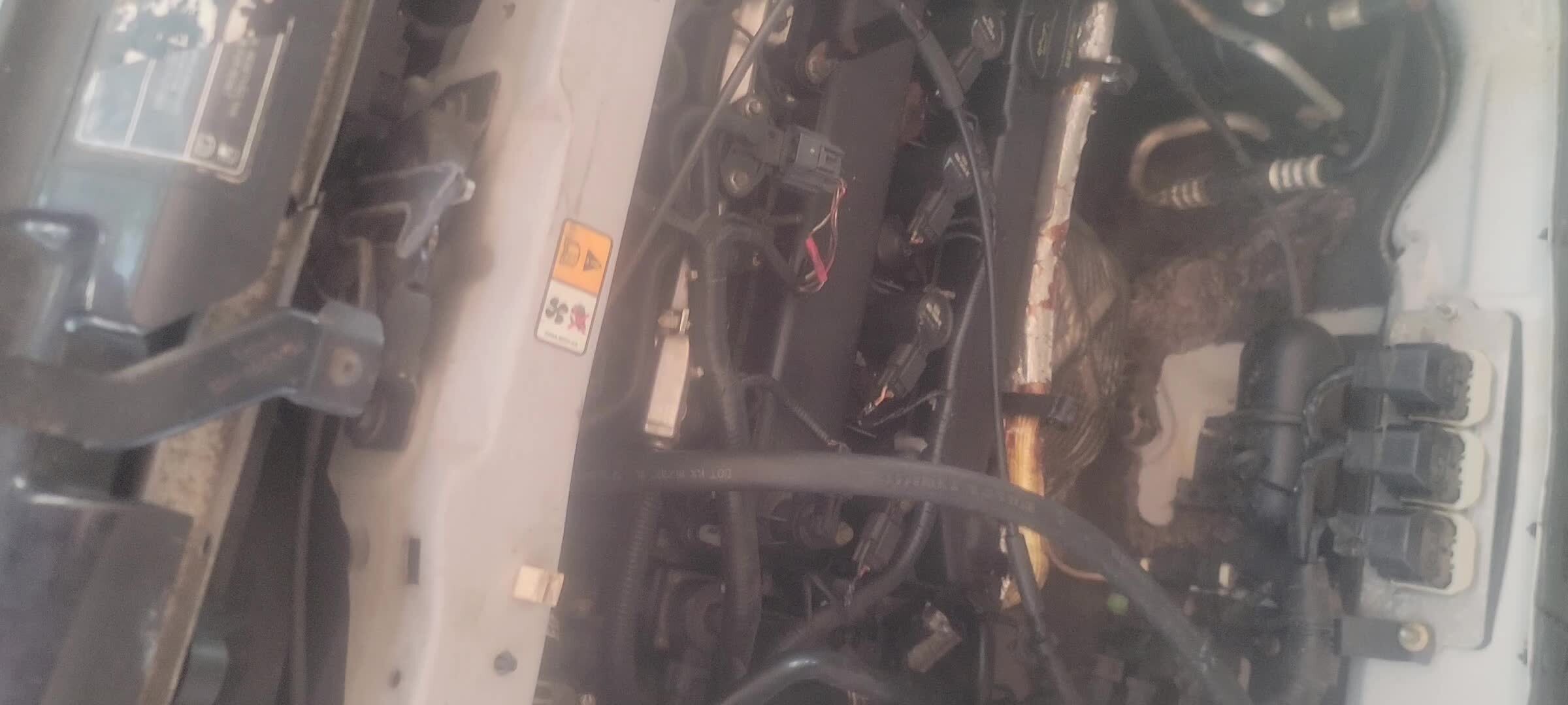

I got my daughter to crank it while I listened, and I didn't hear anything but I'm no mechanic. So, I'm going to try to upload the video, and could you tell me what you think please. Sorry and thank you.
Aug 6, 2023 at 7:04 AM
BRENDON S
  • 653 POSTS
Hello DANIELLE2018,
I didn't hear anything when it was running but thought I heard a hiss or whistle right after it was switched off at about 40 seconds into the video.
That could be a vacuum leak.
Try this test on rubber hoses, intake, throttle body, brake booster and any other places motioned in this article. It also includes a video.
Now since we don't have a loud whistle as seen in the video, what is going to happen is you are going to spray one area at a time and see if the engine increases speed. It will sound like someone touched the gas a little. This is because this spray is flammable if there is an intake leak it will get sucked into the engine adding fuel and increasing the engine speed or RPM a little.
Try it out and see what you find. Since you described having to mash the brakes, I would try around the brake booster first.
It may take a sec or 2 for the engine to respond to the extra fuel so spray a little then wait.

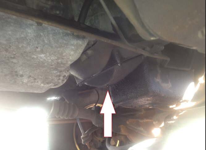

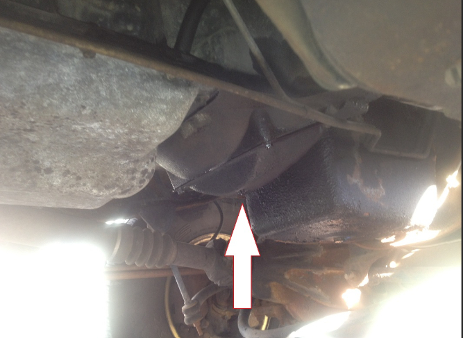

I haven't been able to get the escape worked on yet, but I had to crank it to jump off my other vehicle and I revved it just a little bit then i noticed fluid under the truck and all my transmission fluid leaked out. Why? Just in case this helps the transmission fluid looked good, wasn't burnt or nothing. Thanks in advance.
Aug 29, 2023 at 7:17 PM
BRENDON S
  • 653 POSTS
Hello DANIELLE2018,
Sounds like the torque converter is leaking, probably from the seals. Especially because of the amount that it sounds like leaked out.
This could be an issue with the torque converter itself or premature failure due to another issue like the TCC solenoid as Ken mentioned above.
The torque converter will need to be replaced so the transmission will need to be removed. But the transmission will need to be tested to make sure it doesn't have any internal damage that could put you in the same situation down the road.
Can you see where it is leaking from? I have added an image for you. This may not be your exact set-up, but the area will be the same. The roundish area is called the bellhousing and inside of this is where the torque converter is located. If it is leaking, it will be soaked at the bottom of this roundish area, the bellhousing or very close to it.
