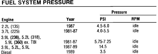

Since this started with the replacement of the fuel pump, the first thing you need to check is fuel pressure. Just because it is a new pump doesn't mean it's good.
Here is a link that shows in general how to check fuel pressure:
I attached a picture. It shows the manufacturer's specs for pressure and is the last one listed. Keep in mind, if you didn't replace the intake fuel filter, it could be blocking.

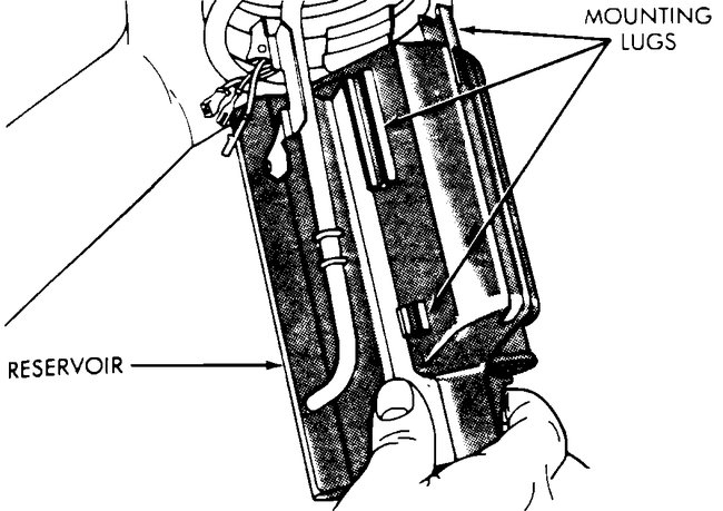

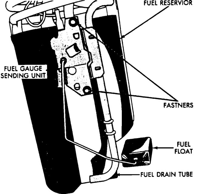

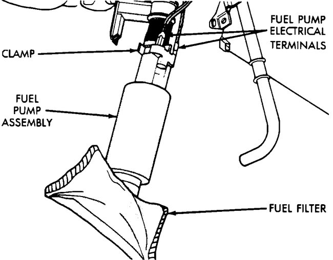

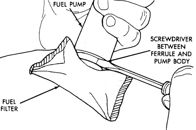

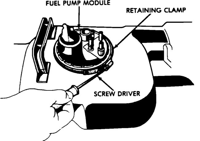

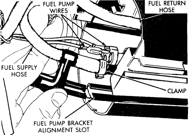

Here are the directions for pump replacement. I am adding them for you to confirm you did everything correctly. The attached pictures correlate with these directions.
_________________________________________________________________
FUEL PUMP/FUEL GAUGE SENDING UNIT REPLACEMENT
REMOVAL:

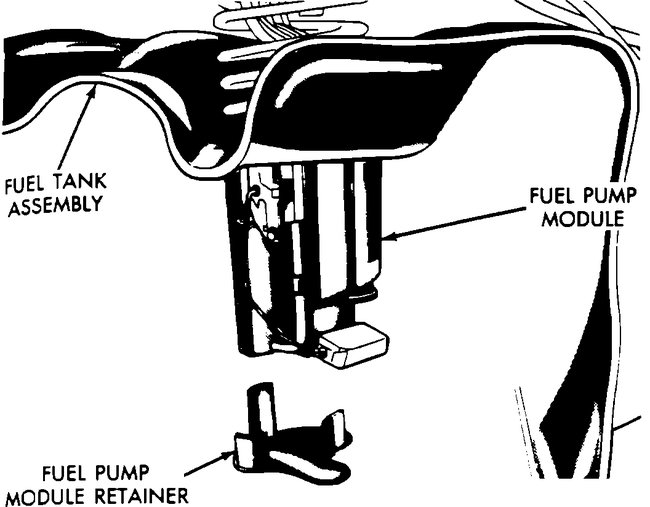

Fuel Pump Module Removal/Installation
Picture 1
1. Fuel system pressure must be released prior to service.
2. Fuel tank must be removed prior to fuel pump service.
3. While holding the fuel pump module down, remove the retaining clamp. After the clamp is removed release the fuel pump module and it will spring up from the fuel tank.
4. Remove the fuel pump module from the fuel tank.

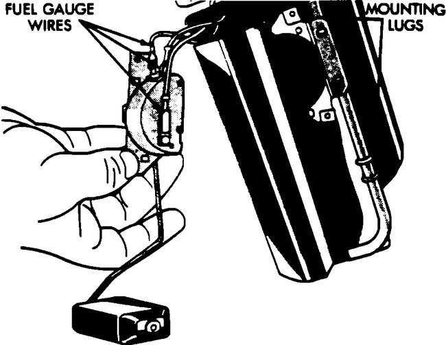

Fuel Gauge Sending Unit Service
Picture 2
1. Remove sending unit attaching screws from mounting bracket located on the side of the fuel pump reservoir.
Fuel Gauge Sending Unit Wiring Terminals
Picture 3
2. Disconnect electrical connections from sending unit, and remove sending unit.

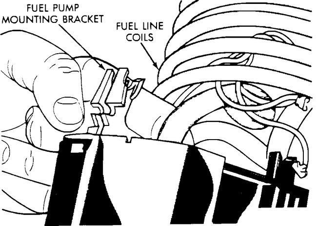

Removing Fuel Line Coil From Reservoir
Picture 4

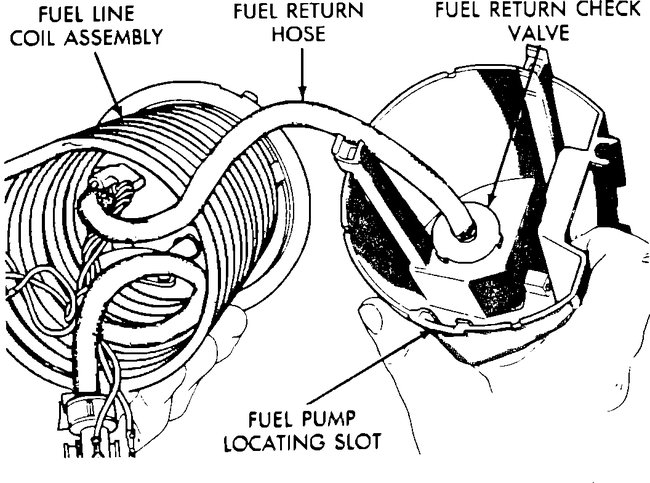

Fuel Pump And Reservoir Assembly
Picture 5
3. Remove drain tube from the side of the fuel reservoir. Be careful not to let the fuel return line and check valve come detached from the inside of the reservoir.

Fuel Pump Removal/Installation
Picture 7
4. Remove the fuel pump assembly by pressing on the mounting bracket with your thumb and forefinger. Press with both thumbs toward the center of the fuel reservoir.
Servicing In-Tank Fuel Filter
Picture 8
5. Remove pump mounting bracket and rubber collar from hose and retain for assembly. Cut the hose clamp from the supply hose and discard. Remove pump/strainer assembly from hose.
Picture 9
6. If fuel pump is functioning properly but fuel strainer is defective, use a broad blade screwdriver and "walk" around the strainer mounting ferrule to remove it from the fuel pump. Be careful not to damage the fuel pump inlet. If fuel pump is defective, replace both the pump and filter.

Keep in mind, even a kinked hose can cause this type of issue, so reinspect your work.
Let me know if this helps.
