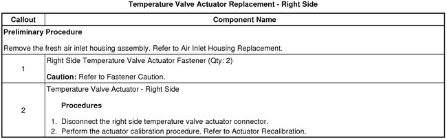

This just started happening today, all of a sudden the A/C was only blowing cold air in the driver side, and hot air in the passenger side. The hot air seemed like if the heater was on. It is extremely hot air. I double checked the climate controls and they were both set to the coldest, but only one side blows cold air.
Sep 11, 2019 at 4:02 PM
  • 110,244 POSTS
Welcome to 2CarPros.

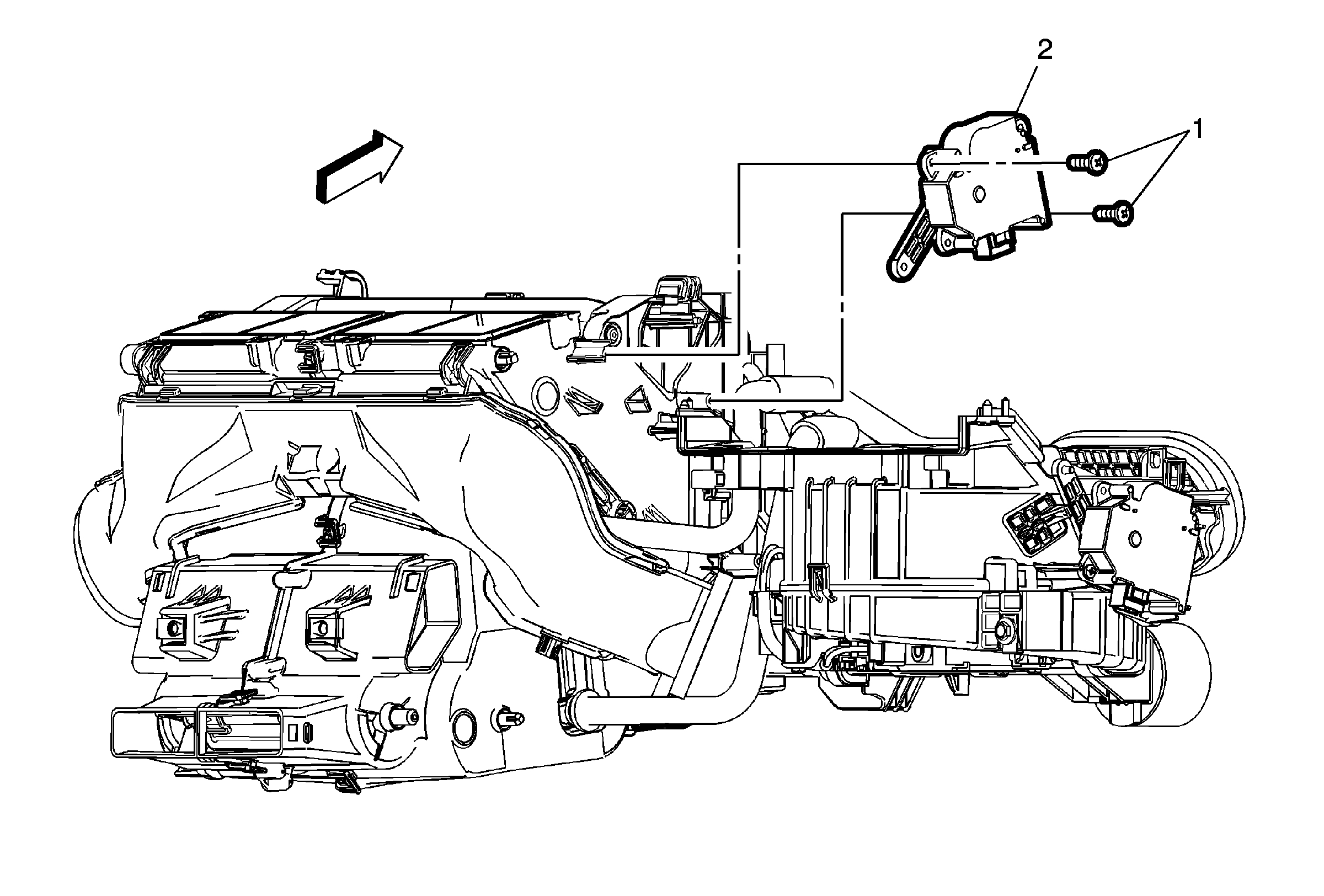

Chances are the air temp actuator is bad and not opening the blend air door to the right position. The air temp actuator (blend air door actuator) is responsible for the air temp entering the vehicle. Since you have dual climate control, there are two, one for the left and one for the right.
Take a look through this link. It explains how, in general, one is replaced.

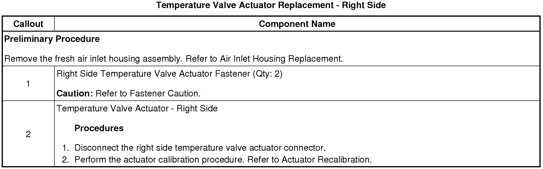

If you take a look at pics 1 and 2, they show the location of the actuator for the right (passenger side) of the vehicle. Pic 2 are the directions for replacement.
Once the new part is installed, you will need to recalibrate it.Normally a scan tool is used. However, it can be done without one. Here are the directions for without a scan tool:
