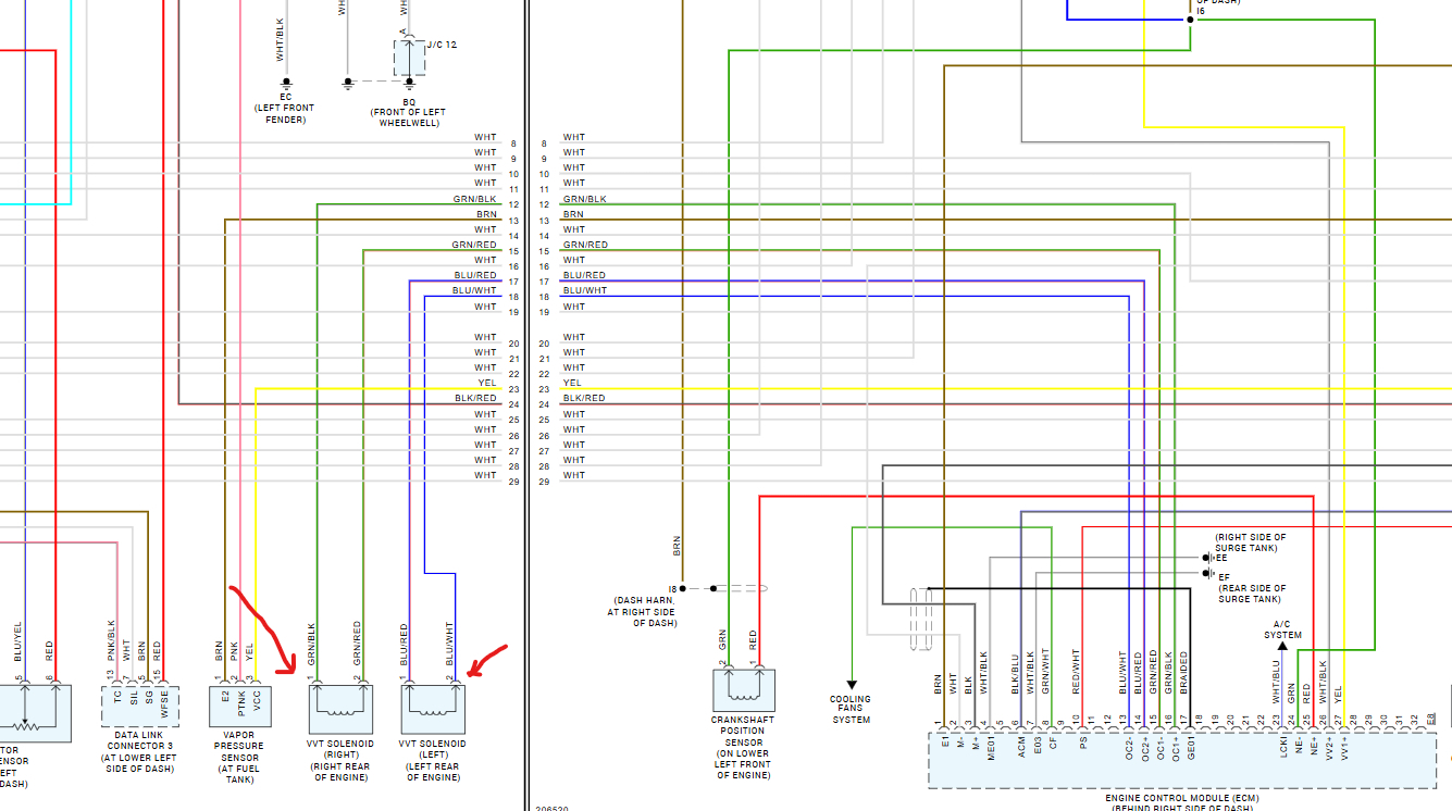

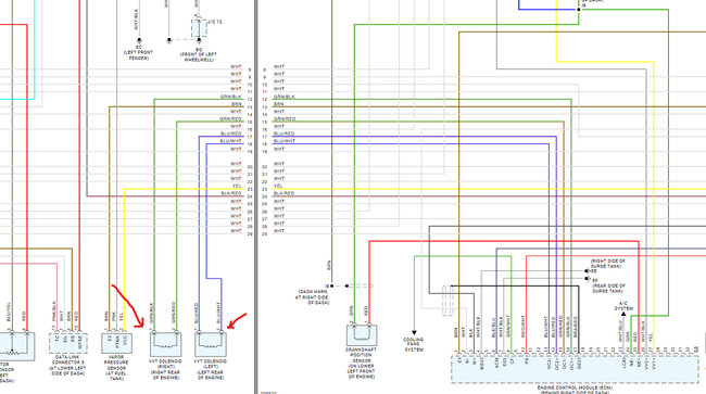

Yep, you are correct, with a Camshaft Position Actuator Control Circuit/Open Bank 1 means there is a connection problem, here is a guide to help you test the wiring. Most of the test will be the sensor of valve but since you already did that, it narrows it down nicely.
Thanks for the detailed question, it helps. Check out the images (below). Please let us know what happens.

So, an additional note when I went to check the voltage with KOEO at both VVT solenoid terminal plugs I got the following:
Bank 1 - Green/red wire =0V
Bank 1 - Green/blk wire = 11.7V (which I didn't have before this time)
Bank 2 - Blue/Red wire = 10V
Bank 2 - Blue/White wire = 11.75V
However, when I cycled the key to off then KOEO again to clear fault then perform a new DTC scan I was rewarded with new DTC's...they are as follows:
P0010 (OLD)...NEW: P0020, and the crowed pleaser of P0748.
When I checked the terminals for voltage again power was, (0V), gone except for 1.6V on one of the wires to Bank 2 VVT solenoid. Not sure what this is trying to indicate but right off the cuff my thinking is I have 3 choices:
1.) SL1 solenoid shares a power source with the VVT solenoids?
2.) Computer screwed up again?
3.) Wiring is way worse than I thought?
My electrical knowledge is limited but I’m trying to think this through…not sure how to isolate things now. Please help!

I would unplug the VVT solenoids and the PCM to check the continuity of the connection for the wires only. Don't worry about the outputs yet.

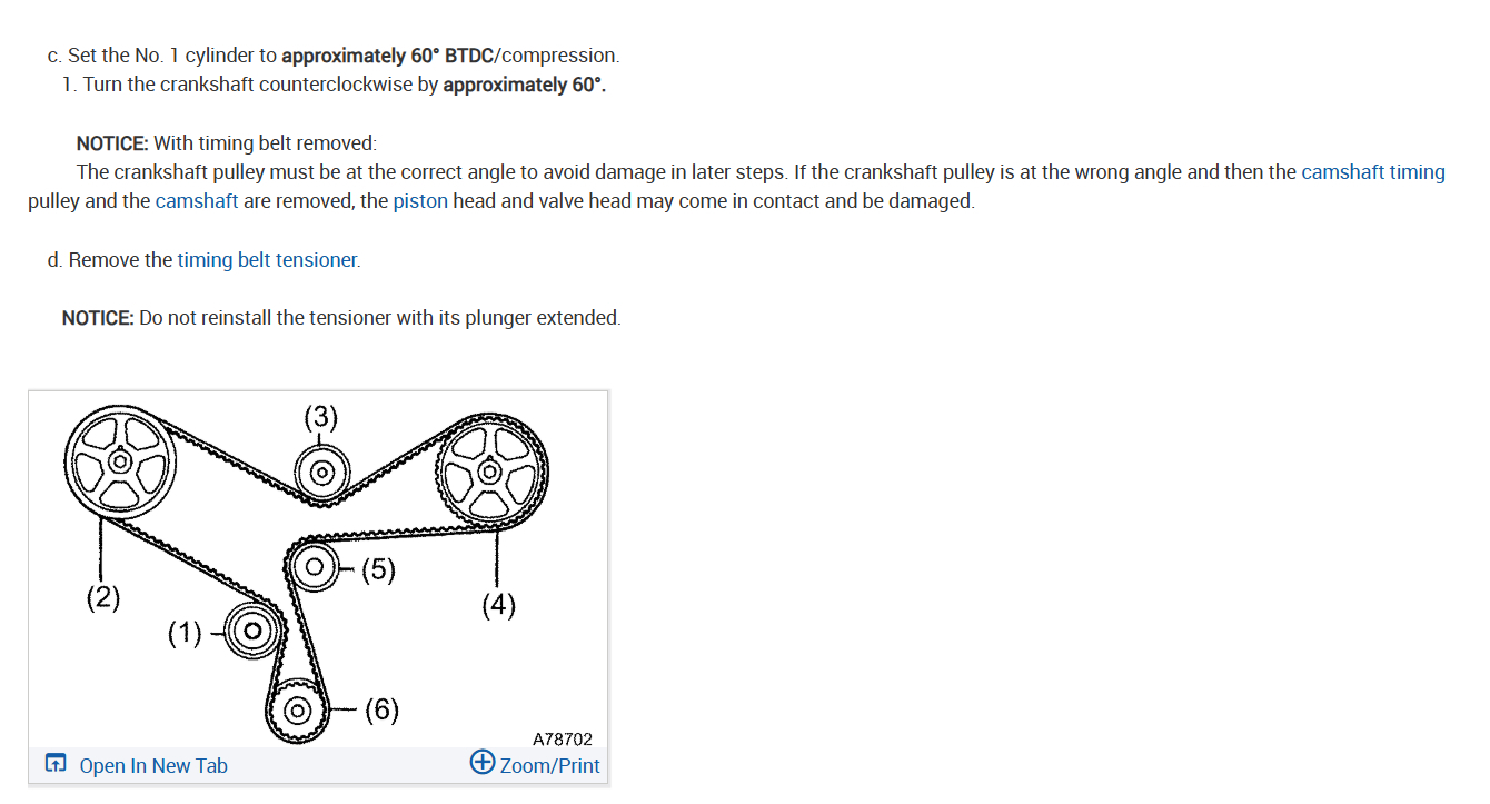

So I don't get the circuit open code just a circuit code which means the expected sine wave is off which usually means there is a problem inside the engine, IE: timing chains, camshaft actuators, the oil control valves might be clogged or the engine oil is dirty/low and needs to changed, does the engine make a slight rattling noise while running at idle?
Code: P0010 - "A" Camshaft Position Actuator Circuit (Bank 1)
Mar 7, 2025 at 1:17 AM
LARRYCV7
  • 9 POSTS

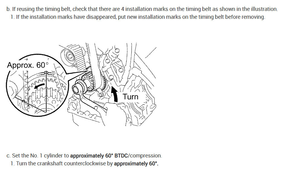

I bought this car second hand, so I was doing preventive maintenance in that I replaced the timing belt, tensioner, idler pulleys, cam shaft seals, and the valve cover seals. I'll go back and recheck the timing alignment marks and see what I find. Thought the ECU would see the difference btw the cam and crank and spit out a code...even it its only slightly off?
As far as the camshaft actuators go (VVT Solenoids - Bank 1 and Bank 2) I tested both the old ones after I removed them. Tested for resistance, grounding out, and applied 12V power to ensure the spindle/actuator actually moved. They passed each test. Additionally, just for time's sake I replaced them with new ones, but nothing changed.
Checked vehicle 4 additional times. Each time the key was turned to KOEO the OBD II would display combination of DTC’s. Sometimes displaying all four codes (P0010, P0020, P0712, and P0748). Other times it’d display varying combinations of those 4 codes. Rechecked voltage with KOEO at VVT solenoid plugs and received a range of voltages (12V - 1.6V). Same issues were noted for the P0712 and P0748 after recycling the KOEO the DTC may or may not be displayed.
I cleaned every grounding point within the engine bay, they're clean. Not sure if one the grounding wires from the ECU plug to the actual ground point may be messed up? Haven't checked that yet.
Any thoughts?

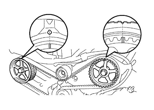

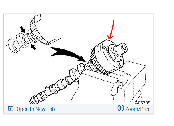

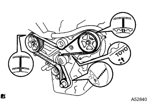

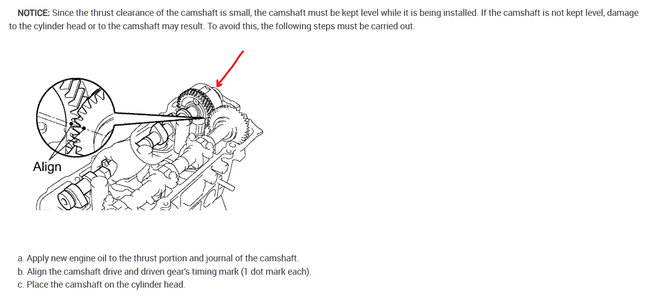

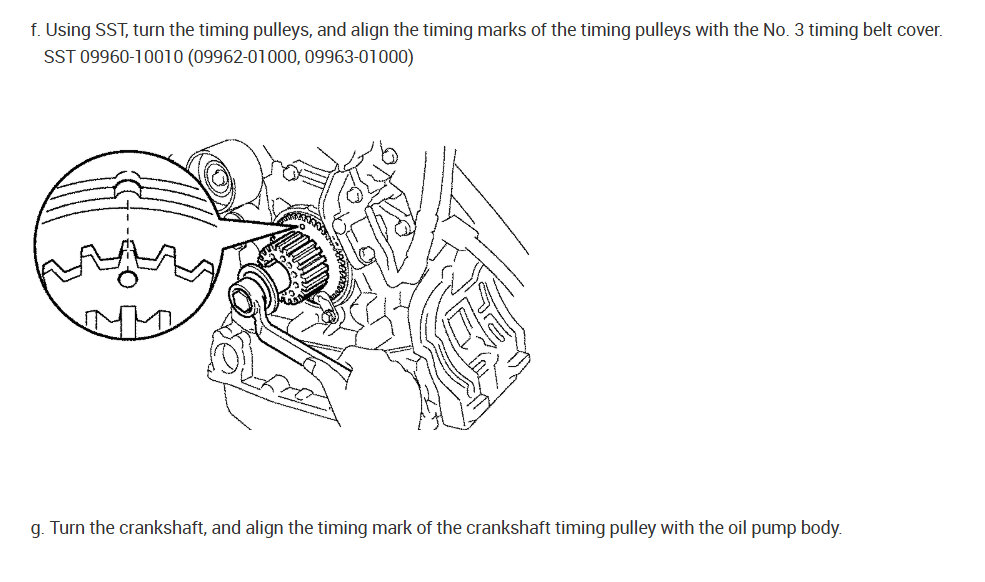

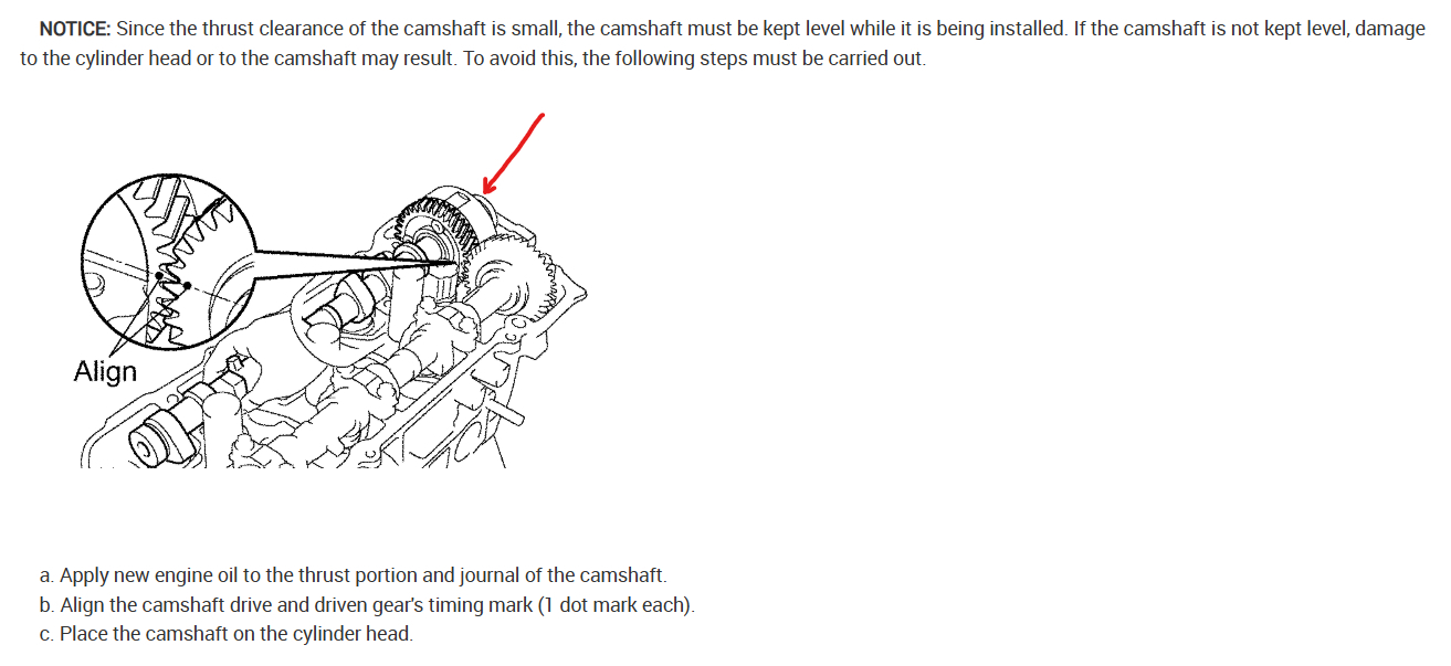

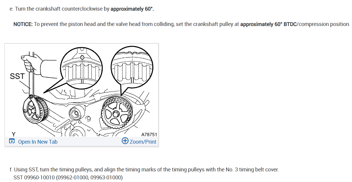

The p0010 code is for the correlation issues. did you change out the camshaft phasers as well? the part on the rear of the camshafts. Here are diagrams to help you check the timing marks for the belt and how to change the phasers out with the timing marks for those as well. Clear the code once completed. Check out the images (below).

You were absolutly right about rechecking the timing. Thank you for that information!
After I removed all the timing covers two inspect the crank/camshaft's alignment marking I did fine the two cam marks were off. Apperently, as I found out on this vehicle when ya set the timing aligment marks ya have to advance it by 1 tooth before pulling the gernade pin on the timing belt tensioner. After doing so it applied tension on the timing belt pulling it back to the proper alinement marks on the cam 2-camshaft markings. It started and I cleared the the codes.
