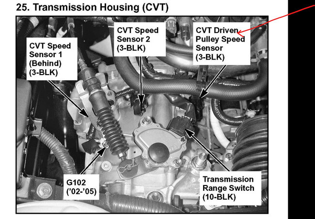

Hello, my car listed above, CVT won't move forward in drive until warmed up. It just revs as if it was in neutral. Then it throws the code p1885. How do I fix this please?
Nov 18, 2022 at 11:23 PM
  • 55,423 POSTS

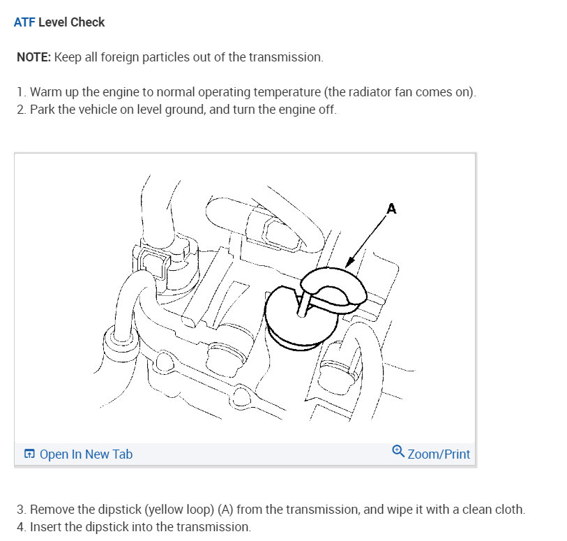

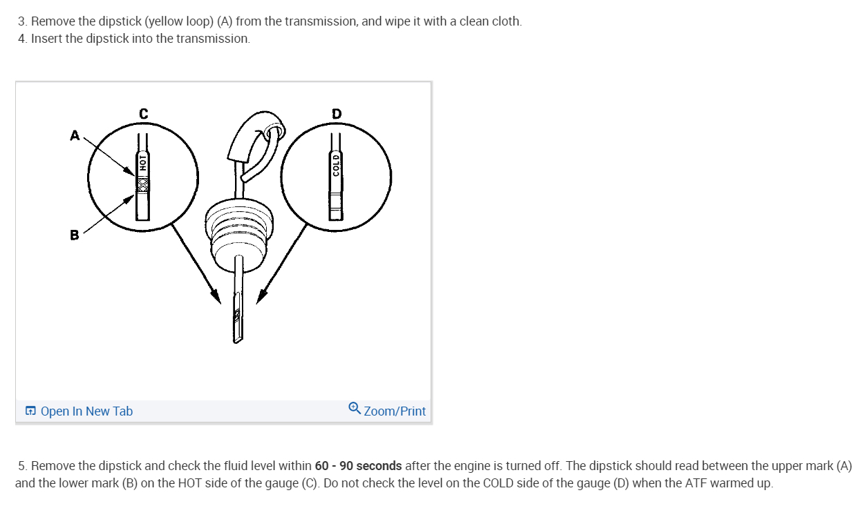

Code P1885 the A/T drive pulley speed sensor circuit open or shorted to ground. The speed sensor needs to be replaced. We should check the transmission fluid as well. If after the fluid has been changed and the speed sensor replaced, and it is still acting up it sounds like the transmission might need to be rebuilt but let's do it one step at a time. Here is the sensor location so you can replace it:
