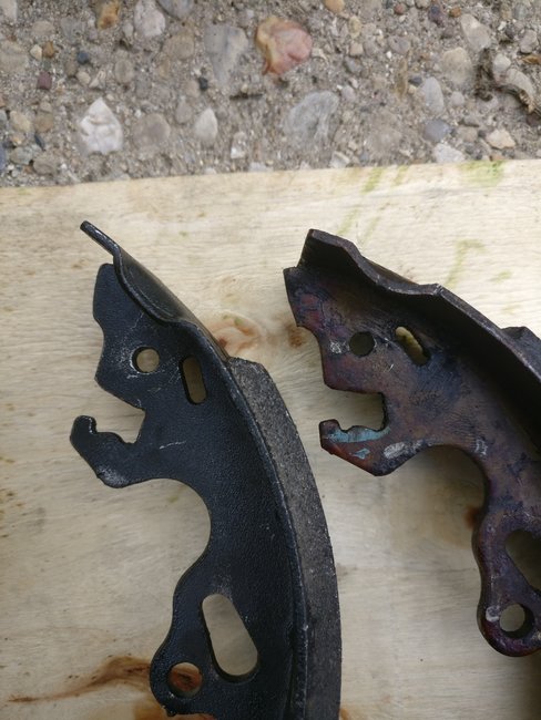

I bought a set of rear brake drums, shoes, and springs. They are Brake Best and are for a 2010 Ford Focus SE. I'm having a hard time getting the springs to fit into the slots they go in. I got most of them, but one particular hole seems to be too far away for the spring to get into. It isn't a matter of stretching the spring, because the actual hook on the spring seems to be too narrow to go in, and widening it with a pliers just makes it slip out easily. I've linked two videos below. Also in the attached picture, you can see the new shoe is slightly wider where the spring hook has to get to. Thanks again.

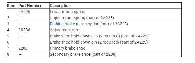

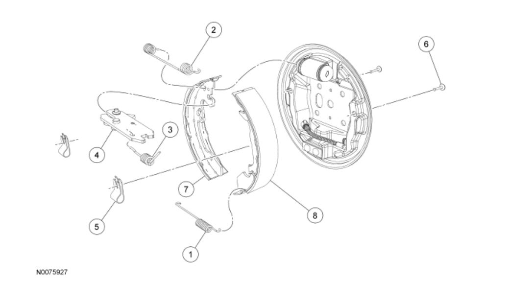

I attached picture of the drum brake system. Can you identify the spring that you cannot attach? There are 2 springs and I need to know which one.

Adjust the parking brake cable. For additional information, refer to Section 206-05 . Check out the diagrams (Below). Please let us know if you need anything else to get the problem fixed.

It looks like it's the Upper Return Spring.
Jul 10, 2020 at 11:55 PM
That spring is a tough one to get. You have to collapse the adjuster assembly to bring the shows close together. then use can attach the spring much easier.
