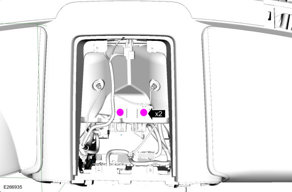

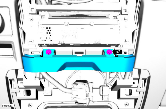

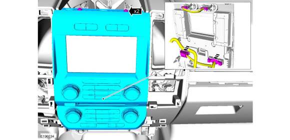

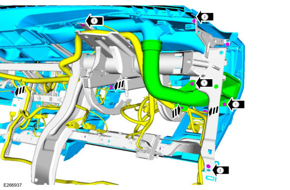

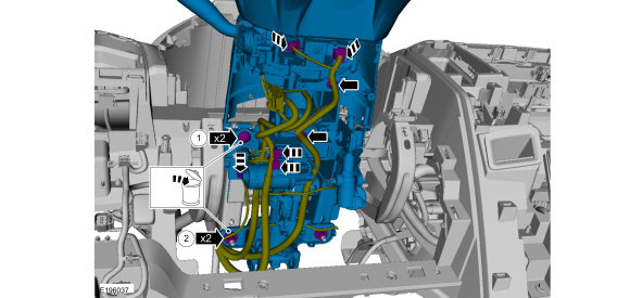

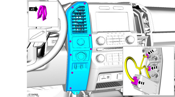

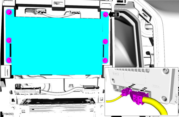

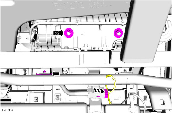

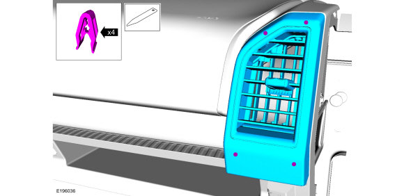

My fiance took her engagement ring off when we went surfing the other day. Came back to the car hit a bump on the way back to our apartment and the ring popped out of the dash holder and into the dash vent on the passengers side up by the windshield. How can i remove the entire dash so that i can just reach down and grab it out?

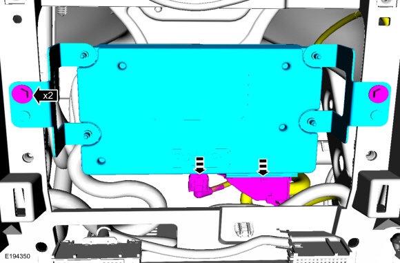

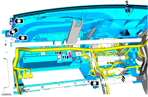

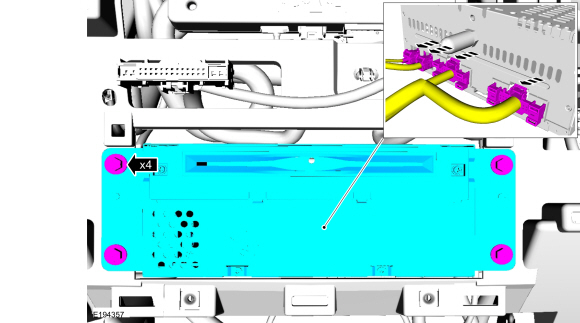

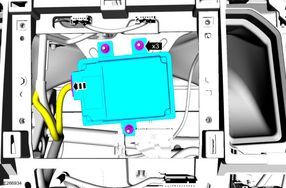

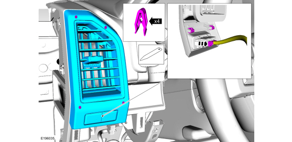

I have a feeling you aren't going to like these directions, but here they are. The attached pics correlate with the directions.
Instrument Panel Upper Section

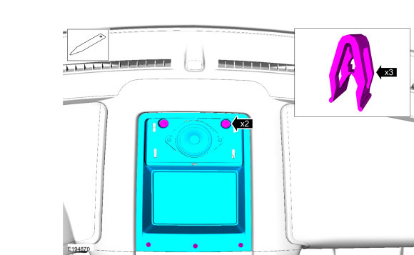

NOTE: Upper instrument panel storage tray with speaker shown, others similar.
If equipped, release the clips and remove the instrument panel speaker grille.
Use the General Equipment: Interior Trim Remover
Remove the bolts, release the clips and remove upper instrument panel storage tray.
Torque : 22 lb.in (2.5 Nm)
Pic 1

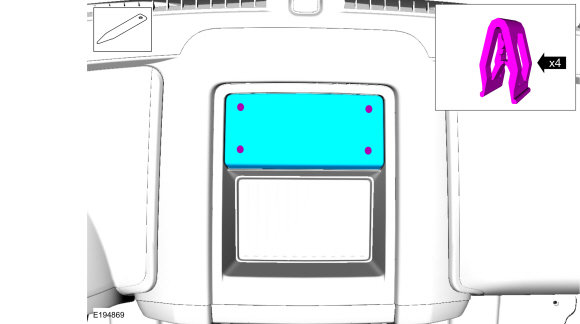

Release the clip and remove the GPSM .
Disconnect the electrical connector.
pic 2

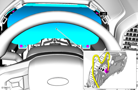

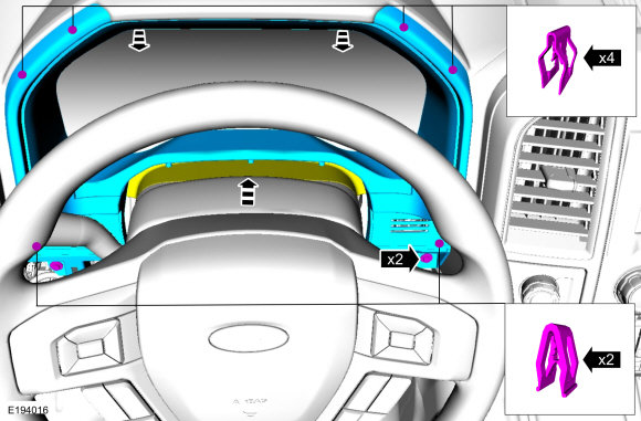

Remove the 2 bolts, release the clips and remove IPC trim panel.
Detach the gap hider from the upper steering column shroud.
pic 3

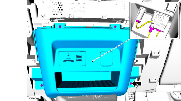

Remove the bolts and the IPC .
Torque : 21 lb.in (2.4 Nm)
pic 4

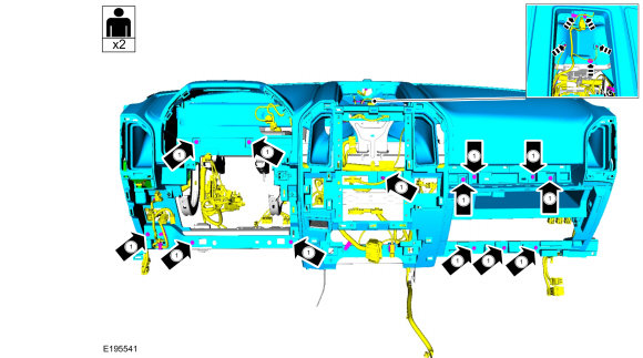

NOTE: FCIM with touchscreen shown. FCIM without touch screen similar.

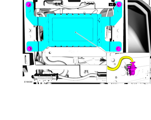

Remove the bolts and the FCIM .
Disconnect the electrical connectors.
pic 5

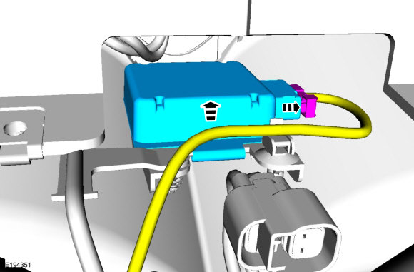

NOTE: Instrument panel center trim panel without floor console shown, with floor console similar.

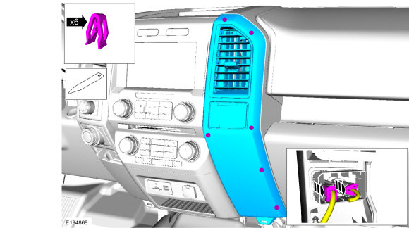

Release the clips and remove the RH instrument panel center trim panel.
pic 6

Vehicles without touchscreen
Remove the bolts and the FCDIM .
pic 8

Vehicles with touchscreen
Remove the bolts and the FDIM .
pic 10

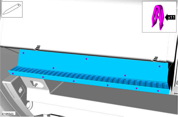

Vehicles without floor console
Remove bolts and the lower instrument panel finish panel.
Torque : 48 lb.in (5.4 Nm)

Release the clips and remove the RH register finish panel.
pic 15
Release the clips and remove the RH finish panel.
pic 16

pic 19
NOTE: The HVAC plenum may need to be positioned upward to access bolts.
Remove the bolts.
Torque : 49 lb.in (5.5 Nm)
