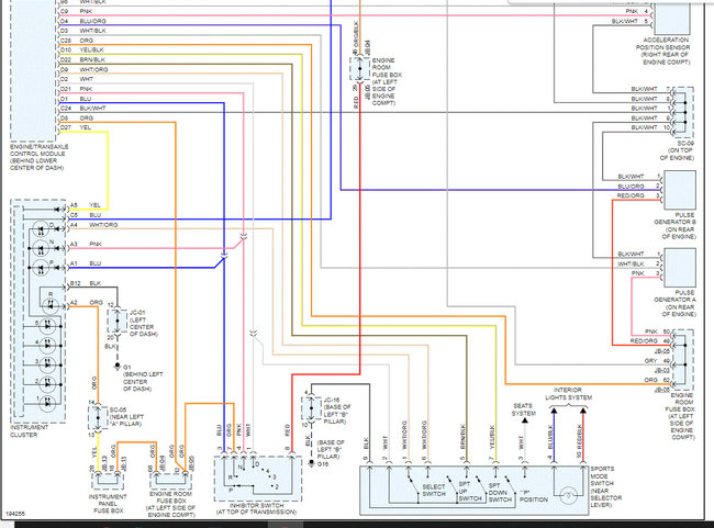

Sport light on dashboard and ESP. car is driving a single gear only and vibrates the whole car badly when shift to reverse gear. Code p1723, p0225, p1151 and p0325. Problem occurred after engine was removed.
Sep 2, 2021 at 12:44 AM
  • 110,194 POSTS
You have a couple of different areas of concern. The 1723 deals with the transmission control relay system. The 325 is related to the knock sensor, and the other ones are related to the accelerator position sensor.

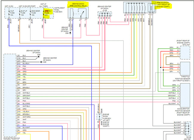

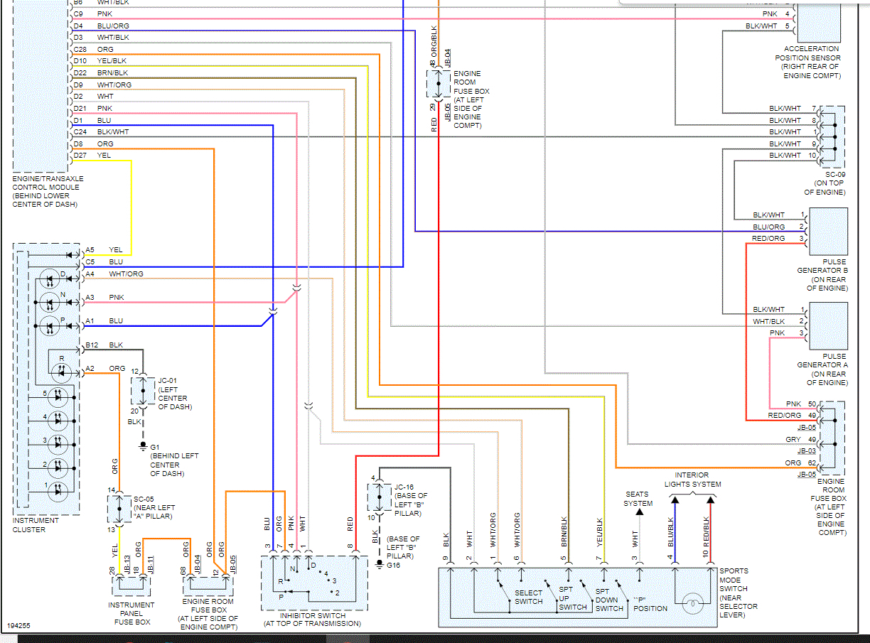

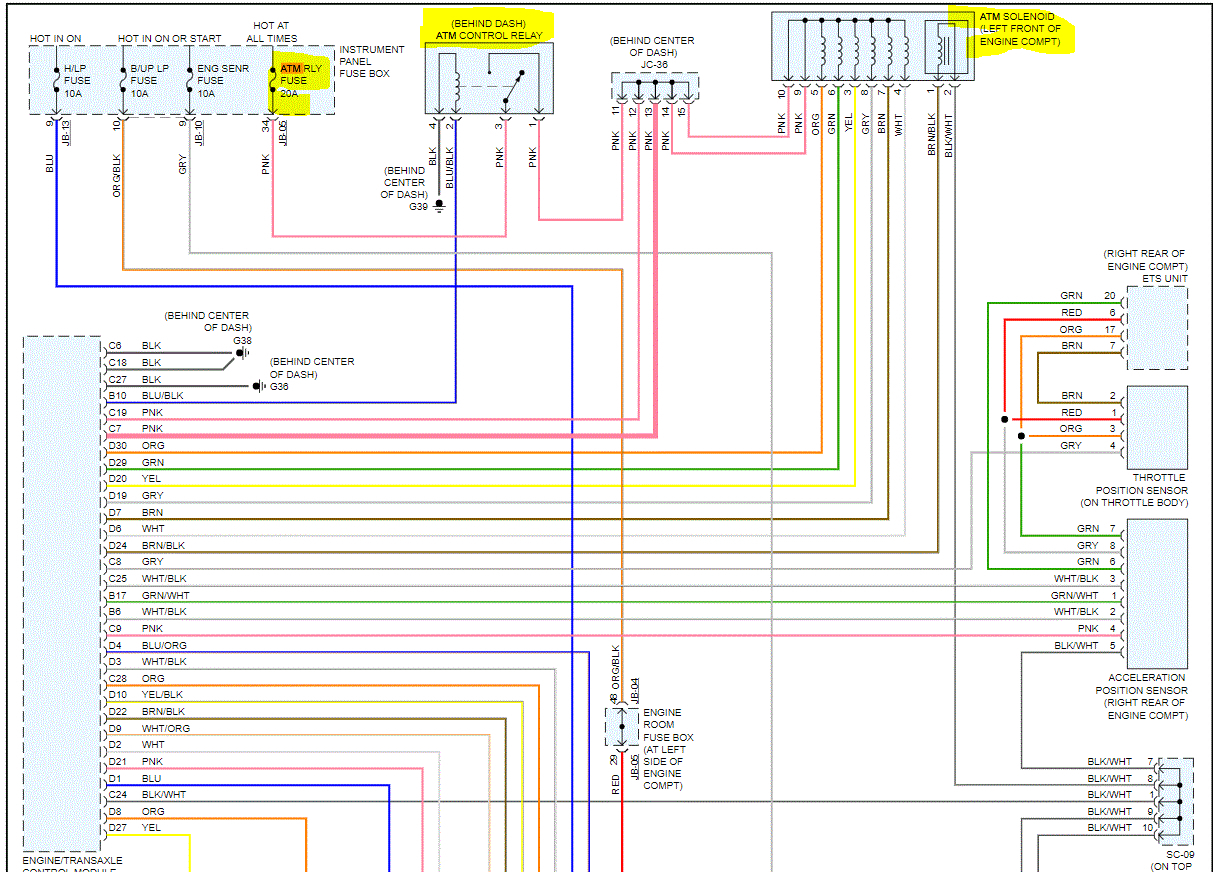

Since it won't shift, let's start with the 1723. First, I attached the wiring schematic below for the transmission circuits. I had to cut the pic in half to make them readable, but I did overlap them so you can follow from one to the next.

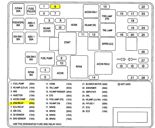

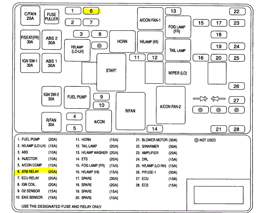

First, check the ATM fuse I believe in the under hood fuse box. The schematic indicates it is in the vehicle, but when I check the fuse box, it shows it in the under hood fuse box. In addition to checking the fuse, confirm there is power to and from it. Here is a link you may find helpful:
If that checks good, locate the ATM relay under the dash on the driver's side. Here is a link that explains how to test a relay.
If the relay tests good, check the connection for damage, corrosion, or a loose pin.
Pic 3 below shows the fuse in the under hood fuse box.

For a certainty you are a pro. The man called me today and when I checked the fuse in the engine bay it was blown and cleared the code as well using a friend's programming machine the gear changed. Thank you, sir, for your assistance.
