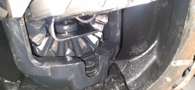

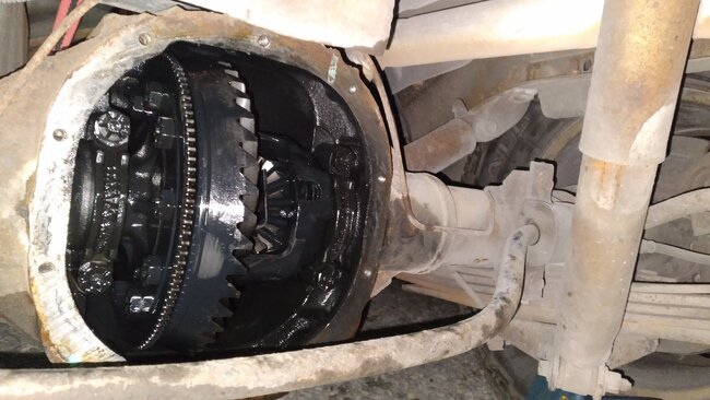

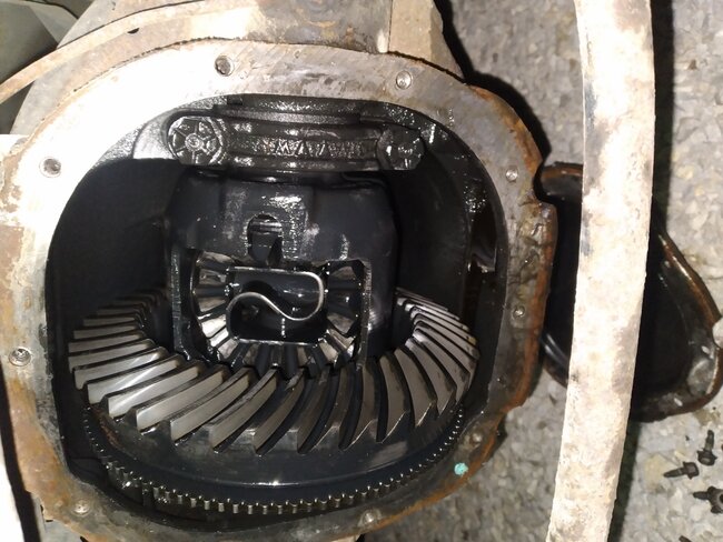

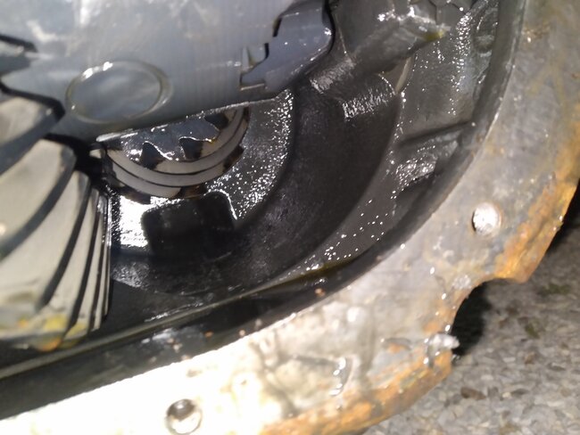

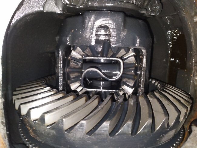

It's very loud, sounds like someone is hitting the floorboard with a sledgehammer. I pulled the rear diff cover off and didn't see any metal shavings or any broken gears. The ring and pinion looked good, but some of the spider gears looked pitted. I dropped the front driveshaft, and the noise was still present. It only happens under load, and occurs when driving straight, not necessarily when turning. I engaged 4x4 and the noise was still there in 4HI, but not in 4LO. It's the vehicle listed above with 4:10 limited slip rear end.
