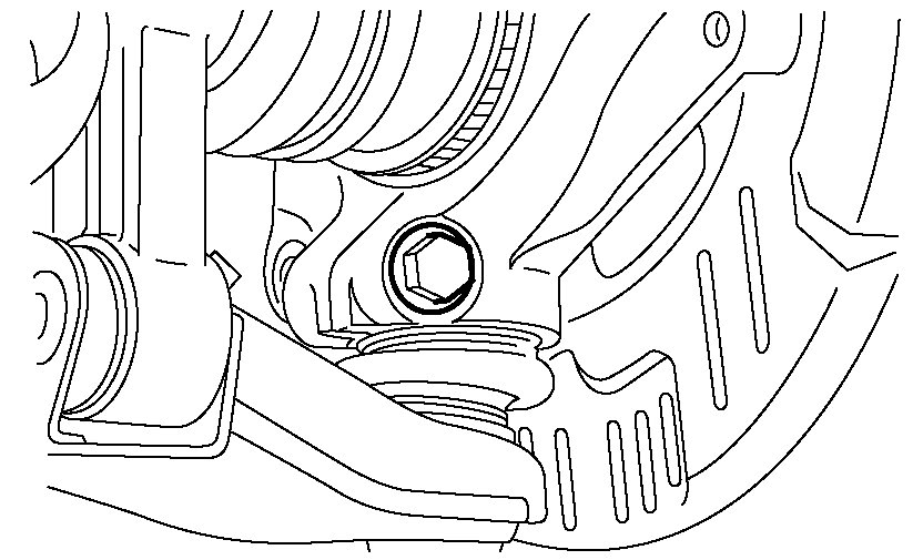

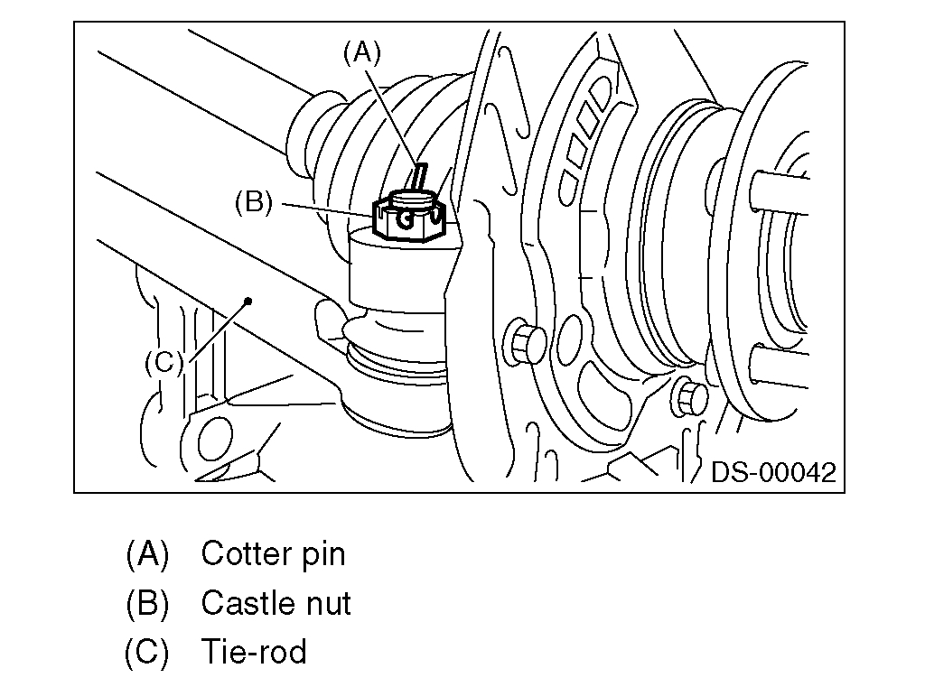

When taking corners accelerating there is a pop and chucking sound, you can feel it. It feels like almost as if I would imagine it would be like driving on a welded differential almost.
Mar 20, 2019 at 5:28 AM
BRYANDEARSTYNE
So I unplugged all wheel drive fuse and the sound has stopped for the most part.
Mar 20, 2019 at 6:54 PM

The first suspect since it happens on turns is a bad CV joint. Take a look through this link and let me know if it mirrors what you are experiencing.
https://www.2carpros.com/articles/symptoms-of-a-bad-cv-axle-joint
Next, place the vehicle in park, put the parking brake on, and craw under the front and grab onto the axles, one at a time. See if there is any play in the axles. Id you find there is, replace the half shaft which is both CV joints and the axle. Here is a link that shows in general how one is replaced:
https://www.2carpros.com/articles/replace-cv-axle
Here are the specific directions for replacement for your vehicle. The attached pictures correlate with these directions.

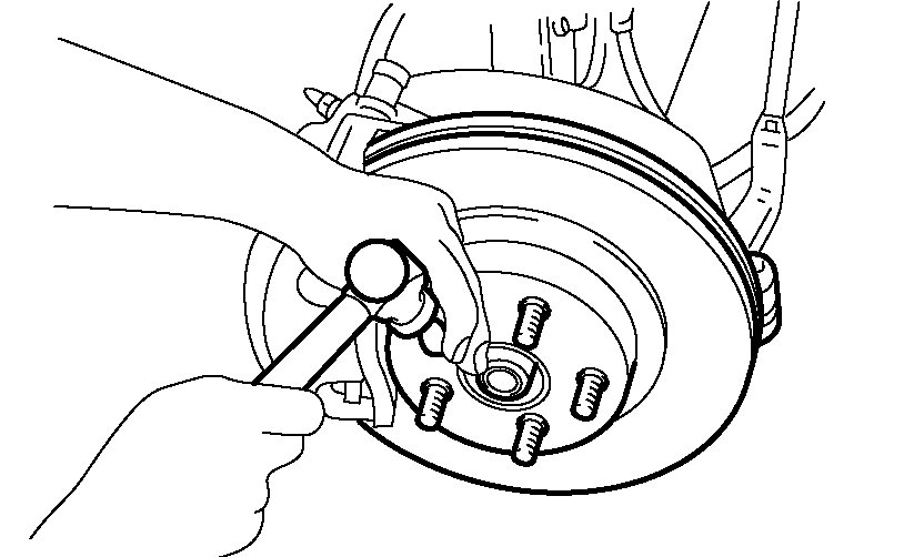

3) Remove the axle nut using a socket wrench while depressing the brake pedal.
CAUTION:
Remove the axle nut with vehicle weight not applied on axle. Failure to follow this rule may damage the wheel bearings.

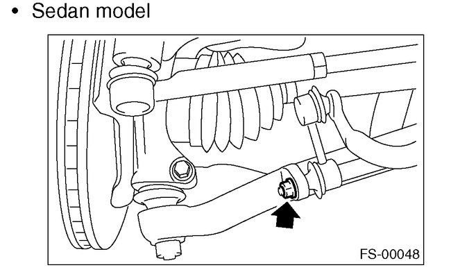

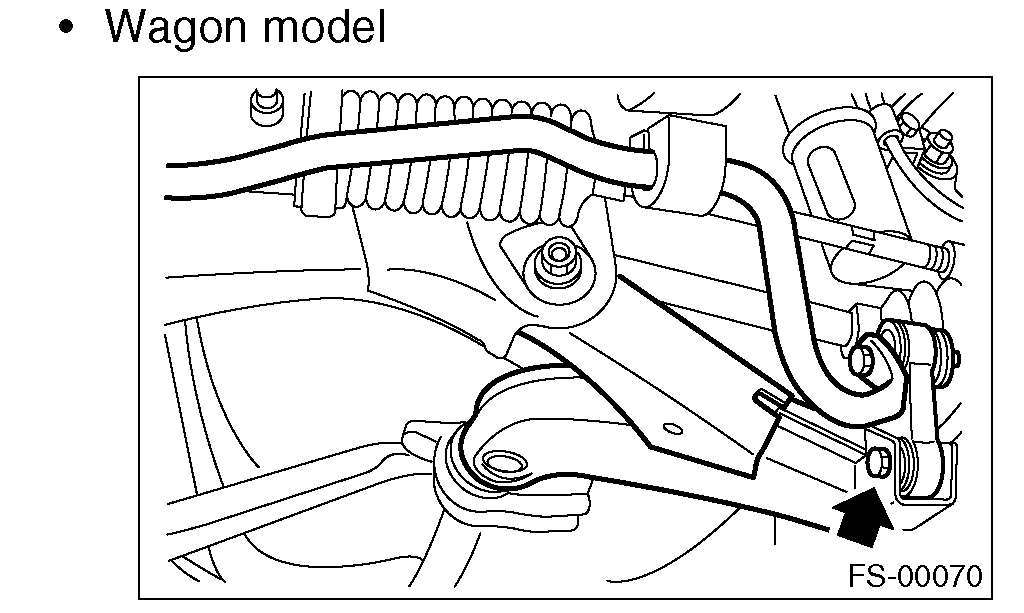

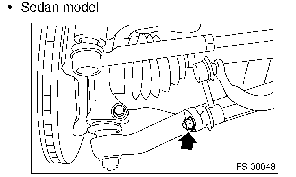

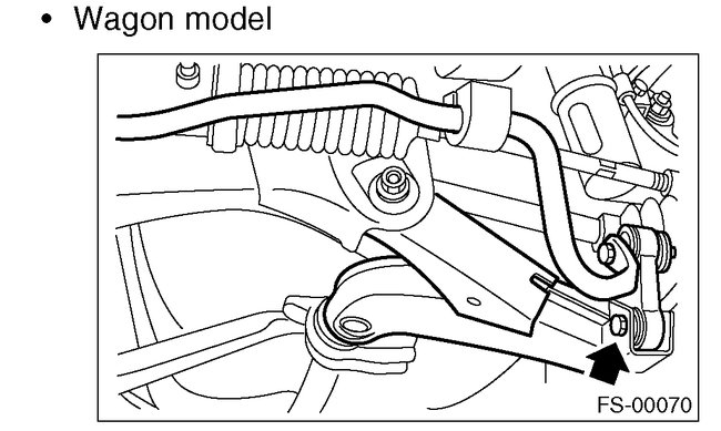

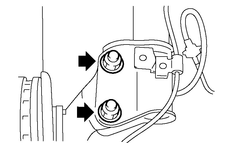

4) Remove the stabilizer link.
^ Sedan model
Sedan model
Picture 2

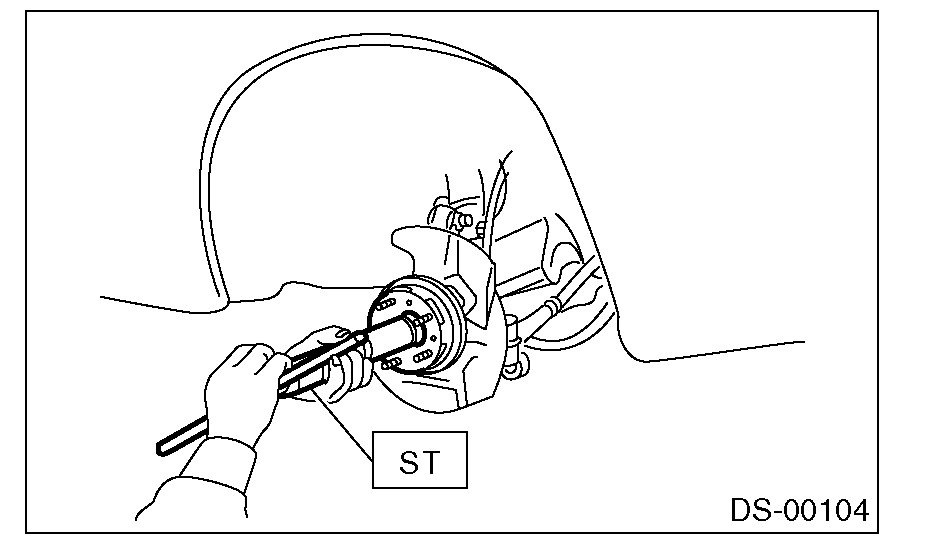

^ Wagon model
Wagon model
Picture 3

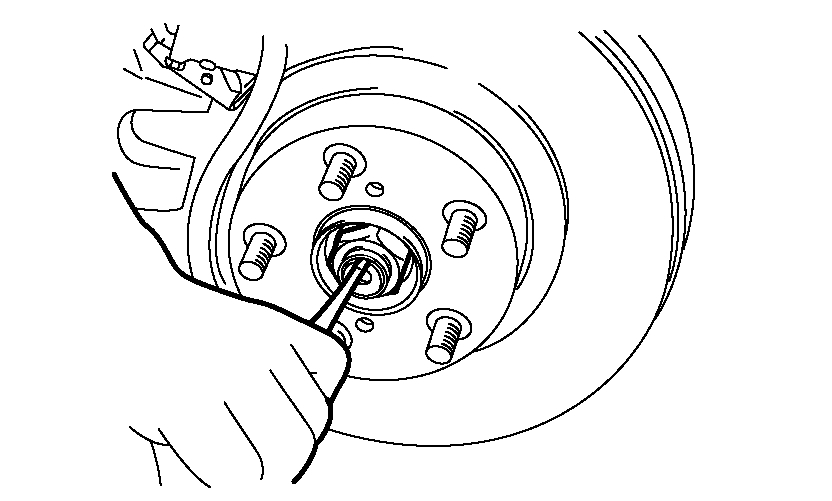

6) Remove the disc rotor from hub.
NOTE:
If the disc rotor seizes up within hub, drive disc rotor out by installing an 8-mm bolt in screw hole on rotor.

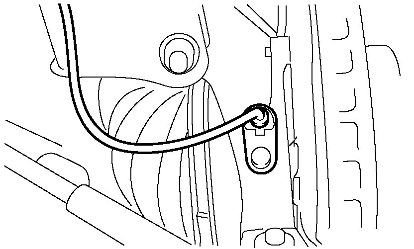

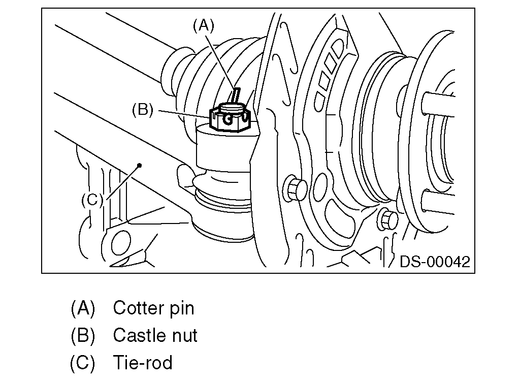

7) Remove the cotter pin and castle nut which secure tie-rod end to housing knuckle arm.
Picture 5

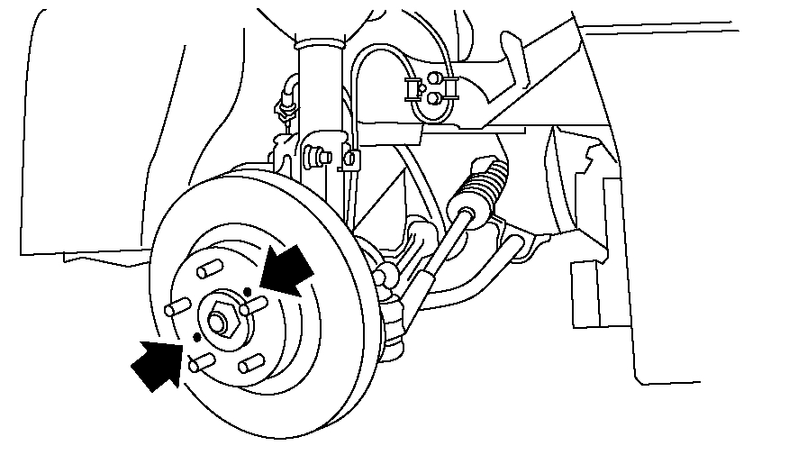

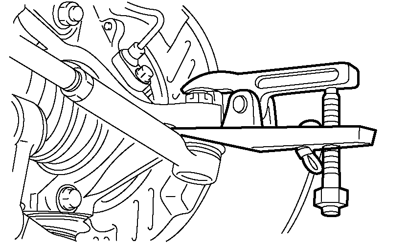

8) Using a puller, remove the tie-rod ball joint from knuckle arm.
Picture 6

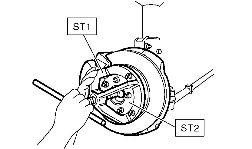

11) Remove the front drive shaft assembly from hub. If it is hard to remove, use the STs.
ST1 926470000 AXLE SHAFT PULLER
ST2 28099PA110 AXLE SHAFT PULLER PLATE
Picture 9

When you are working on the vehicle, confirm there isn't any excessive play in the ball joints or any of the steering components. A bad ball joint can also cause a clunk. Picture 8 shows the lower ball joint.
