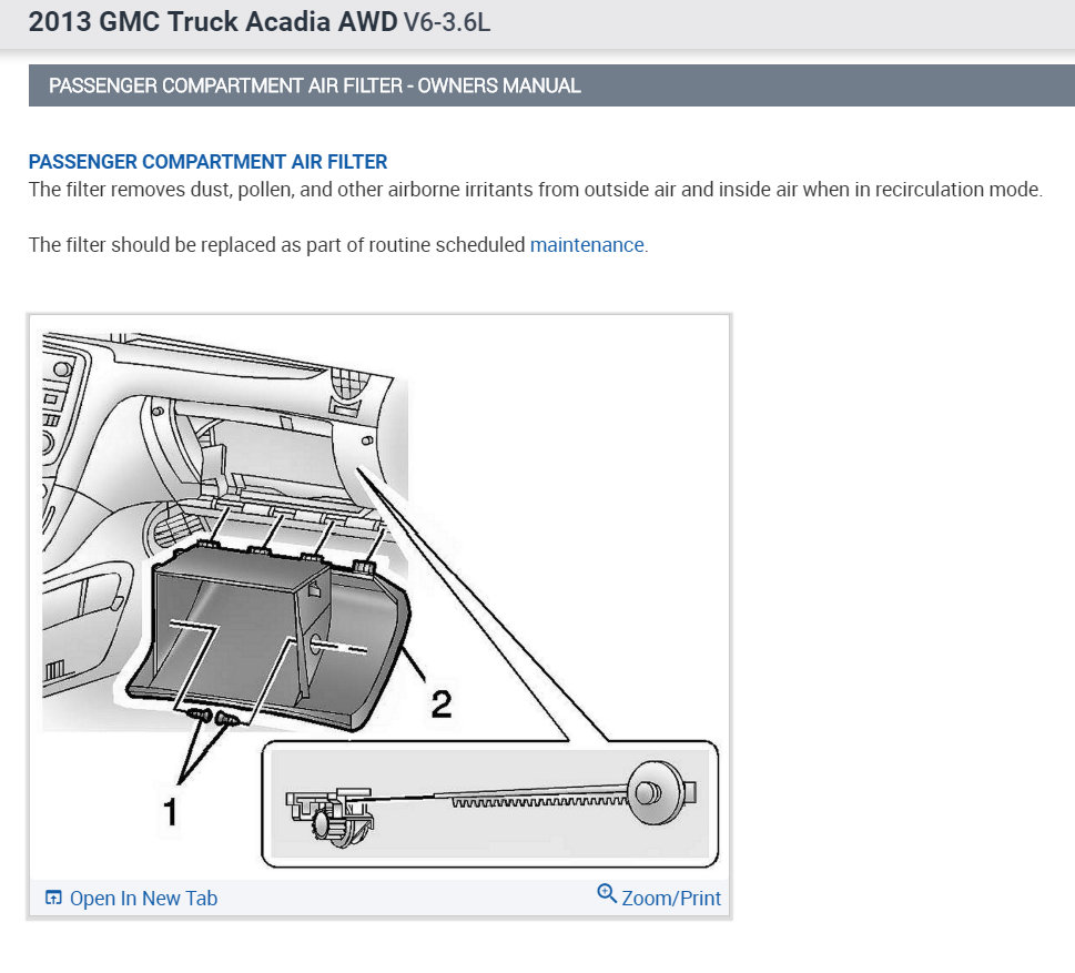

I had the A/C on today and realized that the front vent in the middle on the driver side does not blow at nearly as hard as the other front vents. It still produces cold air. Also noticed last winter that the back vents take longer to heat up and do not get as hot.
Aug 12, 2019 at 2:31 PM
  • 55,273 POSTS

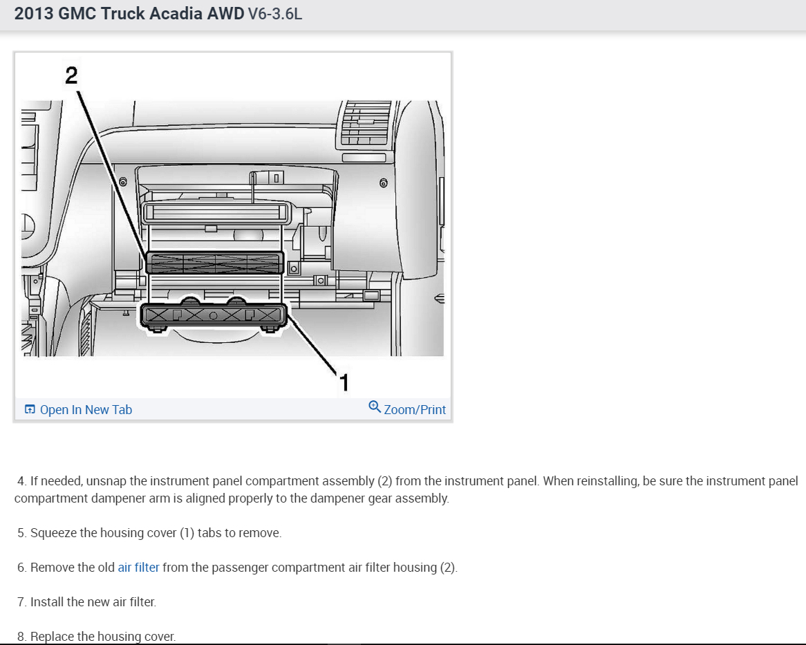

This is common when the cabin air filter gets plugged up. here is a guide to help walk you through the steps with instructions in the diagrams below to show you how on your car:
https://www.2carpros.com/articles/how-to-change-an-air-cabin-filter
