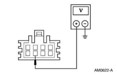

Hi, I just bought this SUV. The passenger side is cold and the drive side console vent and driver side next to door blow slightly warm air. At first I thought there were two separate blend actuators and that the driver side had just gone bad. When I was replacing I tested the old one after I took it out it worked fine. I manually closed the blend door and I still get the warm are out of the driver side but it seems the door is working okay.
I did put the new blend actuator on since I was not sure of course, I still have the same problem. Changing the mode from floor/console to defrost all seems to work okay. The air coming to the rear seats does not seem like a lot and its the warmer air as on the driver side. I have been on the internet for two days trying to figure this out. I see lots of replacing the actuator videos but not much on the blend door it self, or any thing to help figure out if its the source of this problem. I would greatly appreciate someones advice.

The component you replaced is the only thing responsible for the air temp entering the vehicle. I attached a picture of it to confirm you got the right one.
Now, are you sure there is power to the actuator? You mentioned it worked after you removed it. I just wondering if there is an issue with power to it.
Here are the directions for testing the system electronics. The attached picture will correlate with these directions so you know which pins on the connector to check. You will need a multi meter or volt meter and some general testing knowledge. Here are a few links you may find helpful:

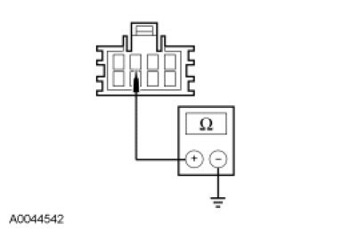

O1 CHECK THE VOLTAGE TO THE BLEND DOOR ACTUATOR
- Ignition OFF.
- Disconnect: Temperature Blend Door Actuator C2091.
- Ignition ON.
- Measure the voltage between ground and temperature blend door actuator C2091-7, circuit CBP20 (YE/VT), harness side.
pic 1
- Is the voltage greater than 10 volts?
GO to O2.
VERIFY Battery Junction Box (BJB) fuse 20 (10A) is OK. If OK, REPAIR circuit CBP20 (YE/VT) for an open. TEST the system for normal operation.

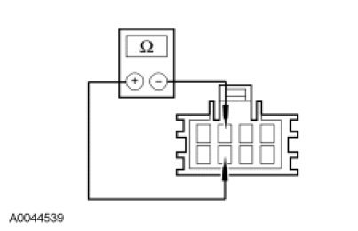

O2 CHECK CIRCUIT GD140 (BK/GN) FOR AN OPEN
- Ignition OFF.
- Measure the resistance between ground and temperature blend door actuator C2091-8, circuit GD140 (BK/GN), harness side.
pic 2
- Is the resistance less than 5 ohms?
GO to O3.
REPAIR circuit GD140 (BK/GN) for an open. TEST the system for normal operation.

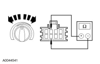

O3 CHECK THE TEMPERATURE CONTROL POTENTIOMETER TOTAL RESISTANCE
- Ignition OFF.
- Measure the resistance between temperature blend door actuator C2091-7, circuit CBP20 (YE/VT), harness side and C2091-3, circuit VH439 (GY/VT), harness side.
pic 3
- Is the resistance between 30 and 1,600 ohms?
GO to O6.
If the resistance is less than 30 ohms, GO to O4.
If the resistance is greater than 1,600 ohms, GO to O5.

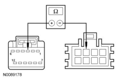

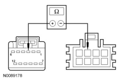

O4 CHECK CIRCUITS CBP20 (YE/VT) AND VH439 (GY/VT) FOR A SHORT TOGETHER
- Disconnect: Climate Control Assembly C294C.
pic 4
- Is the resistance greater than 10,000 ohms?
INSTALL a new climate control assembly. TEST the system for normal operation.
REPAIR circuits CBP20 (YE/VT) and VH439 (GY/VT) for a short together. TEST the system for normal operation.

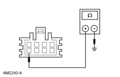

O5 CHECK VH439 (GY/VT) FOR AN OPEN
- Measure the resistance between blend door actuator control connector C2091-3, circuit VH439 (GY/VT), harness side and climate control assembly C294C-3, circuit VH439 (GY/VT), harness side.
pic 5
REPAIR circuit VH439 (GY/VT) for an open. TEST the system for normal operation.
O6 CHECK THE TEMPERATURE CONTROL POTENTIOMETER OPERATION
- Measure the resistance between temperature blend door actuator C2091-7, circuit CBP20 (YE/VT), harness side and C2091-3, circuit CH439 (GY/VT), harness side while rotating the temperature control potentiometer from full WARM to full COOL.
pic 6
- Does the resistance vary between 30 and 1,600 ohms?
GO to O7.

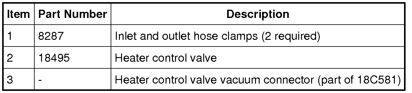

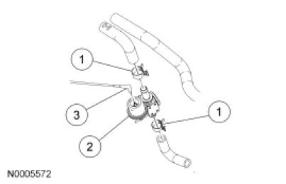

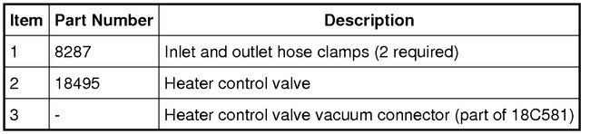

This vehicle does have a heater control valve. I am going to provide the directions for removal and replacement so you can see location. Also, it is operated by engine vacuum, so make sure nothing is disconnected and there are no vacuum leaks preventing it from working. Here are the directions. The attached pictures correlate with the directions.
______________________________
HEATER CONTROL VALVE
Heater Control Valve
picture 1
picture 2
Removal and Installation
Vehicles with 4.0L and oil cooler, without auxiliary climate control
1. With the vehicle in NEUTRAL, position it on a hoist. For additional information, refer to Vehicle Jacking and Lifting.
All vehicles
2. Drain the engine coolant. For additional information, refer to Cooling System &/or Engine Block Heater.
3. Disconnect the 2 inlet and outlet heater hose clamps.
4. Disconnect the heater control valve vacuum hose.
5. Remove the heater control valve bolt.
All vehicles
6. Remove the heater control valve.
7. NOTE: Lubricate the coolant hoses with plain water only if needed.
To install, reverse the removal procedure.
8. Fill the engine cooling system. For additional information, refer to Cooling System &/or Engine Block Heater.
___________________________________________
As you can see, it is connected in the heater hose. Let me know what you find or if you have other questions.
