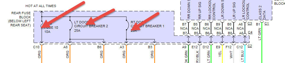

On the Driver side door module panel where I can control all the power windows & locks of the vehicle, the power window function doesn't work. As in, I cannot roll down my window or any others - However, I am still able to lock & unlock all locks from this panel, as well as use the disable passengers from rolling down their windows feature.
What could be the problem? Fuse, Power window motor?
Thank you, I will donate if I receive the solution.

check fuse and breakers in pic then have it scanned for codes may be the body or driver door module or drivers switch
