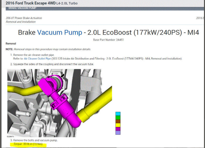

drive shaft coupler- vacuum pump torque setting for the coupler needed
2016 FORD ESCAPE
45,000 MILES • 2.0L • 4 CYL • 4WD • AUTOMATIC
AMYMCC1094

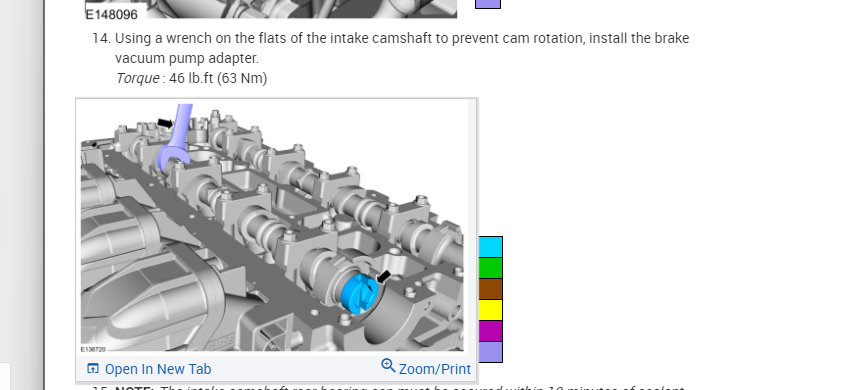

The bolt that goes from the drive shaft coupler to the vacuum pump snapped and locked up and roasted the pump. We managed to get the bolt extracted from the camshaft, but we cannot find the torque setting for the coupler.Can you help please?
Aug 2, 2021 at 10:53 AM

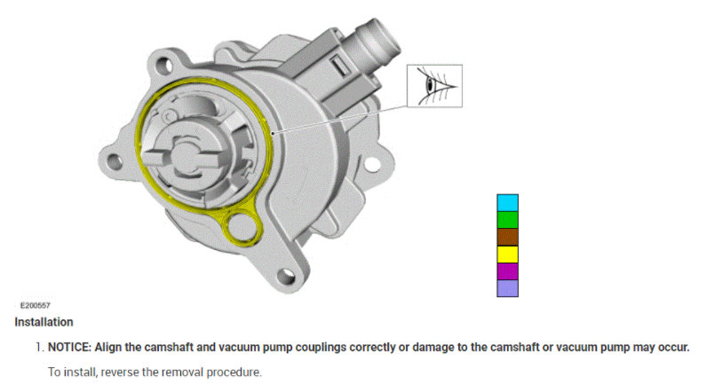

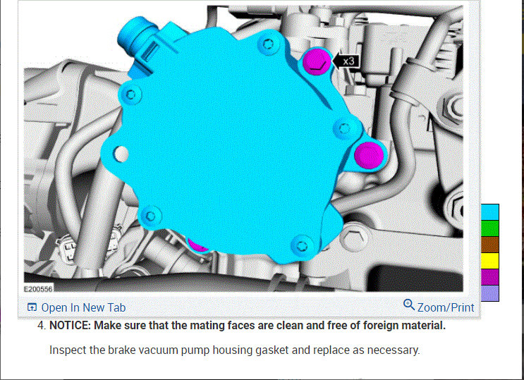

I suspect you are looking for the torque spec in the first attachment for when you are installing the pump on the camshaft.
However, I also included the process to replace the pump in case you are looking for that as well.
Please let me know if you need something else.
Thanks
