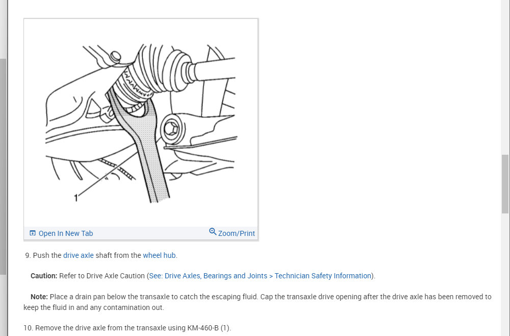

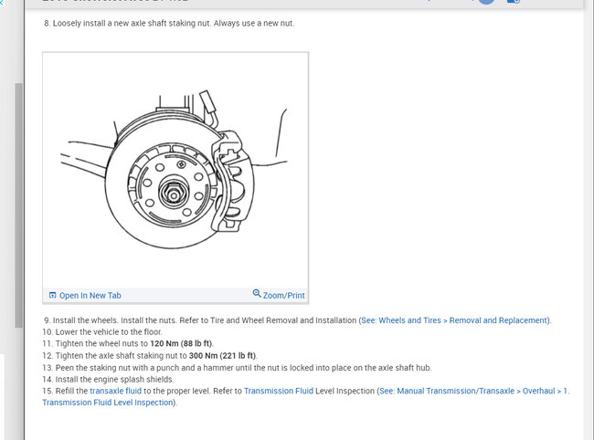

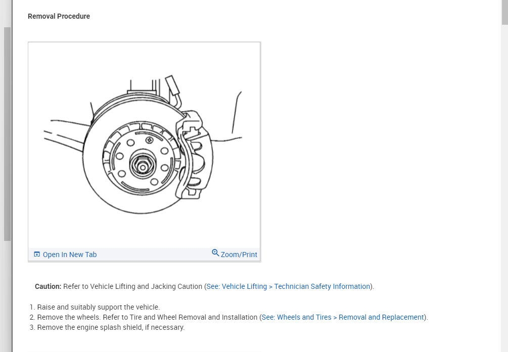

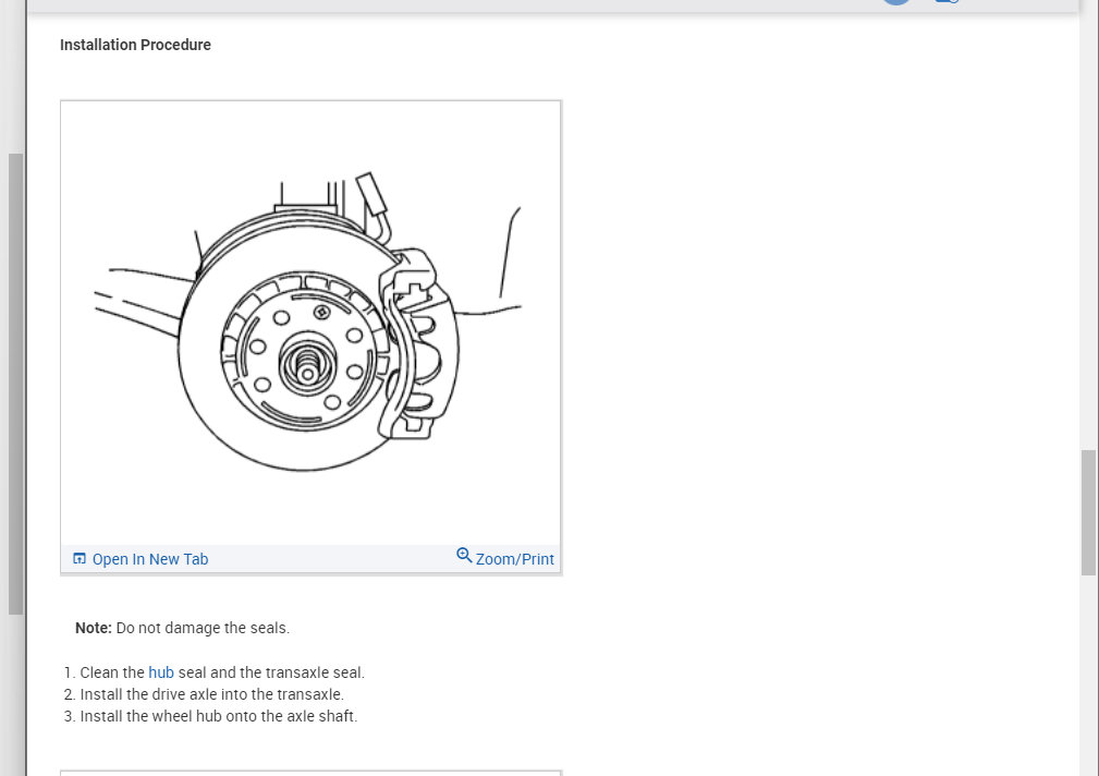

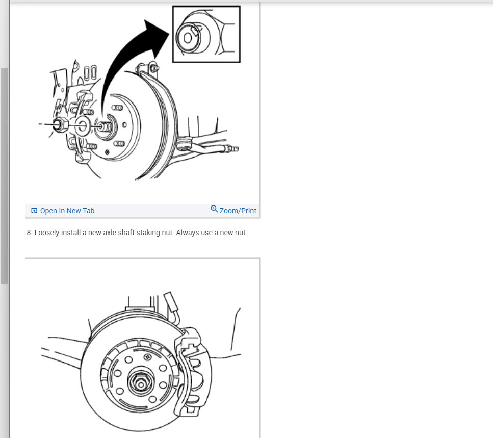

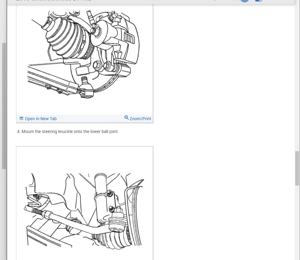

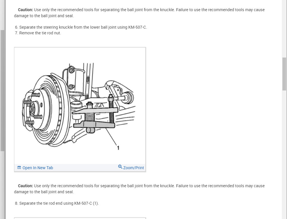

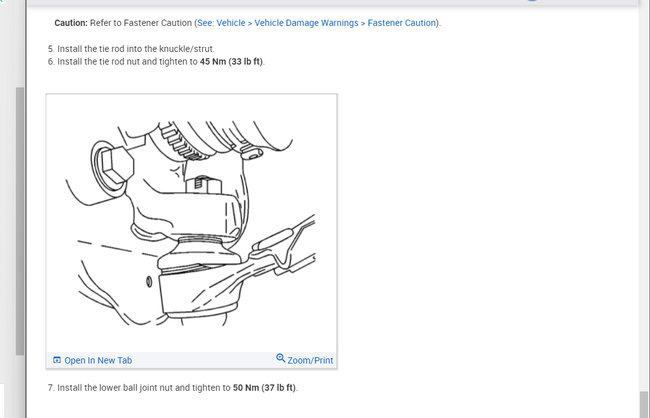

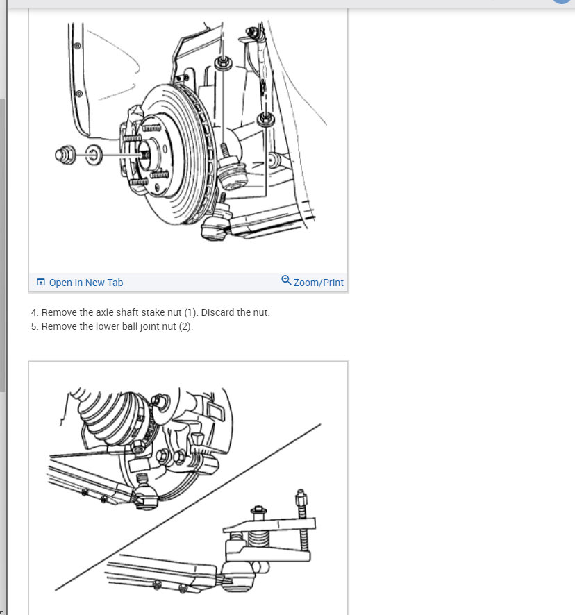

I attached the process below on how to replace this in a similar vehicle. We don't have a manual on a Spark for this year which tells me this is a vehicle outside the USA.
Please let us know about this info and we can go from there.
