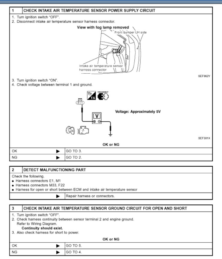

I got p051 and p113 high-curant codes. I replaced MAFsensor still same codes runs badly. any ideas?
May 15, 2022 at 5:39 AM

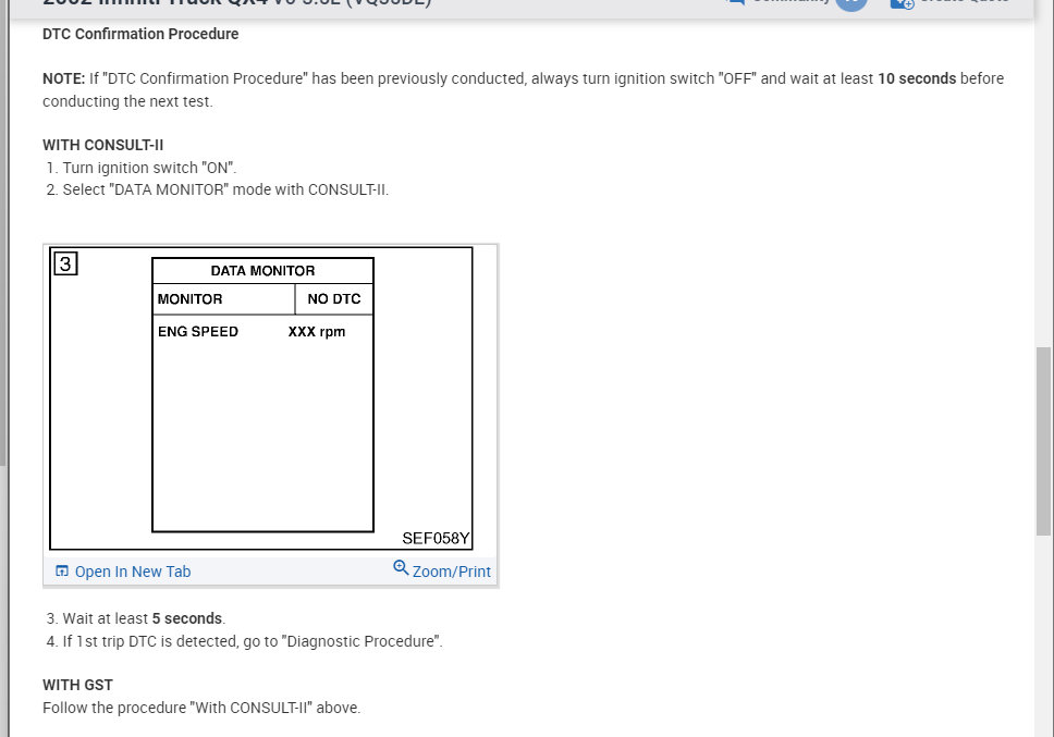

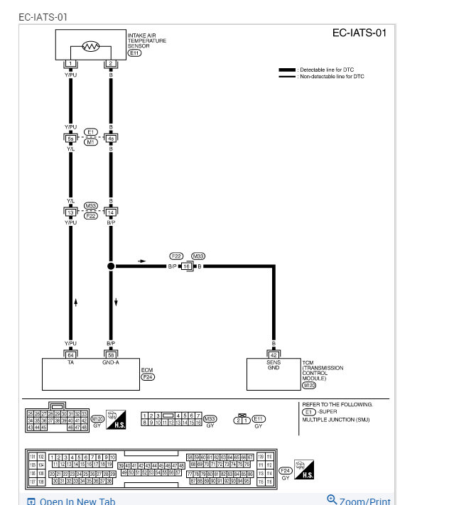

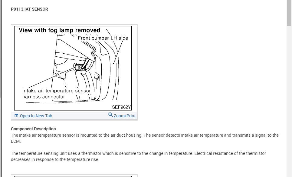

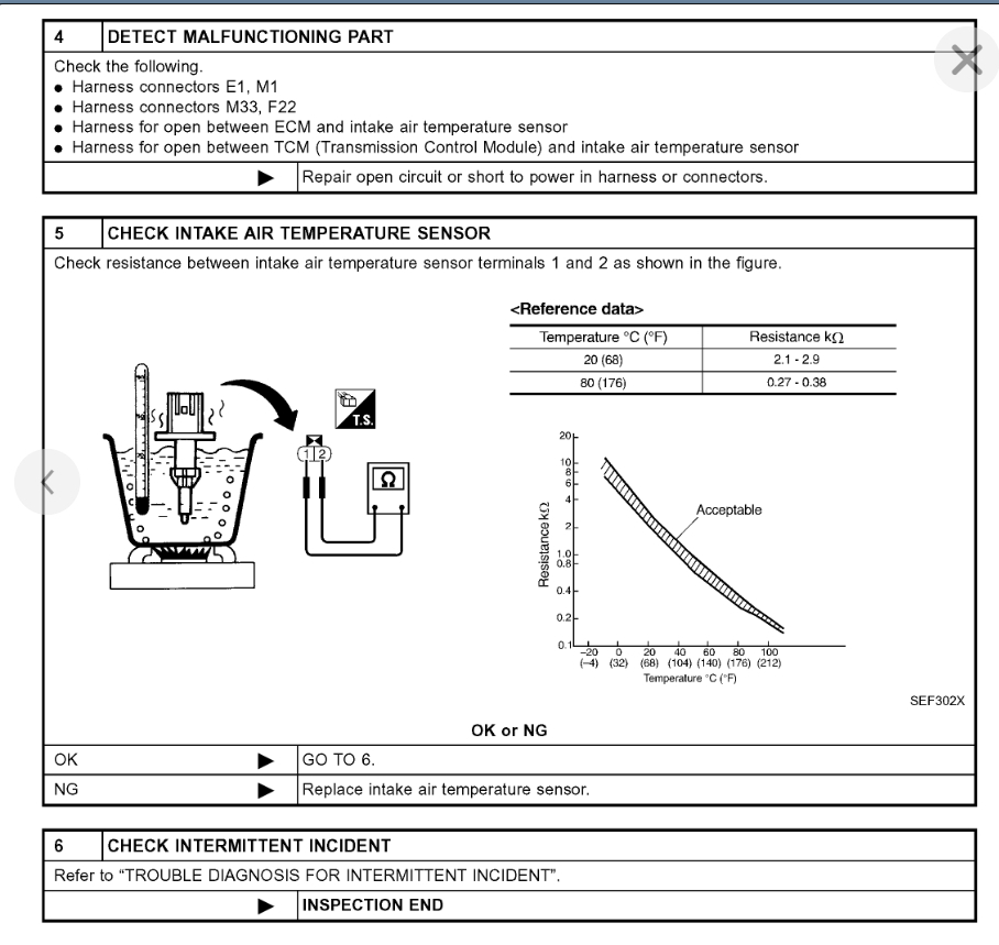

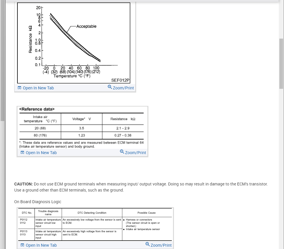

We need to start with clarifying the codes that you are getting. I suspect you missed a zero in there as they should be P0113 and P0051?
If this is the case then we have specific testing that we need to run through.
Basically, the cause of these is most likely not the same thing but we need to start with running through these guides and then the testing below to help figure out what is happening:
