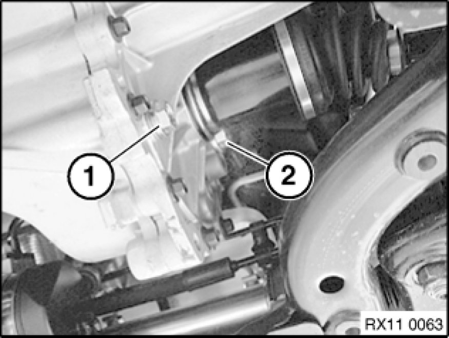

does it need to be leveled on 4 jack stands?does it need to be warm when draining?
Jan 8, 2020 at 6:47 AM
BMDOUBLE
  • 1,139 POSTS
It does not necessarily need to be level on jack stands but it would be better. It does though need to be at normal operating temperature. Unscrew oil drain plug (1) and allow oil to flow out completely.
Clean oil drain plug and reinstall.
Tightening torque 23 00 1AZ .
Unscrew filler/fill level monitoring plug (2) and fill transmission until oil overflows. Allow excess oil to drain and reinstall filler/fill level monitoring plug.
