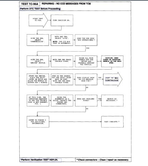

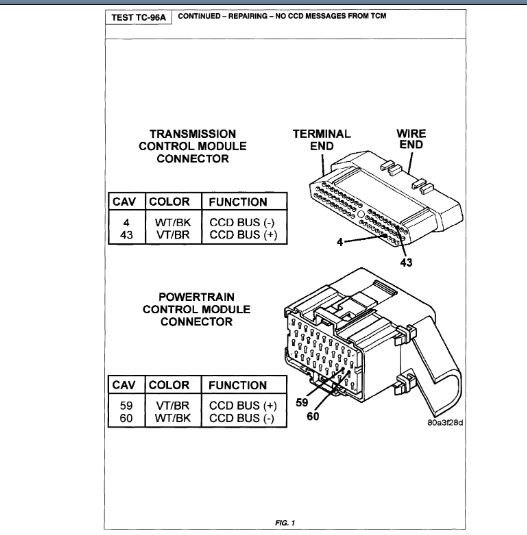

Good afternoon,
How long since you changed the oil/filter in the transmission? I would start there as it could be a valve body from dirty fluid.
I found the 1698 code but there is no 1776 code. Can you verify that code?
The 1698 is a serial data code for communication between the ECM and the TCM.
