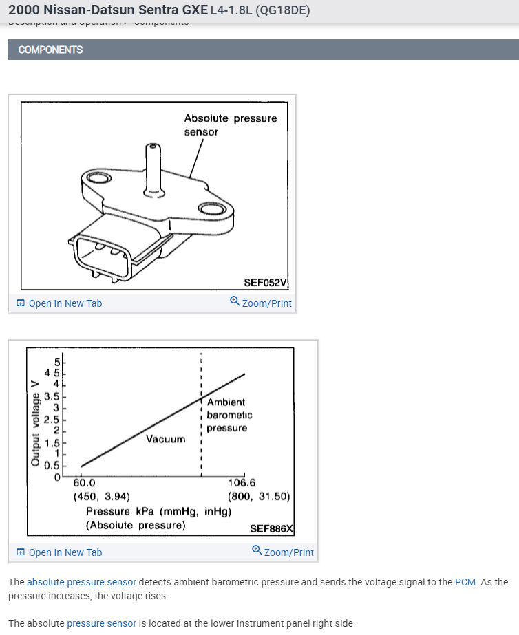

Does this model have a MAP sensor and where is it?
2000 NISSAN SENTRA
190,000 MILES • 1.8L • 4 CYL • 2WD • AUTOMATIC
NCCZBT

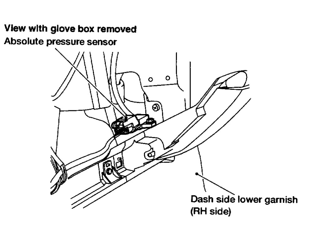

trying to find location of MAP sensor I have a code to replace it.
Thank you

If you don't mind let me know which code that you have. Many times the code could be for a related item and not the exact part.
This vehicle have a absolute pressure sensor, it work like the manifold pressure sensor but located at the lower instrument panel right side.
