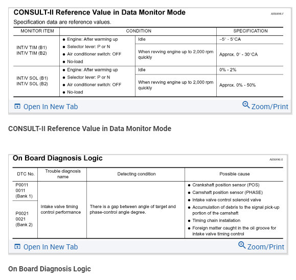

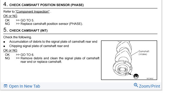

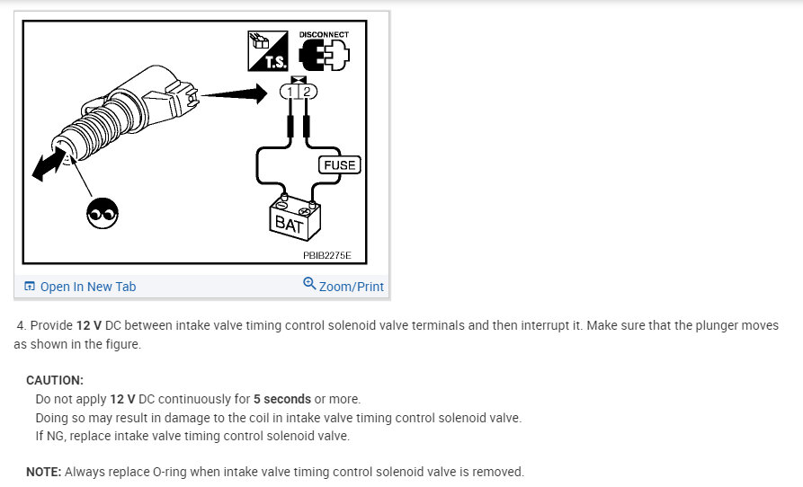

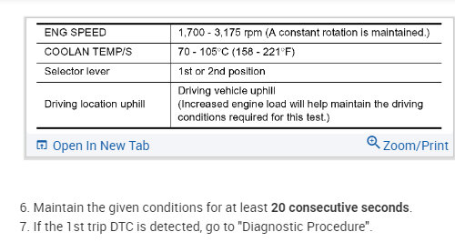

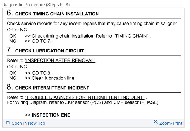

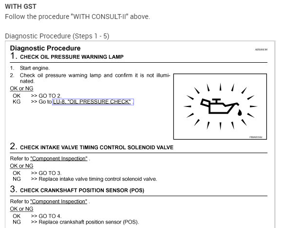

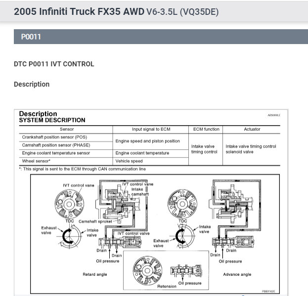

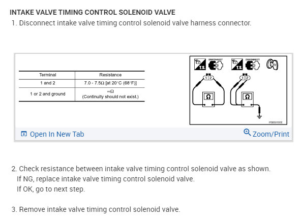

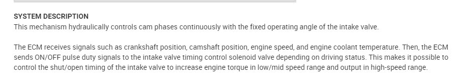

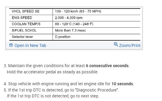

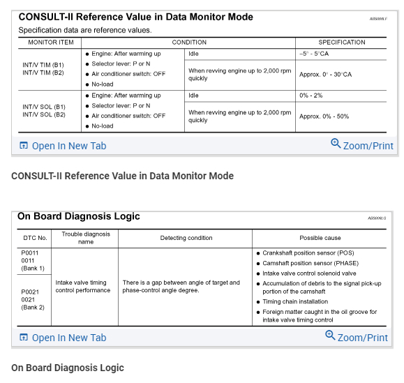

The codes are related to the IVT (Intake Valve Timing) control. The cause can be a few different things such as a camshaft or crankshaft position sensor, low oil pressure, IVT control solenoid, engine timing, and so on. I am basing this on the two codes provided are the only one's present.
Now, to diagnose the issue, you need a scan tool that is able to actuate different solenoids. If you look below, I attached the diagnostics for you. Take a look through them and let me know if you are comfortable performing them.
Let me know if you have questions or what you find.

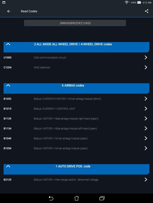

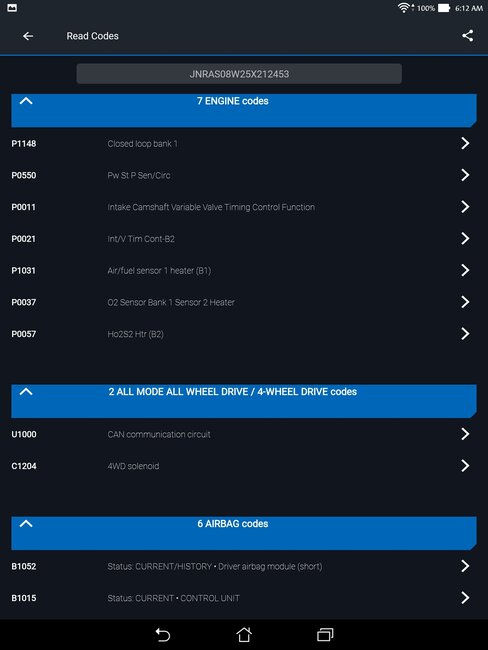

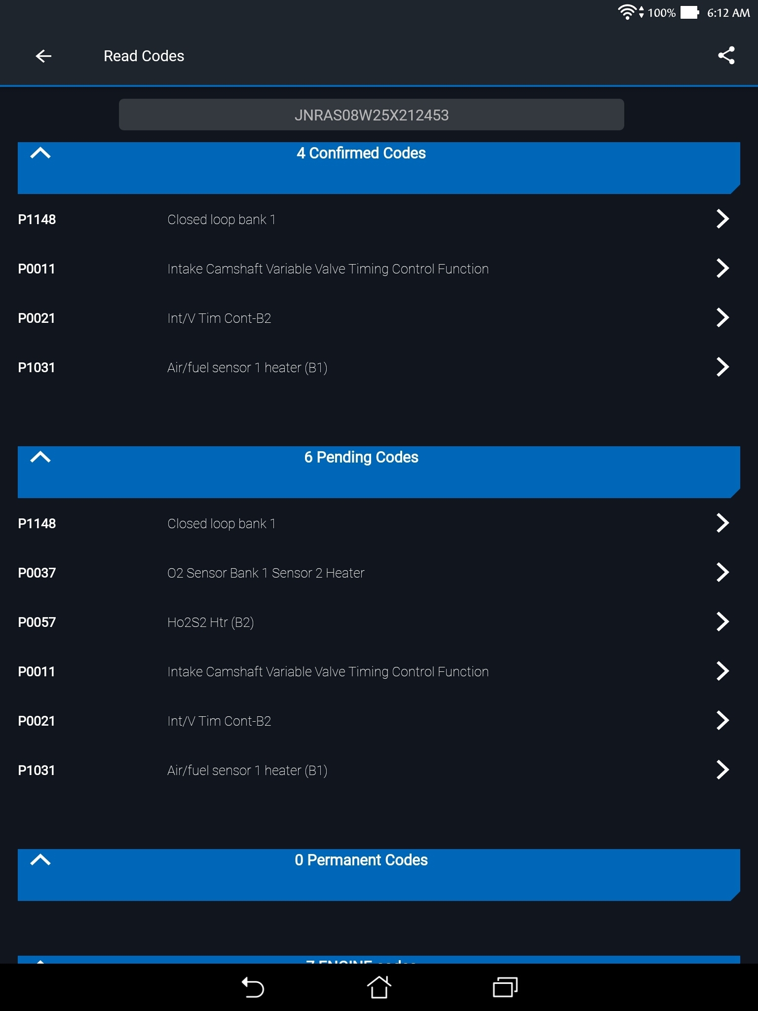

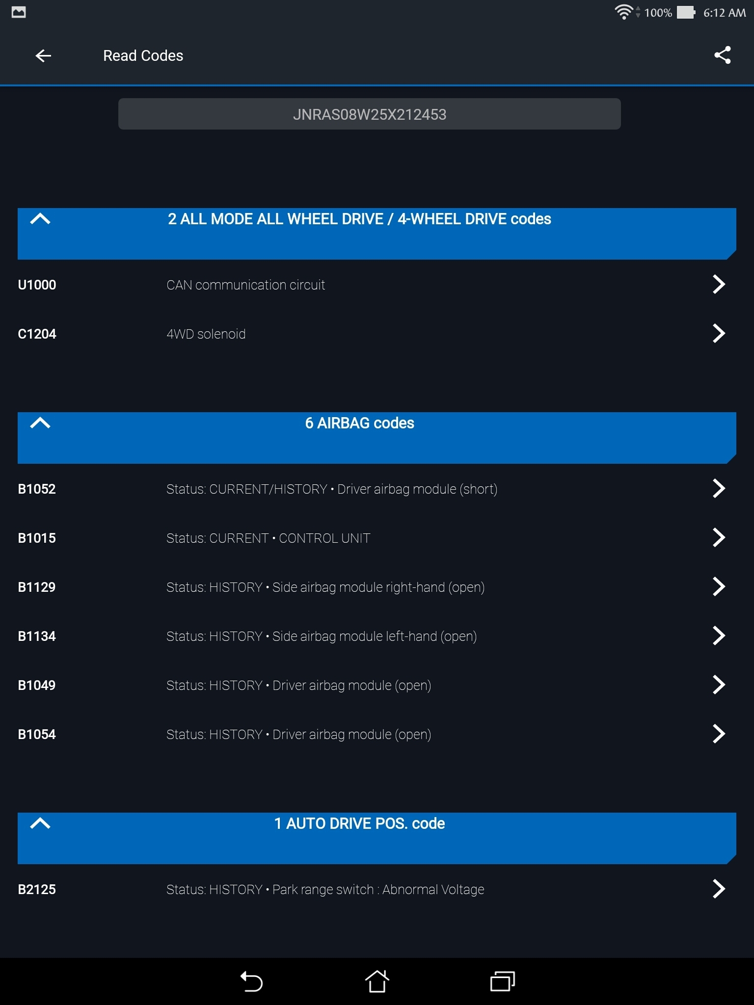

I have replaced used IVT Timing Solenoid, but the code still appears back, and I have checked oil pressure on the timing solenoid position by removing and cranking and the oil spill everywhere at high pressure. Could this be ECM, because if you crank the vehicle, it starts fine and stalls, then it does not idle above 450 RPMs.
I attached the screenshot of diagnostic report below.
Dec 15, 2022 at 1:16 PM
  • 110,244 POSTS

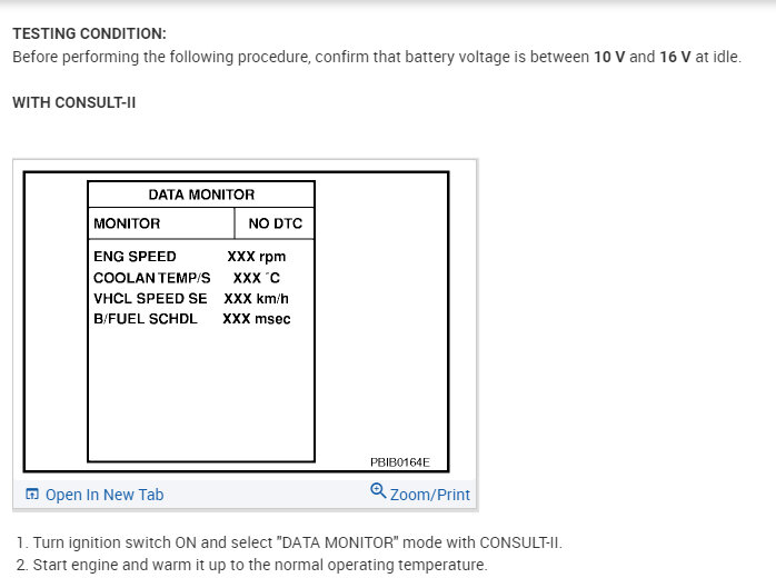

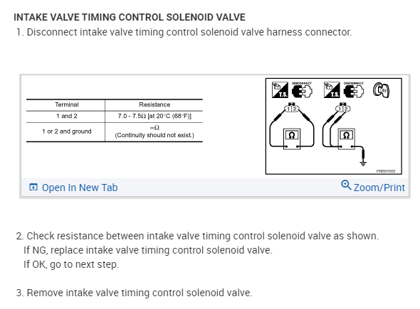

The ECM is a possibility, but I would go through all the tests listed in the diagnostics. Just for curiosity, what are the short-term fuel trims? Also, am I missing something in pic 4?
