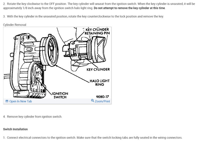

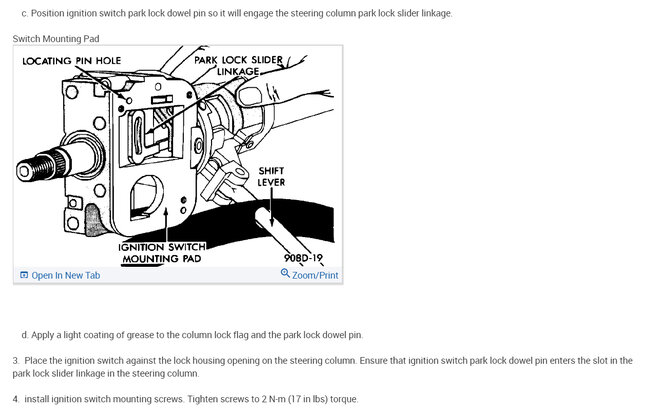

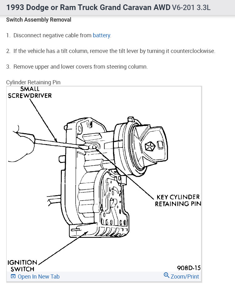

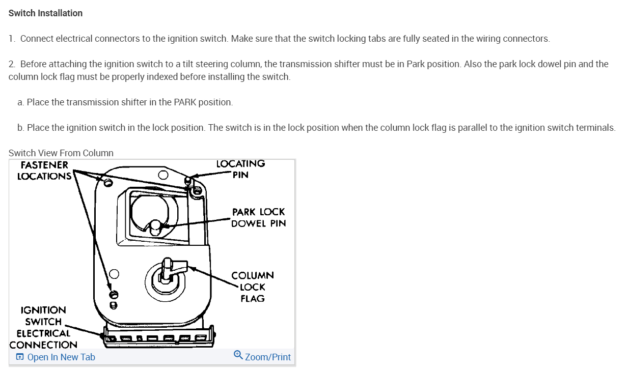

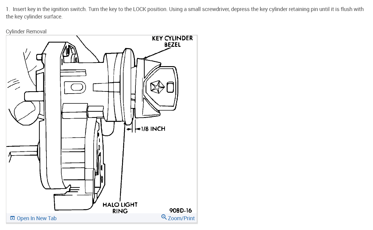

I have seen the ignition switch cause this problem, but we should run the codes to see what is stored.
https://www.2carpros.com/articles/retrieve-trouble-codes-for-chrysler-dodge-plymouth-odb1-1995-and-earlier-car-mini-van-and-light-trucks
This guide may help as well:
https://www.2carpros.com/articles/car-not-running-advanced

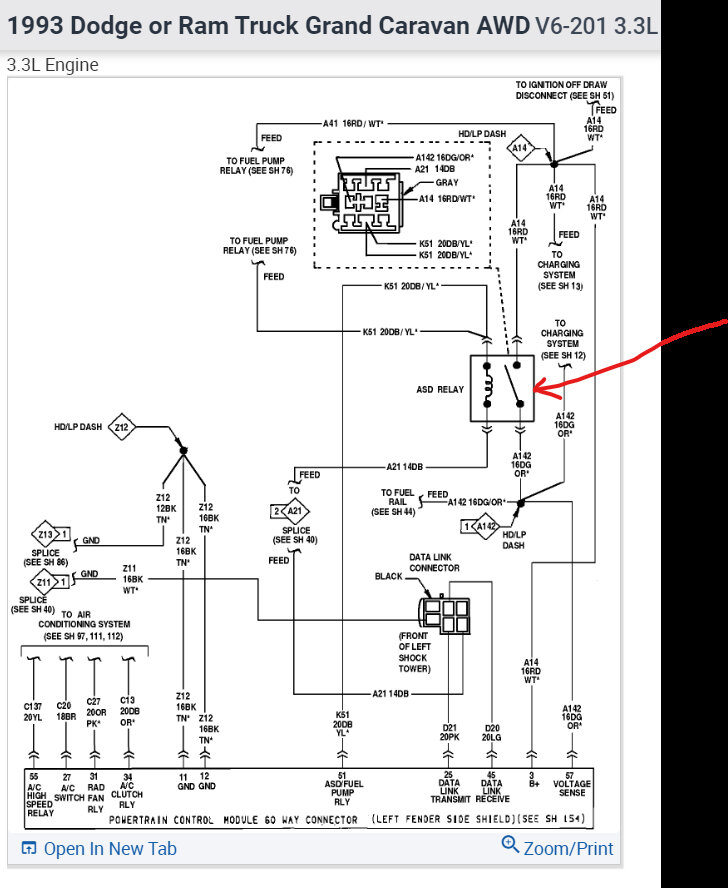

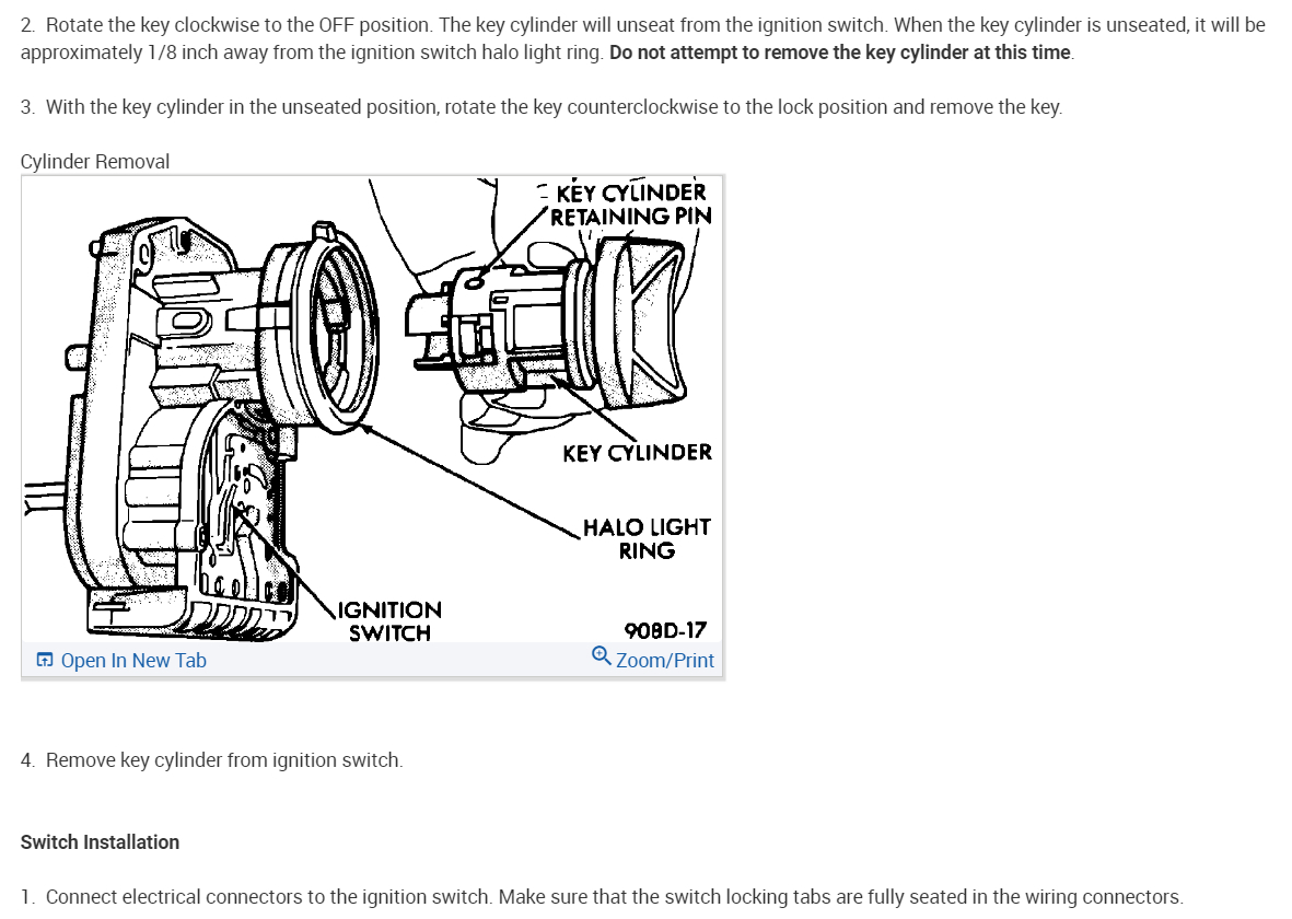

Here is how to change the ignition switch out in case you need it. Here is the ASD relay location as well which is in the main fuse panel under the hood. Check out the images (below). Please let us know what happens.

My husband has changed the ignition before it did not help. It totally cutoff at high speed. It seems not to be getting fire. . No i cant do a video . It just spins over . Has no crank fuse .changed a relay that works with coil pack. Still same turns over no crank. Its a 93 so its different from newer ones.

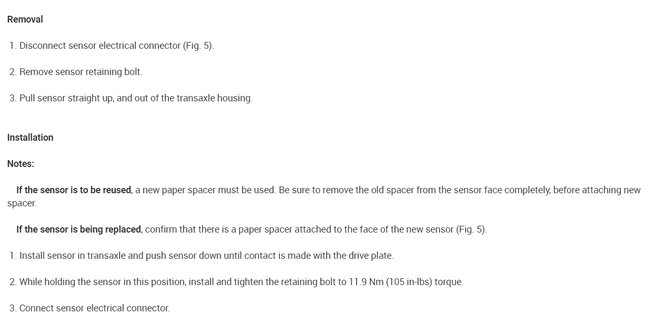

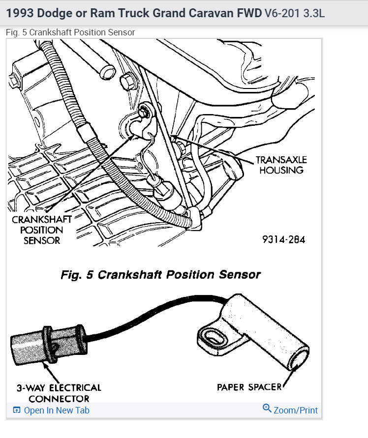

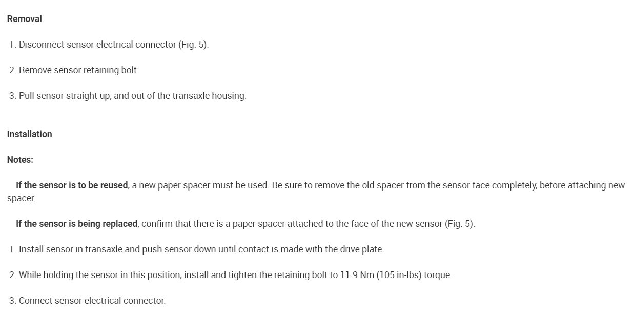

I was thinking it could be the crankshaft angle sensor. Can you please check for spark?
This video will help:
https://youtu.be/baq_aEWNQ0Y?si=z1BXlt5B3y9Y9gwB
Here is the location of the sensor in case there is no spark. Check out the images (below). Please let us know how it goes.

He said it wasn't getting fire coming out of coil to plug, i believe. yes, I was thinking crankshaft sensor too, but I have to wait for husband to check it since you know how things go. I have to order it from different stores just in case. I'll pick one up tomorrow. But he is frustrated with it, so I have to let him do as he does to check it out. He is a mechanic but gets stumped sometimes. I let you know. but there were right many codes relating to transmission speed sensor and the shifting and so on. but he said those don't matter as far as engine running. but would crankshaft sensor shut down at 50 MPH wondering .
Sep 1, 2023 at 9:45 AM
  • 55,433 POSTS
Oh yes, the crankshaft sensor can fail at any time. I would consider changing the crankshaft sensor. Also, when you get a change follow the guide on how to get the trouble codes.

Well, nothing seems to be helping. We changed the crank sensor. spins and no cranking /starting. even changed the cam sensor. has fuel pressure. so not sure what to do. starting to be money pit. My husband is a mechanic but stumped. It's not reading the codes, no communications between scanner and van. seems it's something to do in the wiring. all fuses are good. Need the correct wiring diagram for fuse box and relays beside it behind the steering cover and the engine coil and starting diagram if you know what I mean. The part where it comes through the coil output input. 1993 dodge grand caravan es 3.3.

In 1993 there is no scanner for the car. please go over the guide I sent and upload a video of the engine cranking over, also will it run on starting fluid?
Sep 5, 2023 at 4:04 AM
FEISTY63
  • 12 POSTS
Snap-On scanner does have it on there just not communicated with scanner. under hood has a plug and under the steering wheel has a scanner plug one is Chrysler 1 adapter and one is Chrysler 2 adapter.one is for body scanner and one is for engine scanner. .. it spins over fast I haven't tried starting fluid but I'll tell him to see if it will still not sure which relay is the auto shutdown relay.so many of same thing they all look alike. There are replays behind the cover at steering wheel that are not accessible until you remove large cover.

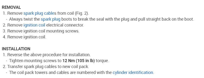

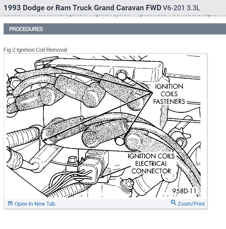

I have seen shorted ignition coil cause this problem, have you tried a new one? Check out the images (below). Please let us know what happens.
Sep 11, 2023 at 4:31 AM
FEISTY63
  • 12 POSTS
reply that was the first thing but didn't help. So, the solution last night was since we had replaced crank and cam sensors and a few other things. ECM computer included and it did not crank only spun over not start. Someone suggested we unplug the transmission control module and see if it would crank up and guess what it did start i was doing the happy dance. but then we decided to change the computer back to the old one to see if it indeed was bad too and yes it did not crank with the old ECM computer, so we put the new one back on. So, we now know for sure the emc was bad and the transmission control module on passenger side firewall was bad too. the transmission control module cut the van off at 50 mph and locked where it couldn't start again the solution was figured out. We are now ordered the part and waiting on it the ship to store to get it to put on. We never thought the transmission control module could shut down the van while driving down the road ... but we do now know.
