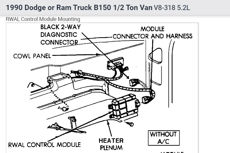

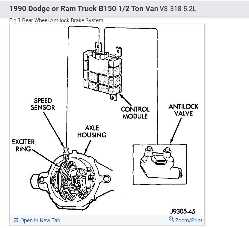

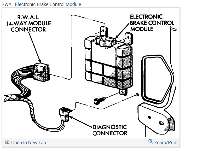

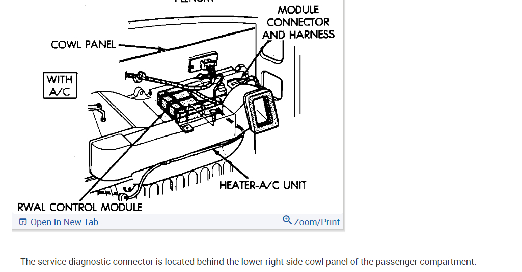

The brake light and anti lock light stay on. This occoured after replacing the EMC to fix a charging problem. Since then, I have replaced the front brake pads and calipers, and turned the rotors. The back brakes have not been touched. Also, the odometer does not work. The speedometer works, but is not accurate. The speed control works but looses speed slowly. I replaced the speed sensor, but that did not fix the problem. Any ideas on how to fix this 1990 Dodge B250
Oct 11, 2009 at 6:23 AM
  • 110,240 POSTS
The self test feature of the control module is activated whenever the ignition switch is turned to ON or RUN position. If a system fault is detected, the control module illuminates the ANTILOCK light and stores the fault code in memory. Fault codes are retained in memory even after turning the ignition switch to OFF position. Please check the images below
