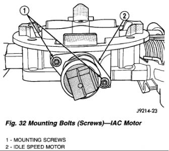

How do you test the idle air motor or the air intake temp sensor?
It goes back to normal and stays normal after reving it up on loss of power/misfire. It is only happening about 1 to 2 minutes after starting and lasts 5 to 15 seconds. It would go to normal on its own in about 15 to 20 seconds.
Wednesday, August 25th, 2010 AT 8:41 PM
  • 75,992 POSTS
Try cleaning out the idle air control valve and see what happens
https://www.2carpros.com/forum/automotive_pictures/12900_iac_motor_1.jpg

I replaced the idle air controller and still have the same problem. Any ideas?
