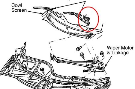

A few days ago, we had a pretty bad ice storm. When I went out to dig out my car the next morning, I started it first with the defrost, then chipped off all the ice. When i was done i got in and started my wipers. I guess there was still some ice on the windshield near them that i had not noticed.
Now the one on the passenger side works fine, but the one on the driver's side only goes up about one inch and stops. I went to PepBoys but I had a feeling the man looking at it had no idea what he was doing.

https://images.2carpros.com/forum/automotive_pictures/55316_00stratuswiper_1.jpg
Locate circled. Pop the wiper arm nut cover and tighten the nut after adjusting where the wiper arm is supposed to go. Done.
