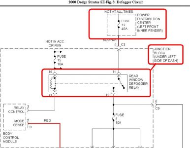

My rear window defrost stopped working I changed the fuse relay but it still dosen't work. It stopped all at once no sign of trouble

So, did you replace the fuse or the relay. The circuit has one of each.

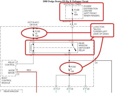

I just checked the fuse I thought you had something but the fuse is fine

OK. Let's start this one more time. Look at the wiring diagram again. The circuit has a total of 3 fuses and one relay. I need you to check ALL fuses and relay. Under the hood, inside the power distribution box. 1. Check fuse #12, 40 Amp fuse. On the left side of driver dash, inside the junction box. Open the driver door to gain access. 2. Fuse #6, 10 amps. 3. Fuse #15, 10 amps. 4. Rear window defogger relay. There are a few relays inside that junction box, just swap a couple of them around. Then re-test.
