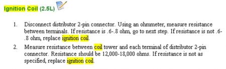

Check the distributor and coil output, the coil is part of the distributer on the 2.5 motor.

Coil checks out OK - mostly. Between terminals it shows 0.8 or 0.9 ohms (meter shows one or the other each time I check it). This may or may not be slightly out of spec. Between coil tower and each terminal shows slightly above 15k ohms, right in the middle of the specified range.
Since the coil/distibutor assembly is going to cost me $230 or more, I'm hesitant to replace it based on the questionable resistance value between terminals.
