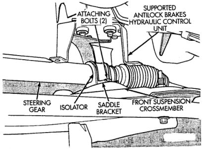

Steering problem
1997 Dodge Stratus 6 cyl Front Wheel Drive Automatic
I have 97 Dodge straus es I have the power steering off the bracket and could move it around but I need to remove something else. I looks likes by removng the backet I could get it out but I couldn't find the other bolt to remove the backet. I remove the 2 bolts but there seem to be one more that I couldn't get to

Hello tedv51
Welcome to 2carpros.com
Remove the steering rack saddle bracket attaching bolts (2 bolts per side).
https://www.2carpros.com/forum/automotive_pictures/46384_0900c15280089b85_2.jpg
