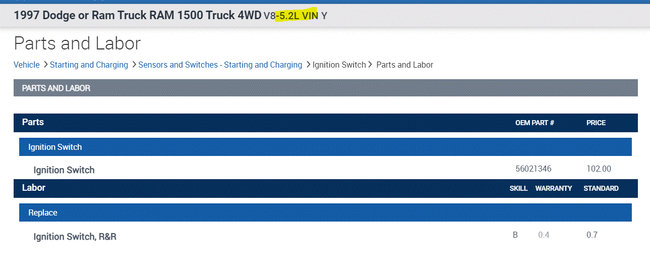

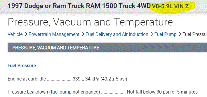

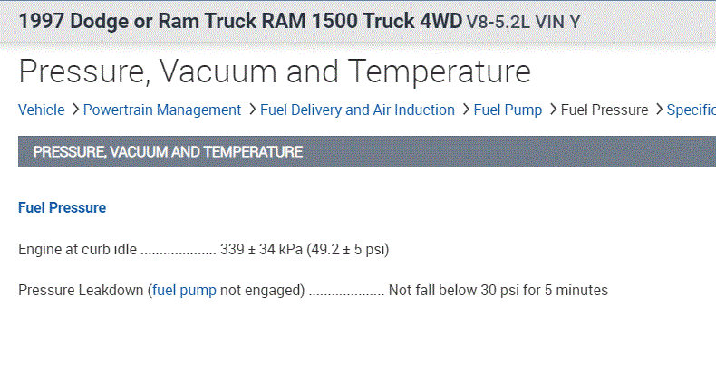

I checked the fuel pressure specs for both engines and they are the same. See pics 1 and 2

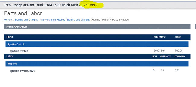

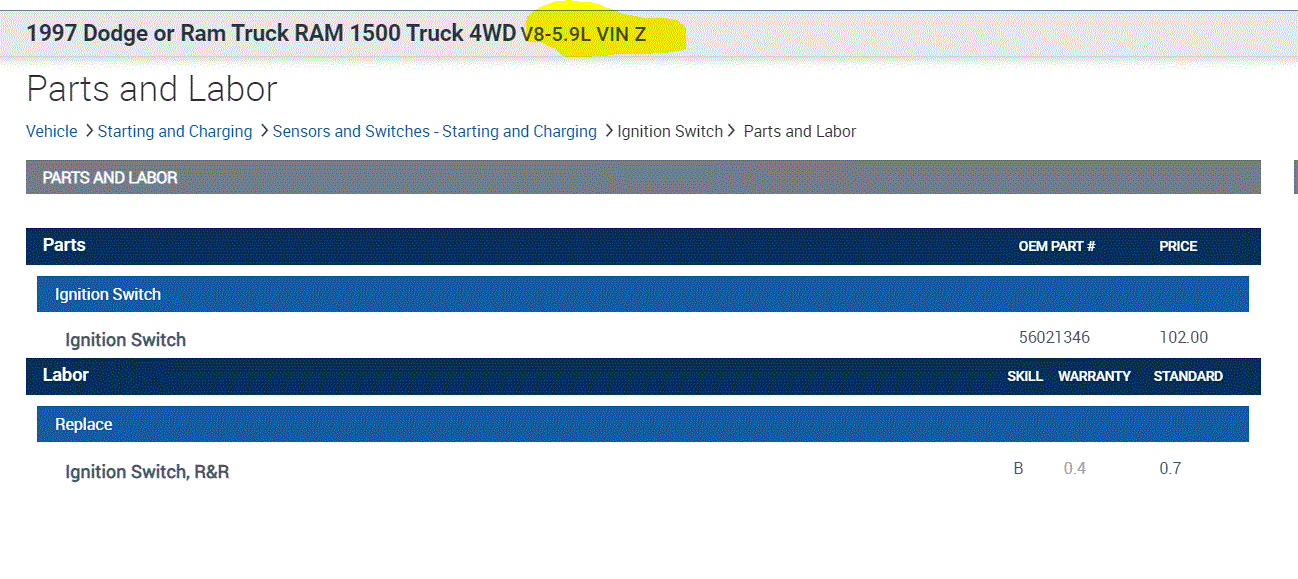

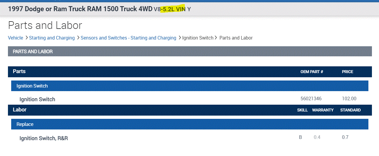

As far as the ignition switch is concerned, they are the same.
