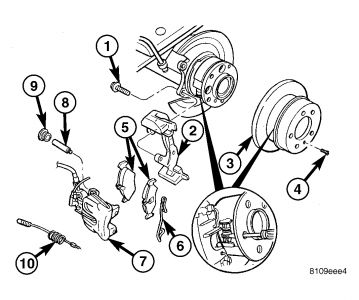

Having a difficult time getting the brakee drums off of the rear axel. They start to slide off, but then hang up. Can you outlinee the changing process for rear drums on a single whell rear axel?

My bad. It's the rotors that don't want to come off. The parking brake fits inside the rotor like a drum set-up, and it seems that the parking brake is what is preventing the rotor from coming off the axel. It is a 2500 and I believe USA produced. Caliper is off but can't get the rotor off to change it.

Has locking bolt been removed? if yes loosen parking brake adjuster see diagram
https://images.2carpros.com/forum/automotive_pictures/198357_Graphic_686.jpg

We loosened the parking brake adjuster and the rotor starts to slide off but then hangs up and stops. it almost seems like the parking brake is stuck in a groove inside the rotor. ANything else we need to do to get the parking brake to release?
