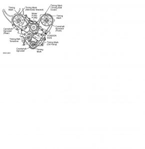

Hello, I recently had a friend replace the water pump in my car. After installing the pump, he left the rest unfinished, and didn't hook anything else back up. I'd like to put all the parts back together properly, but I have no idea where to start or what is what. Do you think you might be able to help me? Can you send me step by step details with pictures so that I can hook all of this back up and make it run? I am 20 years old, and I know nothing about auto mechanics, but I am determined to do this. Please help. Thank you so much. I am anxiously awaiting your response.

P.S. It is a Dodge Shadow 'ES' and I can send you a picture of under the hood if it'll help.

Water pump was installed what about the timing belt if not you need to set the timing marks and install the belt as is the picture make sure that the timing marks are on exactly or engine damage may occur and it will not start let me know
