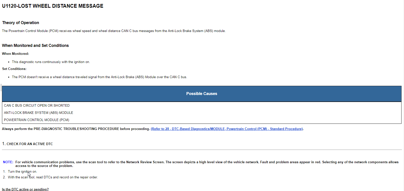

The electronic stability control light stays on all the time.
I need help.

Here are the codes that I got:
U1110
U11bc
U0001
U1110 p/d
U1120 p/d
U11bc p/d
Jun 23, 2019 at 9:32 AM
Okay.

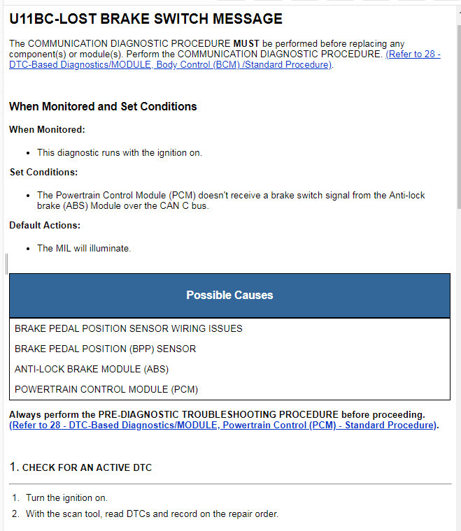

U1110 is Lost vehicle speed message which points to a communication issue between the PCM and ABS.
U11bc is Lost brake switch message
U0001 is a communication issue.

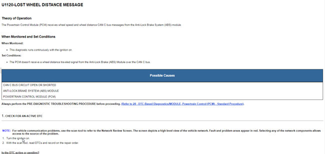

U1120 - is lost wheel distance message
It looks like you are having a failure to have the ABS and PCM communicate.

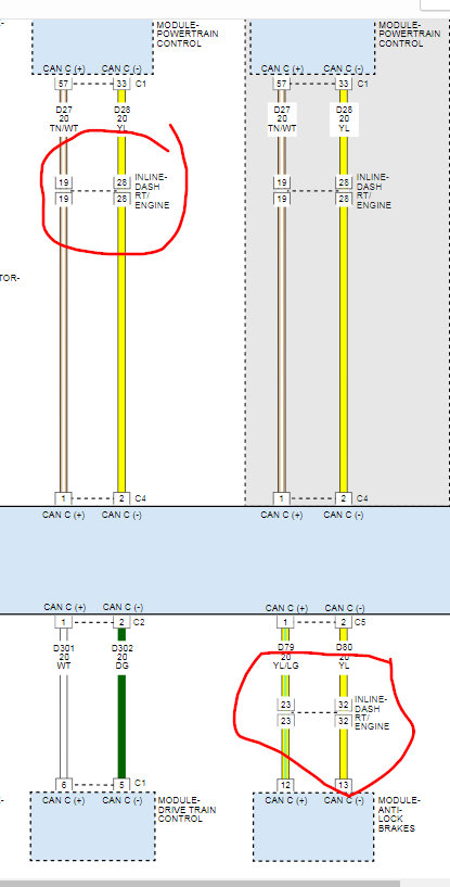

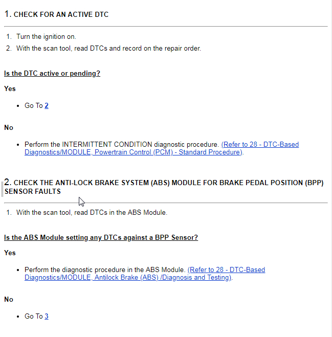

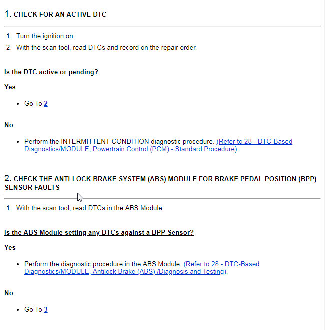

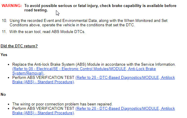

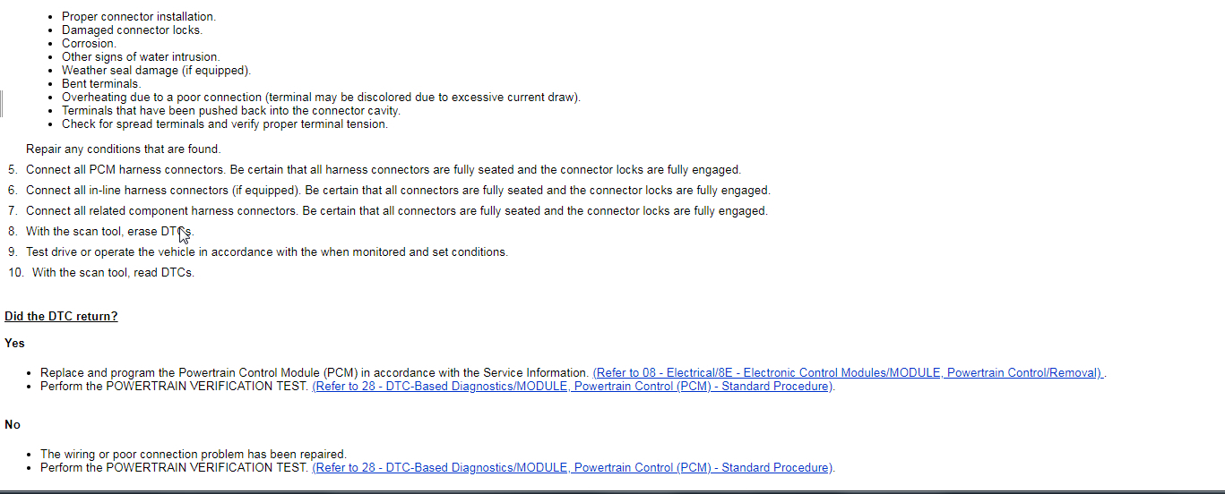

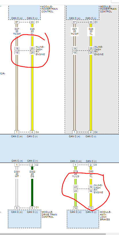

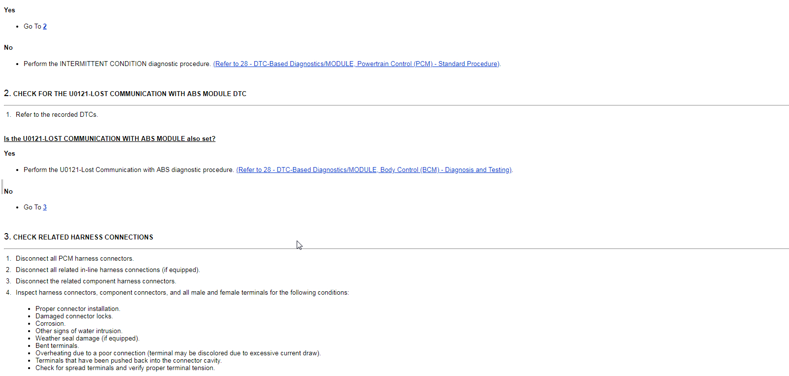

I would start with trying to find the U1120 code. I attached the testing for this code. You will need to go through the connections between the ABS and PCM on the BUS network. I included the wiring diagram and location of these connectors.

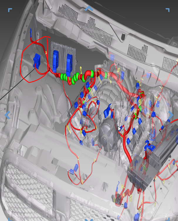

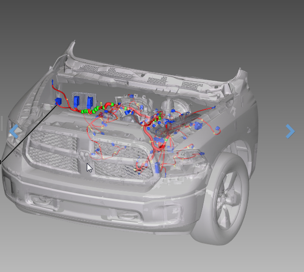

However, before you get to far, you will want to go the inline connector that I circled. It is on the passenger side wheel well close to the PCM. I have seen quite a few of these have water intrusion causing these types of issues. You may have to look close but you will see some of the terminals green with water intrusion. All of these codes go through this connector so I suspect this is your issue. If you find an issue, you can go to a dealer and they can order connectors for you so you don't need to replace the entire harnesses. You just need to tell them you need the connector kits for the I230 connector. The part numbers should be 68080570AA and 68080569AA but just have them double check that to be sure.
Let me know what you find and we can go from there. Thanks
