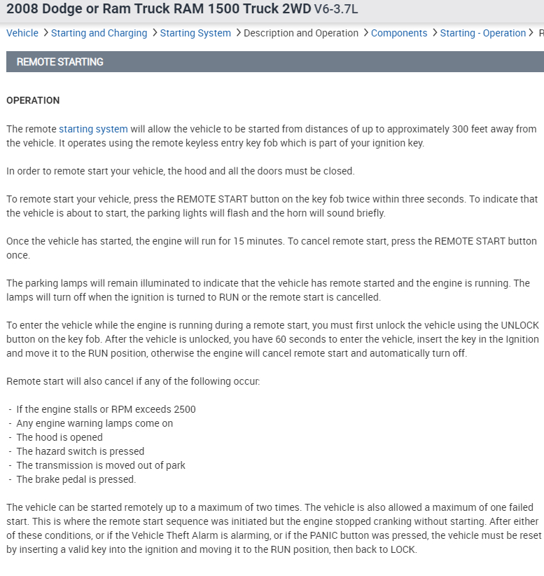

Can you give me a reason the remote start is not working?
Oct 24, 2010 at 1:19 AM
SQM
  • 6,383 POSTS

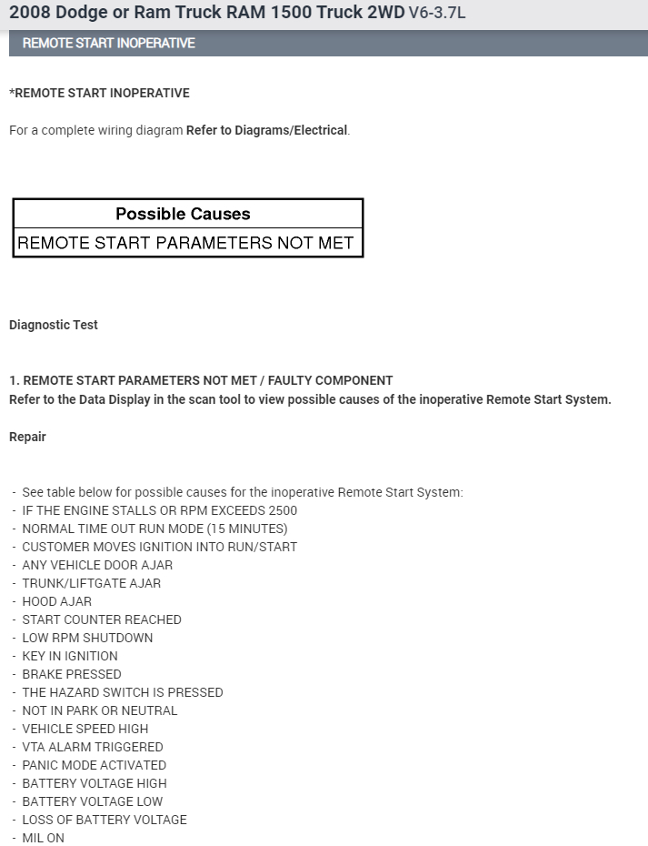

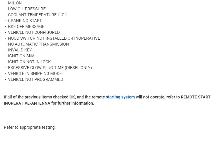

There could be a number of reasons why it is not working. First of all, it could be due to a bad battery on the fob. So, checking the battery should be the first step. This can also be due to a bad module or faulty wiring.
It could also mean that the fob needs to be programmed to the vehicle.
https://www.2carpros.com/articles/how-to-re-program-a-key-remote-fob
I have attached some helpful information and what are the typical culprits for inoperative remote start below.
