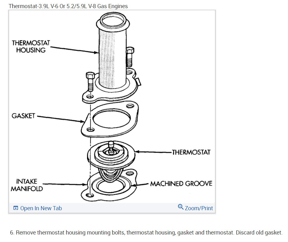

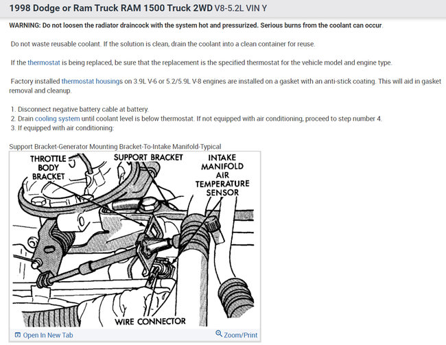

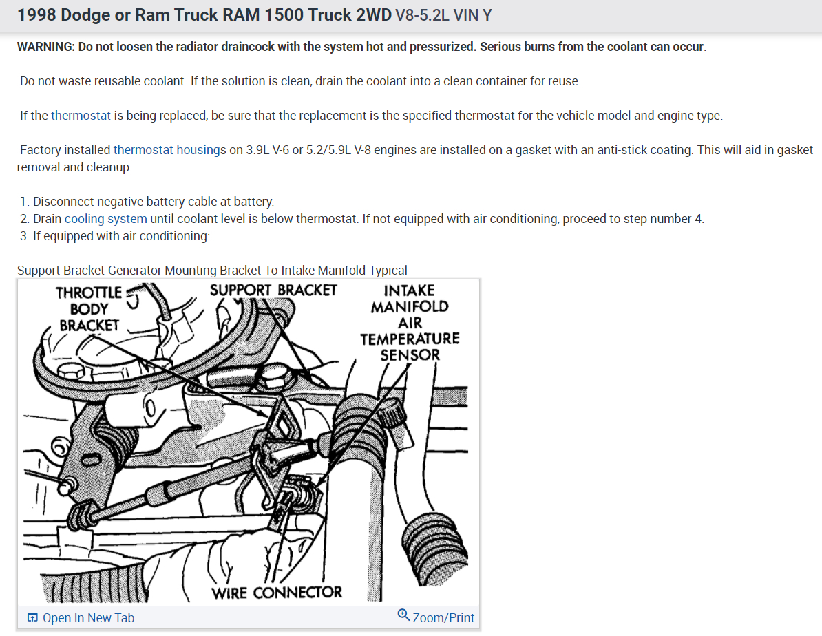

Where is the thermostat located on this truck?
Wednesday, December 3rd, 2008 AT 2:02 PM
KEN L
MASTER CERTIFIED MECHANIC
48,363 POSTS
Here is a guide to help you step by step with instructions in the diagrams below to show you how on your car:
