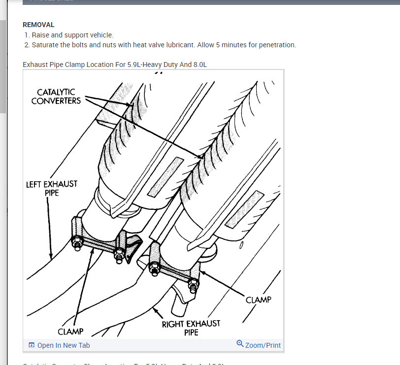

Whenever I start up my truck, there is a rattling sound. It also makes that same sound when I apply the gas. I have heard it might be the heat shield, around the catalytic converter, might be loose. So do you have ideas or recommendations on what is making this annoying rattling sound.
Sep 6, 2010 at 12:11 PM

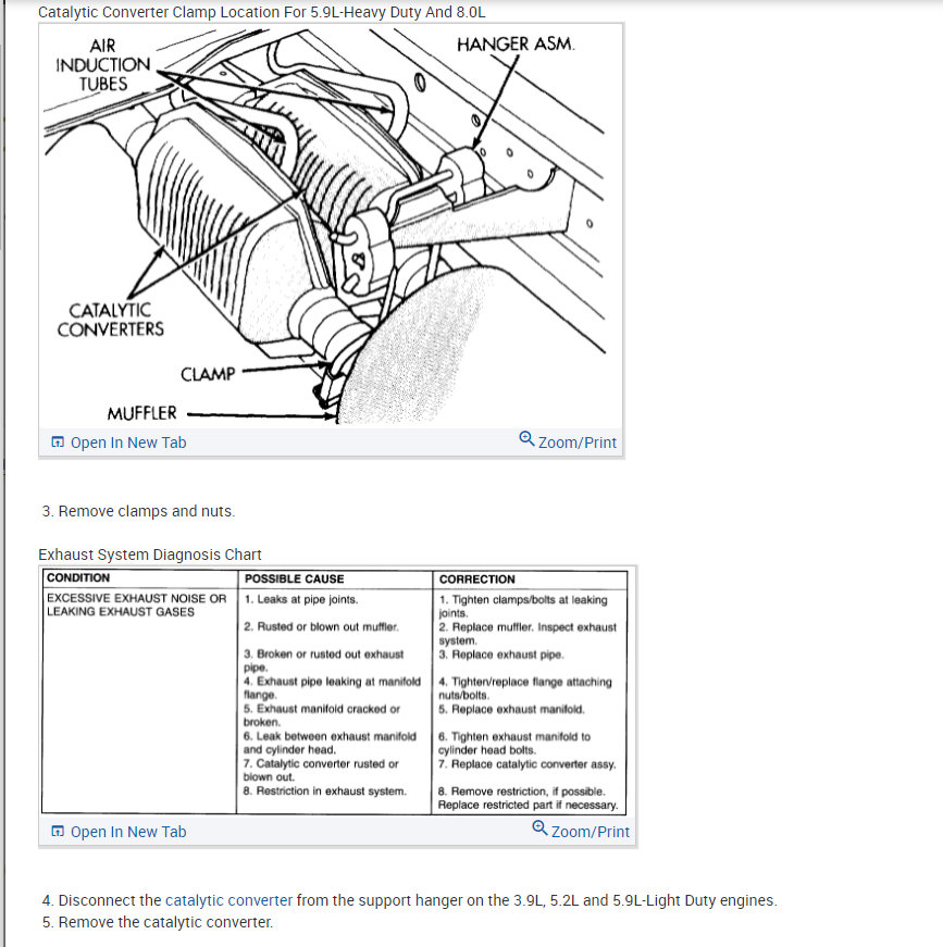

You are on the right path. This is most likely an exhaust issue. It could be a heat shield or even the converter coming apart so we need to test this a couple ways.
https://www.2carpros.com/articles/rattle-noise
First the easiest is to take a rubber hammer and tap the exhaust all the way up and down to try and find anything loose.
Next we need to test the converter. Here is a guide that will help with this:

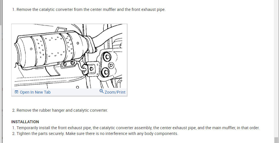

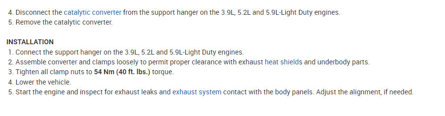

I suspect this is a converter issue so I attached the process below from the manual on how to replace the converter. Please let us know if you have questions on this. Thanks
