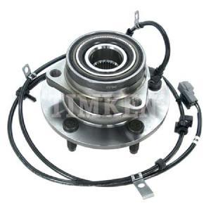

Your truck has a hub bearing assembly, if not properly torqued the bearings WILL fail. Torque the hub axle nut to 160-200 FT-LBS.

This is the part with 4 wheel abs.
