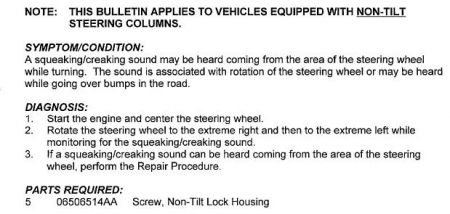

Why does my truck make a bad squeeking noise when I hit little or big bumps driving slow and when I steer

Hello, the above info is part of a service bulletin--190400, You'll have to decide if the bulletin fits your problem?
