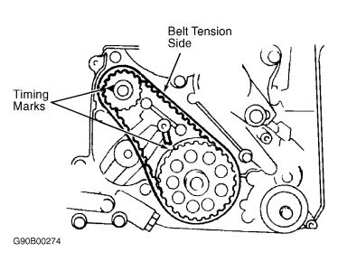

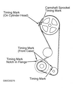

Upon changing the timing belt I have lined up the marks on cam,crank,and oil pump pully to the correct spots... now when I attempt to start engine will fire but not enough to run.. changing belt was maintenance not failure... engine is 2.4l I'm missing something but can't seem to get it.... thanks

Was rear belt replaced? Was engine rotated by hand to see if marks came back in time?
https://images.2carpros.com/forum/automotive_pictures/198357_Graphic_603.jpg
https://images.2carpros.com/forum/automotive_pictures/198357_Grafic_3_149.jpg

No the rear belt was not changed... yes I did spin crank pully a few time and the marks line up every two rotations... I will fire now everytime but not enough to to keep going.... just pulled intake to check injectors.. they all metered to proper resistance..... like I said will fire but stumbles before stalling out... thanks..

Have you tried turning DIST a bit ?
